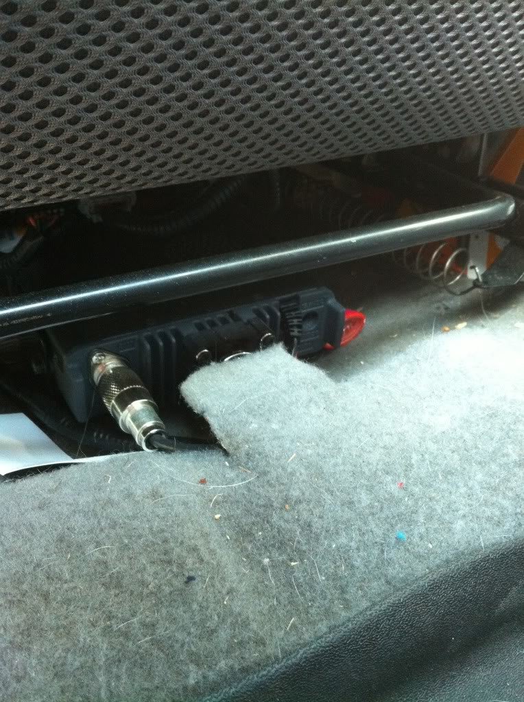

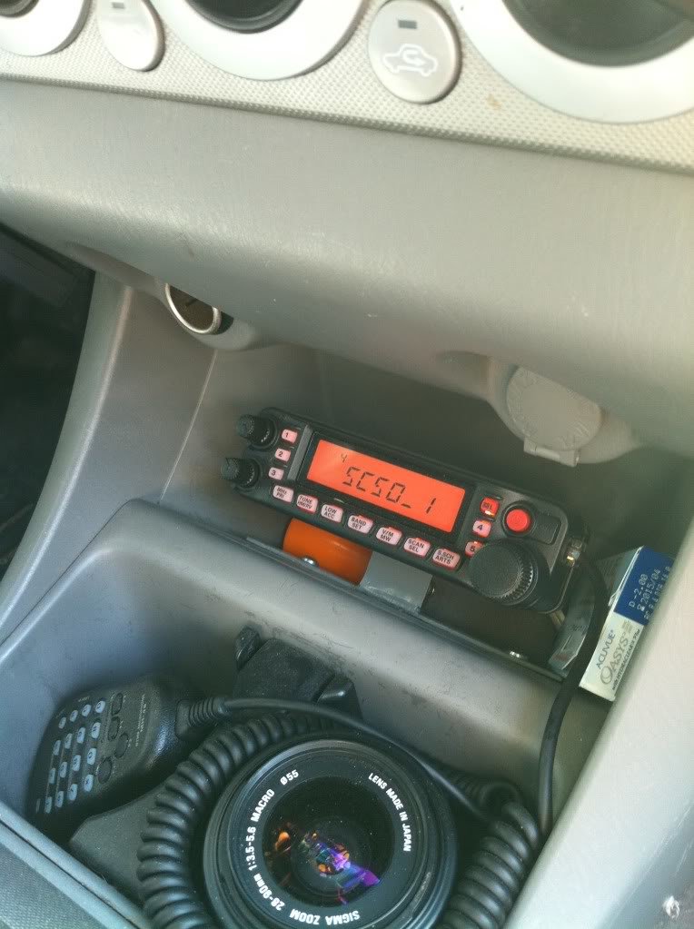

    Here is mine. Its a Yaesu 7900R. I have yet to add an external speaker.
    Main unit under the passenger seat

    Thanks guys! That is about where I was thinking of putting the head, it just sucks that I lose the cubby space! I heard some guy talk about a clip that connected the speaker to the back of the seat but he never could show me or describe how exactly.

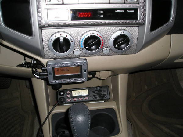

    There is no need to drill holes. There isn't much that can't be mounted in the cab using 3m double sided mounting tape. Clean the plastic beforehand with some alcohol to ensure the tape sticks.
    All mounted with double sided tape...
