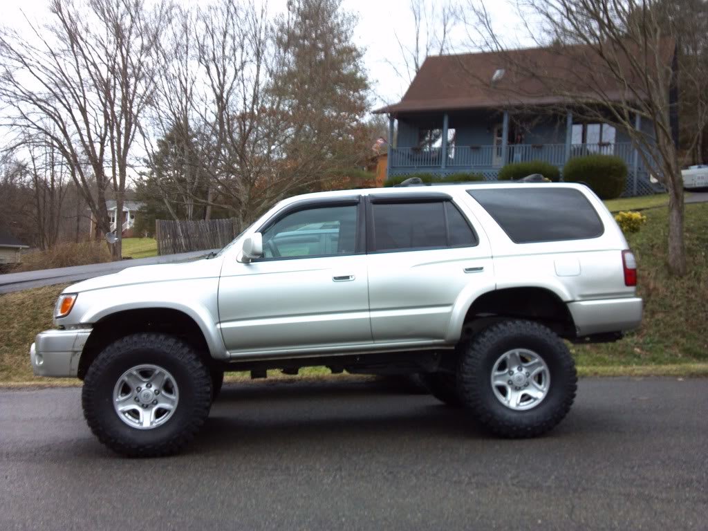

    Well got the lift and tires on finally. :D
    She's sitting a little high in the rear right now, but these springs are so soft it should settle down pretty close to even with a little time and the added weight of the bumper, swingarm, and spare.

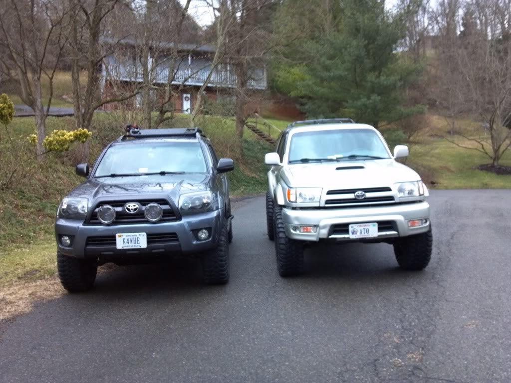

    And a quick shot of the 2 ATO FoRunners.... :D

    Talk about rake, what leaf springs are they?

    I spy body lift.

    00 4Runner
    Front springs from an LX450. They are really soft and will settle alot when I weigh the back down with a bumper, swingarm, spare and tools. Heck it sits down 3/4" just by me climbing in the back.

    00 4Runner
    1" Saved me from having to tub the firewall. I'll be doing a 1" drivetrain lift in the future.
    For reference Dave's 4th gen has a 3" lift and 285's on it and as you can see in the pic I'm a little bit taller.
