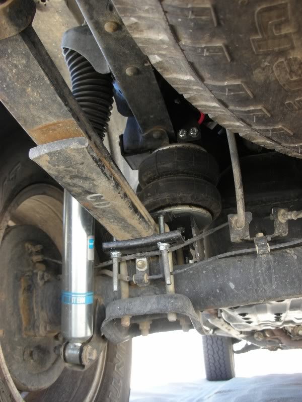

    I installed a set on my new 2011 Tacoma this morning. Took me about 4 hours. Drivers side took three times as long due to gas tank and spare is over that way. I would recommend dropping the spare....I should have. Passenger side was a breeze. Routing the air lines is simple and took advice above and just put the air stems in the 7 pin connector bracket. Good location and out of the way. Be sure to have a way to tighten the big 1 1/16th ( I belive that is the size) Bolts to the frame. Luckily I had two sets of sockets this size. I am running them at 18lbs for a couple days just to see if they hold pressure then probably drop them to 10lbs. I took it on a ride and seems to help with high speed cornering. Just got this truck and towed my 4000lb camper home to clean it up and winterize it. Bottomed out on some rough gravel roads. Should be taking it back in a few days to storage and will report back how she rides with air bags installed now. I sprayed the soapy water on the air connections and did find a leak. I recommend following instructions and checking.

    That bracket is the first thing to get smashed when you go four wheeling... Happened on my '05, so I removed the light cable plug and zip tied it up and out of the way (I don't tow), on my '10.

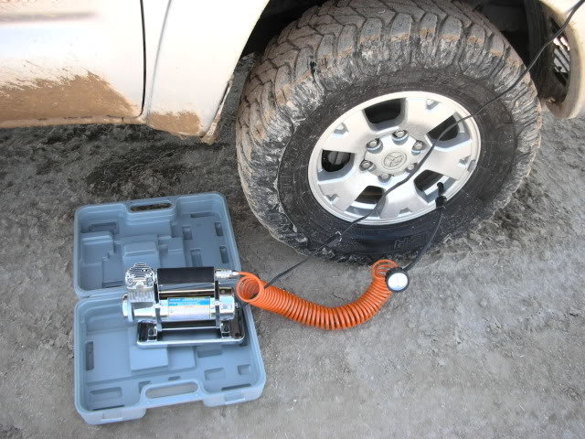

    THIS:
    OR THIS:
    which of course are my tire pumps for sand driving or tire refills (after plugging holes in the BFG Rugged Fails)... The air bags need very LITTLE volume of air to add... You could just keep them at 25 psi and be good for all conditions including loads.
