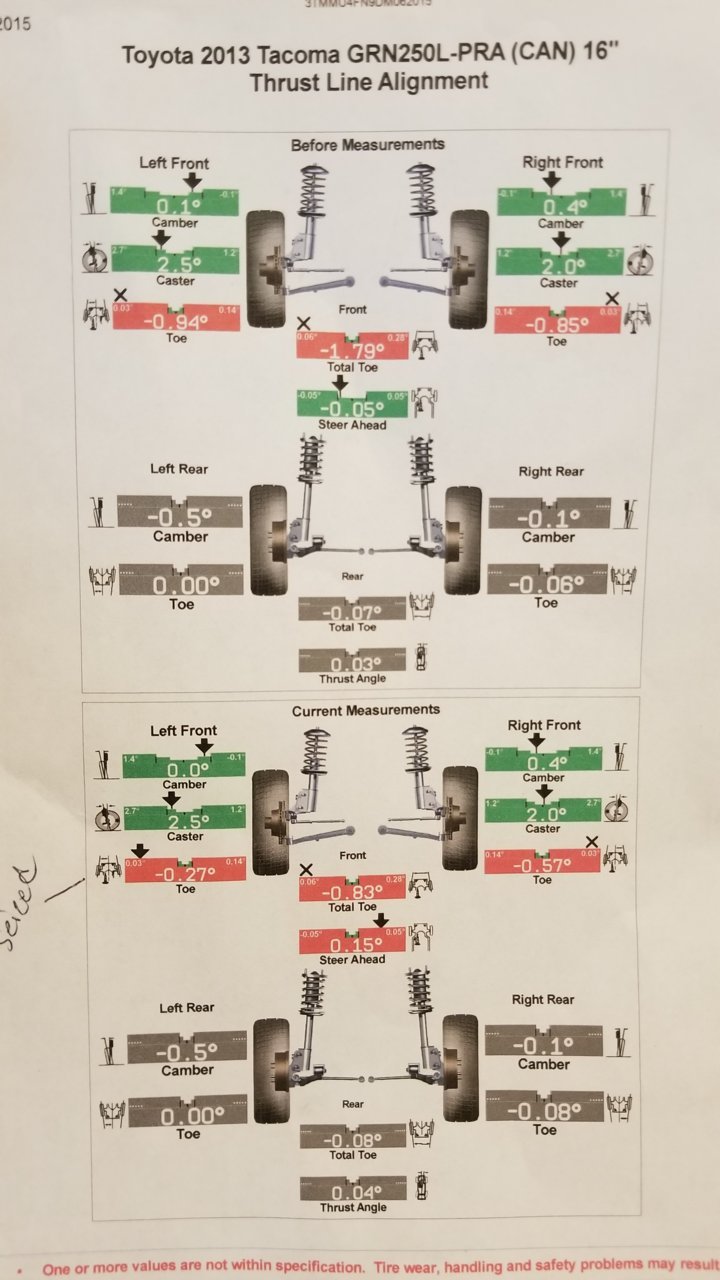

    This is just my recent experience at Firestone for alignment and a picture of my legit alignment sheet...
    My specs are all kinds of crazy and hardly changed at all to be in alignment, and someone wrote siezed on my toe adjustment. I asked the tech who just said "yeah maybe you need some new tie rods" and continued to act as though business was finished and I should leave.
    I can get heated but it wasnt worth it and I could tell the guy was having a bad day, so i drove home less than 1 mile away and called Firestone back. The Tech answered and I said man you told me this was siezed but you moved it a full degree almost, what do I need to do to get this right, my truck should be the easiest thing to align in this place. He put me on hold for 5 min and came back on and said sir I am sorry the head alignment tech will be working tomorrow and can take a look. So a wasted trip and I get to return at 8am tomorrow. Thanks for listening to my story. I'll keep all you avid listeners updated tomorrow.

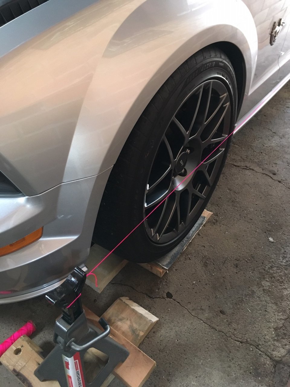

    285/75/16

    It may be seized. Toe moves with camber and caster adjustment, that's why toe adjustment is the last thing to do after camber and caster are dialed in.

    I bet Toyota is better as well, the deal at Firestone is their lifetime alignment, so this was free (kinda). This exact location is where I purchased it after my first set of extended coilovers, ill most likely give Duggys Garage a shot if they fail tomorrow, at least I know they do it on a regular basis with both Toyotas and aftermarket UCAs.
    That makes sense, and I honestly don't know maybe it is siezed, however my caster camber specs didnt get changed, ball joints still in same spot...The only number that did change is the toe, which is why that threw a red flag in my head, just didnt make sense how it moved but its siezed.

    Master mechanic speaking here,
    He got a lot moved for it being "siezed"
    Proper tools do a lot. I keep a butane torch handy for just such reasons.

    I've had a few bad experiences with chain-store alignments in the past, so I decided to give it a shot on my Mustang. This was just after I had lowered the car and added a staggered wheel and tire setup, so it really needed to be tweaked.
    After installing some cam alignment bolts in the spindle to correct the camber, I used the string method to dial in the toe. It took several hours (actually an entire afternoon and evening) and I must have taken 100 measurements while constantly double-checking that nothing had been bumped or moved.
    Two linoleum tiles with wheel bearing grease between them were placed under the front tires. This allowed me to adjust the tie rods while the suspension was loaded. :laughing:
    The result? The car tracks down the road straight and tire wear is normal. I think it's just one of those things that seems very daunting the first time, then you gradually get better at it.
