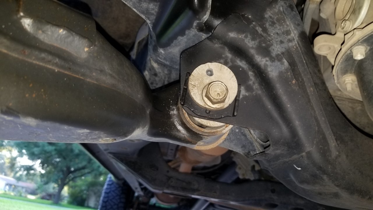

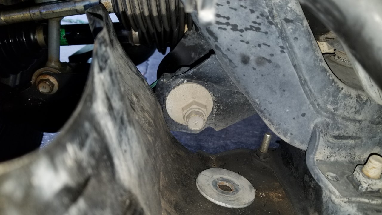

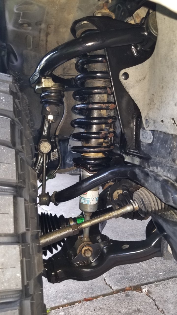

    Driver Front Cam
    Driver Rear
    Passenger Front - And an old UCA Washer lol
    Passenger Rear

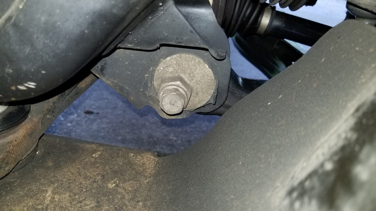

    Just a photo to show my setup, and what id consider decently clean components. Tie bar isnt a rust bucket or anything...

    That looks pretty cherry actually. If you're ever up in the DFW area, I'll align it for ya.

    Yeah caster and camber is not too bad I guess...the toe'd out thing that's visable, probably in better light, is what has me jaded.

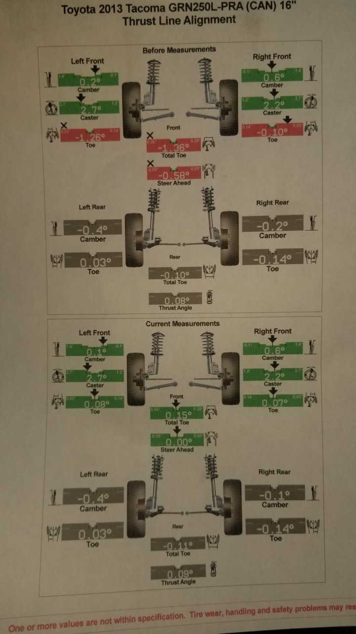

    I know this isn't a thread about UCAs, but here are my Spec's after the Camburg UCAs and Bilstein 6112s.
    As you can see my caster is high for being lifted. A higher caster helps track straight down the road. The half degree split compensates for road crown. I did you back in and move camber back out to the positive 1.0 on both sides. Drives a bit better.

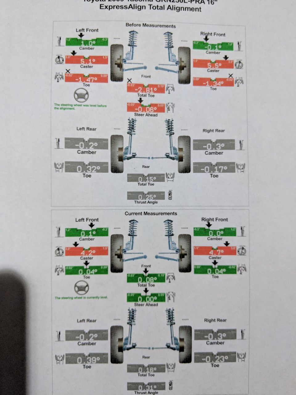

    Well same tech actually worked on it with another I didnt see yeaterday. He mentioned it was siezed again but would give it a try, and the disgruntled front office dude was gone and everyone was friendly for the most part. I also told him if he would please try again, because he seemed reluctant, so I also mentioned i'd buy him a 6 pack....Well im happy to say im at least all in the green and I happily bought the homie a 6 pack of Modelo....And I was out of there in 20 min, like it was nothing!
    How do yall think these numbers look?

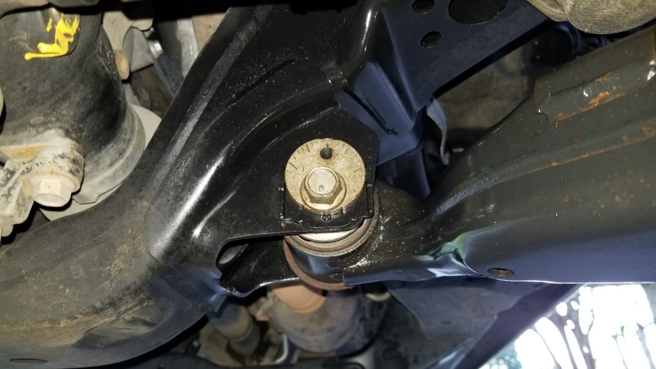

    It can be a thread about whatever helps us get better results from Firestone! I read a lot on the high caster setting on TW before I went in the first time. I feel comfortable I can get additional caster adjustment by flipping the rectangular washer a different way on the SPC balljoint. Might try to give that a shot today.

    It may be that they rolled the threads on the jam nut last time alignment was done. I've seen that a few times.

    After looking at the pics of the cams, you posted, there's a ton of room for improvement on those shity alignment numbers you have. By the numbers you have, the truck must pull to the right.
    I hate to tell you, but you wasted good beer on a lazy tech.

    Yup, it's pulling right after driving it around this morning, thinking ill try the DIY method or give Duggys Garage a shot. Sucks but im down to learn something new too.
