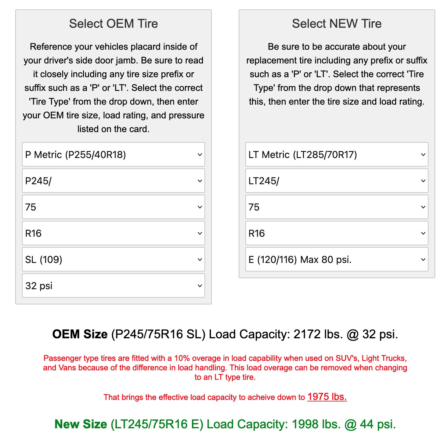

    When I got the tires, Costco said the appropriate pressure when moving from an SL to a LT/E was 45, which jives with what I calculated below.
    However, they ride super firm at that pressure and the rear end gets squirrely in the rain. They feel best to me around 36-37... not too harsh-riding, but the handling is tight (like good steering response and they don't roll over and squeal if you go a little hot into a turn by accident).Screenshot 2024-03-21 at 7.10.56 PM.png
