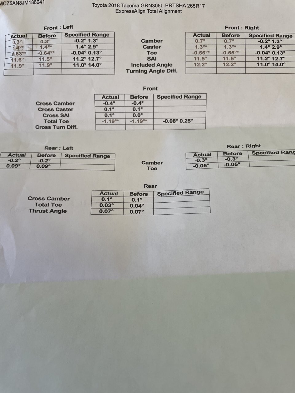

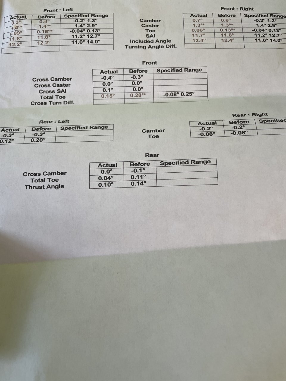

    I wish they give me the print out like your print out.
    It’s little bit out alignment, so I did lifetime alignment for 180. Manager did give me small discounts.

    Your print out is easier to read than the screen prints. It isn't color but for someone that is just looking at number, it makes more sense. What is with the second printout? Toe looks crazy. The first one looks like they gave you a toe set. Not exactly $180 worth of labor on that.
