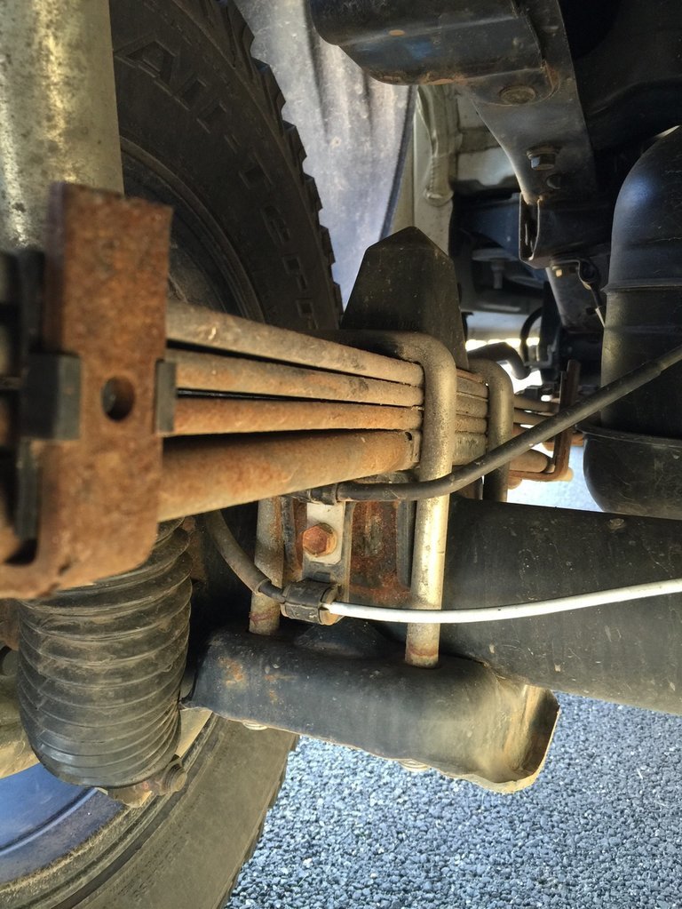

    FedEx just delivered me a little present a little bit ago!!! BTW guys SD truck Springs said that this kit don't come with the inflation valve mounting kit but it actually does, it was in my box!! I'll post some pics!

    Looks like you got "double" heat shields also....got mine bolted on before I realized there were 2 stuck together....the dowel pin on the bag still seats in the retaining hole so I left it doubled up. My Cradles just came in today so it will all go on this Sunday. Seems some things don't change...when I put these on my Tundra the bolt head stuck up higher than the cradle if you put a washer on it....still that way many years later with the new Cradles so I ground down the bolt head until it was below the dish in the Cradle.....bolt simply holds the Cradle to the bracket so grinding a little off the head doesn't seem to hurt things (been that way on my Tundra for quite a few years)...so now the bag hits the cradle rather than the bolt head...didn't want to leave the washer out and didn't have any real thin washers that would work. (Mine shipped with the valve mounting kit also...pretty slick idea for a simple plastic part).

    Yep i got 2 heat shields lol, realized that when i went to put them on. Also i got another question i put on my cradles and i got and the bolt sticks up a little past the base and the airbag sits on the bolt instead of the cradle. The bolt sticks about 1/4" high so its not to bad? Is that ok or should you fix it somehow?

    I had the same issue with the new ones and the ones on my Tundra. As the bolt is simply holding the cradle on I took the head down a bit with my bench belt sander. They clear if you eliminate the washer (but I wanted to retain the washer), or may work if you could find a real thin washer to use. I ground down the bolts on my Tundra and they have been OK for quite a few years so went that route with the set for the Taco. Don't know that the bolt being raised would hurt anything as it is metal on metal, but might be noisier. Ended up removing about 1/4 of the thickness from the bolt head.

    That's exactly what i did the other day Bob! Thanks for the advice!
