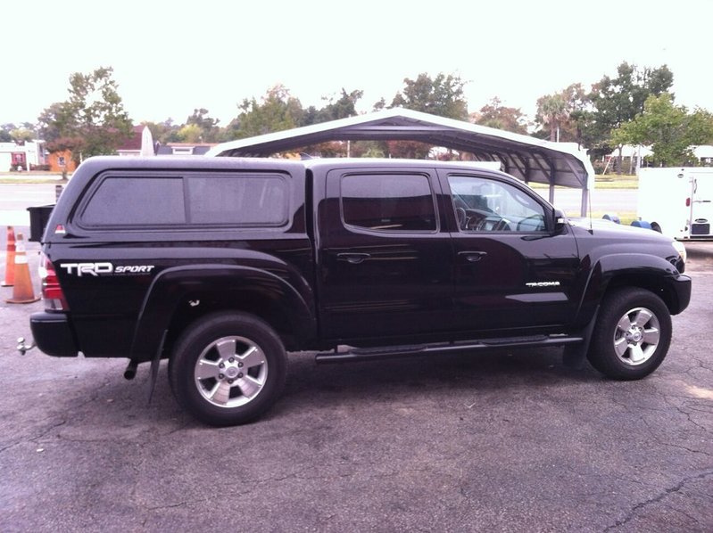

    Finally got my Firestone Air Bags and Daystar cradles installed. Installation was pretty straight forward. With the camper shell on the truck im running around 12psi. Im guessing Ill be running 20-25psi when I tow the travel trailer (3300 lbs dry).
  11. Aug 8, 2015 at 1:35 PM
    #111
    rainmakr
    rainmakr Well-Known Member
    Dec 23, 2013
    #119084
    133
    Virginia
    2014 TRD Sport
    I used a tee valve so that Id only have one fill point. Instead of drilling a hole in my bumper I used one of the holes that were already there.
    Install with daystar cradle passenger side
    Bags with 12psi
