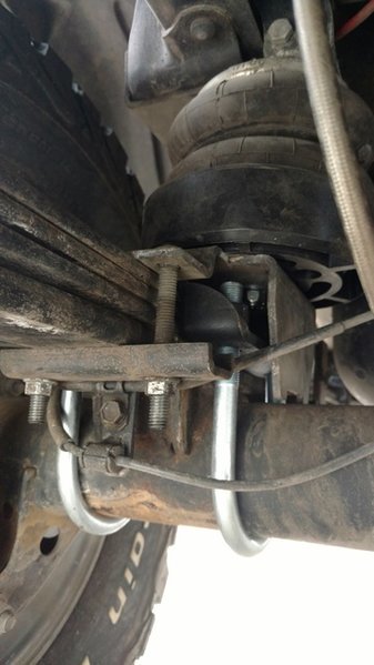

    Is anyone using these bags with a U-bolt flip? What did you do to make them work?

    This is the style of bracket that works for the flip with bags - but I forget who makes them - need some one to chime in here.............
    That inner side vertical leg needs to go down and rest on the axle when its installed - otherwise there is an offset load on the spring base.

    Nice. That's what I'm looking for. I do have a 3 leaf AAL so, it looks like I'll have to get a CAD package to my structural shop.

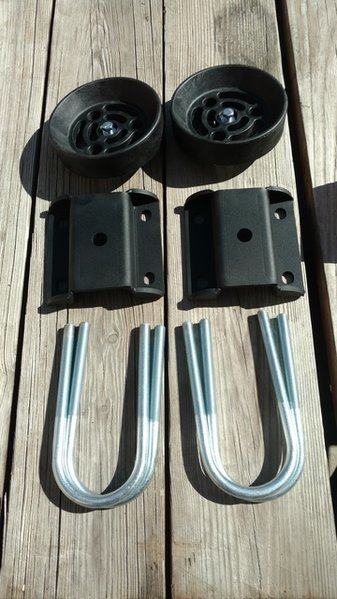

    Here's a better view of the parts -

    Found the reference - those brackets came from "Total Chaos"........... ad says earlier model of truck - but 2.5 width spring. Call 'em.

    I like it. Time to see if they keep them in stock. Thanks
