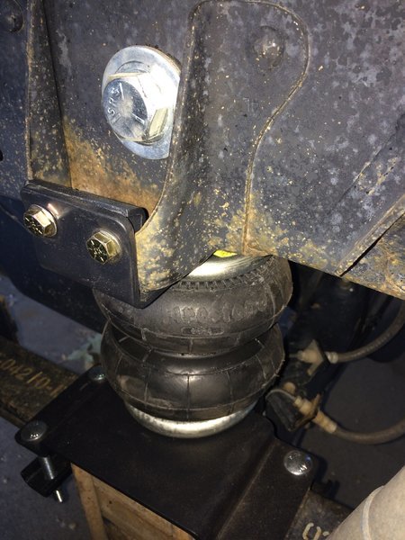

    How is the rear of your truck lifted? If using add a leaf or block you will need something like this so the lower bracket rest on your axle.
    https://www.amazon.com/gp/aw/d/B0052XZ9OM/ref=yo_ii_img?ie=UTF8&psc=1
    It will bend otherwise. The cradles are great for keeping your suspension travel but are not necessary. If you do any offroading you will want them, the bags really limit your travel. There are also airbag spacers but I'd go with the daystar cradles instead. Here's my setup.

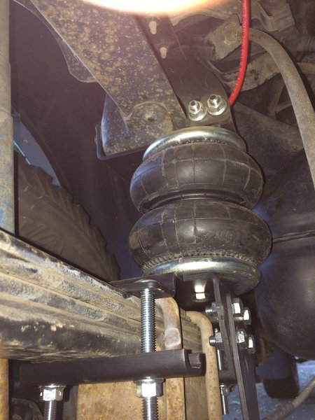

    Just an update after I had got the parts and had the install done. I ordered the Ride Rite 2407 bags and the 2506 kit because my truck has a 2" block lift. The 2506 kit got the job done perfectly. This truck is now ready to pull my new travel trailer!
