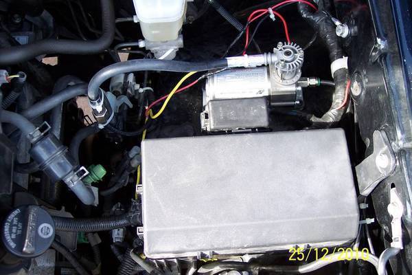

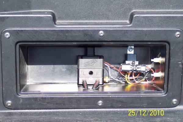

    Lea, I have the Air Lift wireless system. I mounted the modulator valve in the drivers side bed compartment, and ran the wires and air hose along the frame to the compressor mounted on the drivers side fender behind the fuse box. I had to lengthen some of the wires to reach the front. As you can see, I ran out of wire loom and haven't quite finished. The modulator valve separates the left and right hoses to each air bag. You shouldn't use only one air tube or the air will go to the side of least resistance when the truck leans. Does this make sense, because I'm confused. j/k.

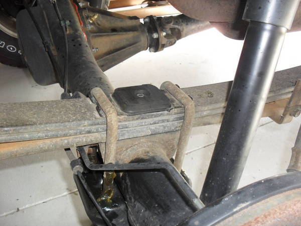

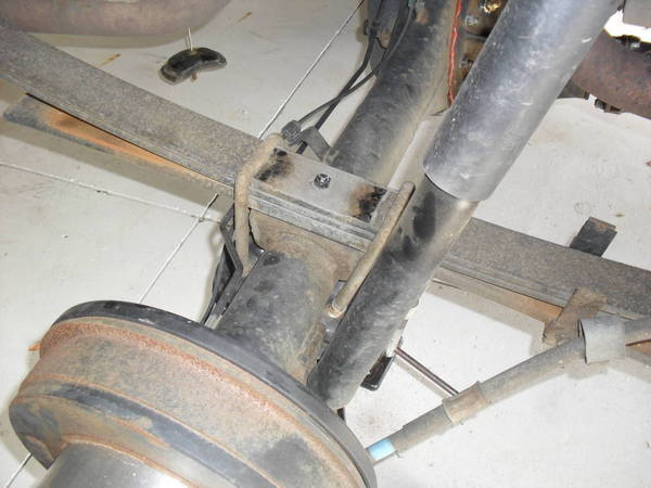

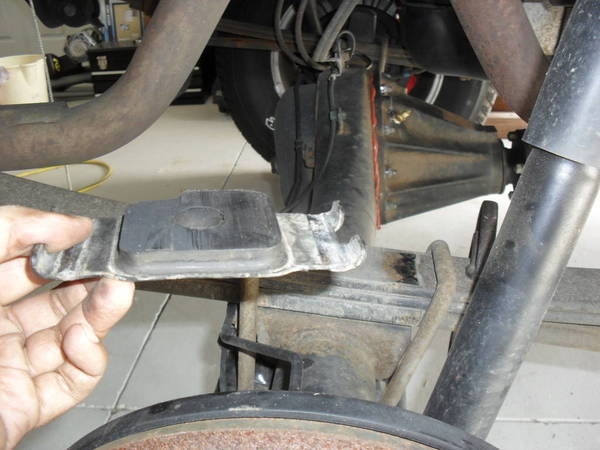

    Sam i02, could you clarify what you mean here?
    "I just picked up a set of used bump stops on here for $15 (people who have changed leaf packs have them sitting around), cut them on a band saw and swapped out for the factory ones when i was doing the install. It was very starightforward.
    I thought of getting the second set of bumpstops, so i can take my truck back to stock when i sell it; further into the project i realized that it actually made the install easier."
    -Did you install the bump stops that you pre-cut on the band saw?
    -If so, can you just loosen the big u-bolts that attach the axle to the leafs, and wiggle out the bump stops? (it seems it might mess with alignment, but I am not sure)
    -What "actually made the install easier"?
    Thanks for the great how-to and discussion.

    brp - yep, you got it. I believe i also took some pics during the install. I can dig them up it you think it may help you.
    - yes i simply removed the old bumpstops by losening the 2 U-bolts that hold the leaf pack and axle housing together. The stock bumps wiggle out once you have about 1/2" of clearance. Couple precautions I took were: I took a big a$$ C-clamp and clamped the leaf pack together (not the axel, just the leaf pack), so it did not come apart when i took the U-bolts out. I did one side at a time and had the axel housing supported by a floor jack, on the side i was working on. It was very easy to do. Just spray the U-bolt nuts with penetrating oil beforehand and let them soak for a little while.
    - i think not having to cut the stock bumps on the truck saved me lots of time and effort. I did these in a freinds driveway as we were in an apartment back then. I took less than a minute to cut the new ones on the bandsaw and it was a nice clean cut, close to the steel plate.
    Let me know if you need further clarification.

    whatdayaknow. i had the pics on my desktop the whole time. Here they are:
    1) This one shows the stock bumps removed. Note that the C-clamp is perfectly hidden by the shock absorber! And you can only slightly see the bottle jack underneath the axel right below the leafpack.
    2) Here is the pre-cut bumpstop ready to install. In this pic you can see part of the C-clamp which i talk about. It helped keep the leafs from moving from their original position. The bottle jack at the base of the leaf pack did not let the axel move, once the U bolts were loosened.
    3) Here are the "new" bumpstops installed and tightened. A side note: I noticed some corrosion on the U-bolts where they go thru the lower bracket, so i sanded them and caked some grease on em. Hopefully that prevents mositure and crud from getting in there for a little bit..
