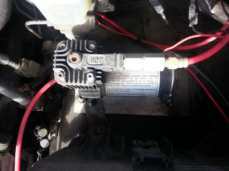

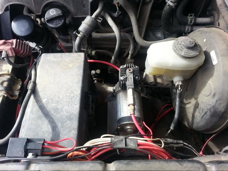

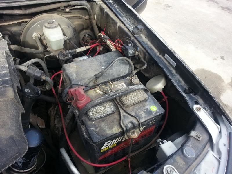

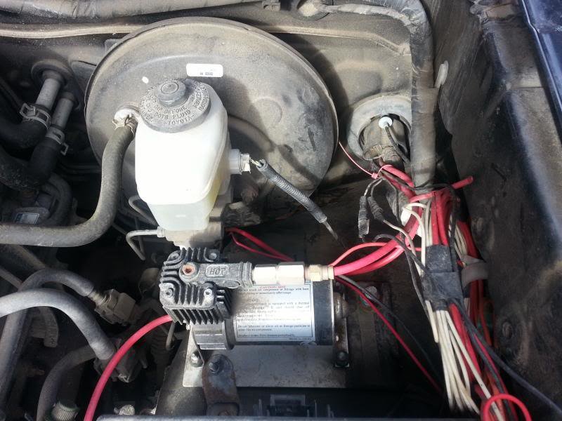

    I installed my Ride Rites something like 3 years ago and they have performed flawlessly. I meant to include some pictures of where I mounted my compressor. Handy little rig.
    Yes, my truck is filthy under the hood. I'm going to clean it this week.

    Thanks for the pics, i got a few things beside my battery in the way preventing a drivers side install, so i am going to put mine on the passenger side.
