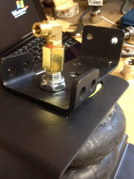

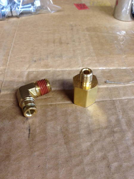

    I ended up getting my firestone ride-rite kit installed last weekend. As I said above, I ended up getting some reducers so that I could use the incorrectly sized fittings.
    Fitting on the left, reducer on the right:
    Here is the fitting and reducer screwed into the air spring. The increased height with the reducer didn't cause a clearance issue once installed. I was concerned about adding another potential for leaks with the reducer, but i didn't have any. I used thread sealant on the reducer's male threads going into the spring.

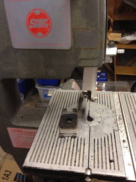

    I used the bandsaw suggestion and used my shopsmith to cut the bump stumps. I tried the hacksaw first for about 5 seconds, and thought f this, I am taking these things off. The rubber gunked up the blade pretty bad, so factor that in if you have a bandsaw. It was still worth it for me though.

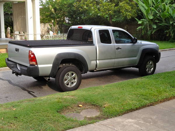

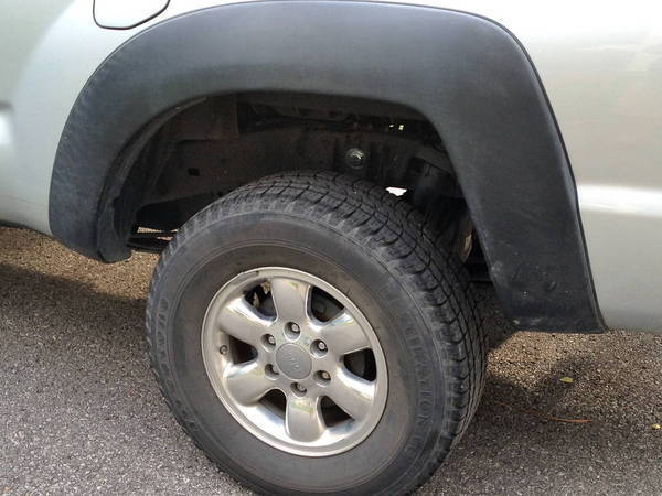

    Here are a couple pics with 15lbs unladen. I forgot to measure the height before. In the next week I will hook up my camper for some before and after pics with some weight on it.
    My tires are pretty small. 255 70(?)r16. They were on the truck when I bought it a couple years ago.
