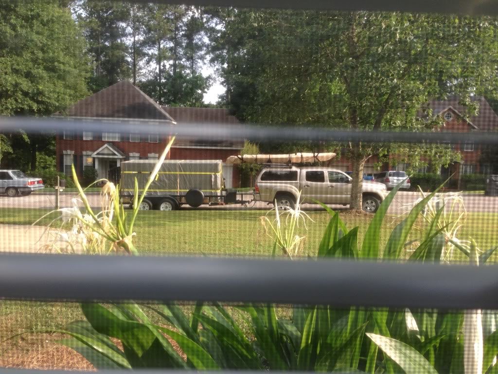

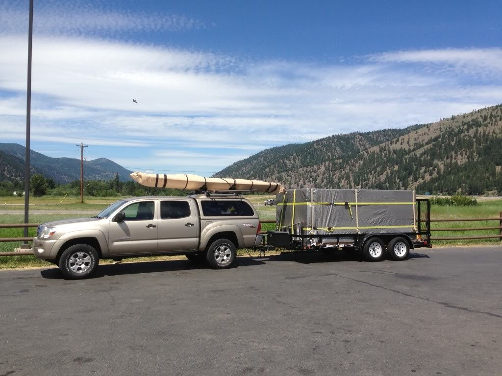

    Here are some pics from when I moved cross country. The bags did help A LOT!!!!
    BEst add on ever!
    Ready to go and get away from Disgusta!
    Part of the precious cargo...
    Level...
