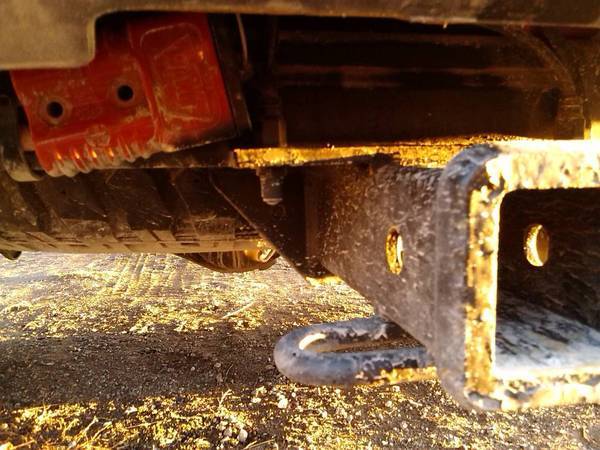

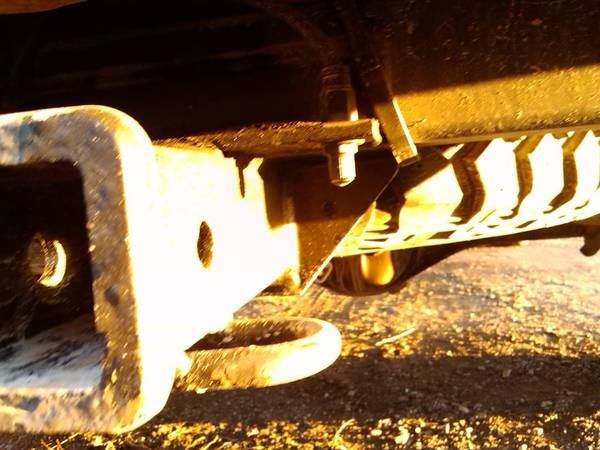

    Dan
    Northwest Montana
    2012 AC Manual 4.0 4x4 Base Model
    Access cab with child seat in the back, yellow wire mod, diff breather relocated to tail light, engine block heater, Leer topper with Yakima tracks and rack, Yakima rack on cab, Ride Rite air bags with Daystar cradles, CBI hidden front hitch, wired for winch front and rear Warn quick connect, Warn x8000i on external carrier, sway bar delete, trailer plug relocated to under bumper, Pelfreybilt IFS and Mid skids, BAMF Tcase skid, ECGS front diff bushing, ARB CKMA12 compressor, 255/85/16 Backcountry MT 3 load E tires on stock steel rims, Toyo M55 tires (same size) on another set of stock steelies, Up2NoGood heated mirror kit, Husky X-act Contour front floor liners, Northstar AGM 24F battery under the hood, Northstar 27F in the cab, Redarc 25 amp DC to DC charger, Pelfreybilt bolt on sliders with kickout and top plates, TRD Pro headlights, Depo smoked tail lights, Energy suspension body mount bushing kit, OME Dakar leaf packs with AAL, OME rear shocks, OME 90021 front shocks with 885 coils, SPC LR UCAs, Up2NoGood 2wd low range mod, 4 Wheel Campers Grandby slide in camper, 4xinnovations high clearance rear bumper, Uniclutch 800 lb/ft clutch
    I don't have pics, but mine are on either side of the hitch receiver, in the horizontal top plate of the receiver with the valves pointing downward. They are very easy to access and are well protected.
    I originally had them facing the back of the truck, coming through the vertical plate in the back of the receiver, but my spare tire was pressed against the hoses on the back of the valves. When I go to a larger tire, the spare would have pinched the hoses.

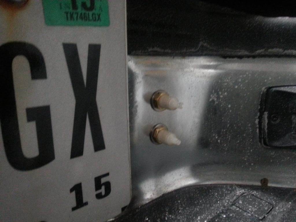

    dust999 Active Member
    Sep 7, 2010
    #42851
    25
    MA
    09 tacoma
    Hidden away under the bumper.

    You can see the holes just behind the valve stems where I originally had them located.
