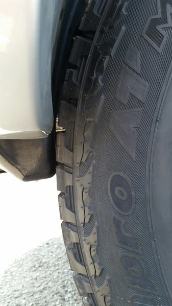

    From those pics you caster looks to be off. The 5100's at .85 will help get it to the alignment shop with less rubbing. I wonder what caster angle you are running now?

    Im not sure of my angle now, I got it back from the frame replacement (they did an alignment) a few months ago and didnt realize it was off until i put on the new rims and tires

    Before the MK6's with zero offset and 265 70 17's, I had the stock sport rims on there with 255 75 17's and nothing rubbed

    if i get a chance to put these 5100's at .85 on before friday, what caster should i ask for? The most he can get to bring the tire forward or is 2.5 sufficient?

    2.5 rides fine on mine, lifted 2-1/4"s up front.

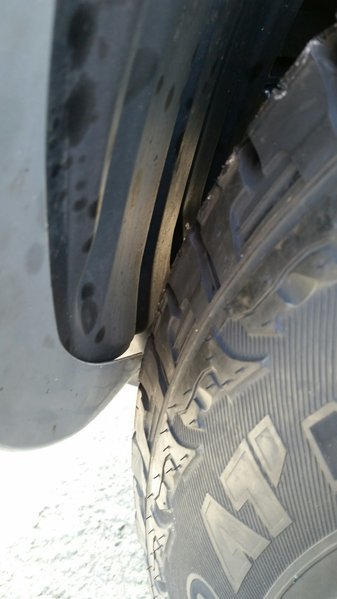

    Put the 5100's set at .85 yesterday and im very impressed with the ride and the lift height. Gave me one inch in front and it looks great. I took off my mudflaps cause of the rubbing issue but now i found another problem. I backed into my driveway yesterday and the tires rubbed on the front of the fender well now...
    There is a plastic piece that hangs lower in front of the tire that it rubs on and it also almost rubs the inner fender lip by 1/4 of an inch. This is all on flat ground and im dure it will be much worse with pressure on the suspension. Question is when i get the truck aligned and the set the camber to 2(ish) wont that make it closer to the front of the wheel well and definitely rub? Ive had all these problem with these wheels already... What should i do?
