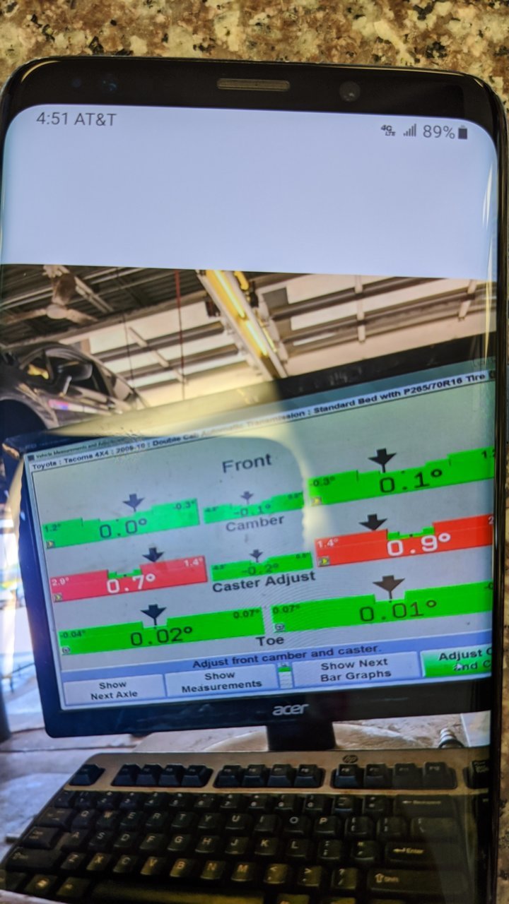

    So, they say since after they swapped tires it still pulls right it must be the rack. They say take to the stealership and if they don't find it the Firestone manager will go with and mansplain it to them.
    My question for you fine folks is, is there any way its the rack and if so, how and if not why the hell aren't there any good alignment shops in Joplin MO? (the later was rhetorical)

    Ok so what's wrong you have a pull, abnormal tire wear, what's the deal??? Do you have a print out of the alignment you can post a pic of.

    You have a sticky caliper.
    I’ll be here all week.
    edit: after seeing the “perfect” alignment sheet... I’m going to retract my statement. Take it to a different shop.

    Please tell me they didn’t leave caster there and say the alignment is perfect.

    Is that the final caster setting?

    Yup

    The red should be an indicator the alignment certainly isn’t perfect. You’re way below the low end of the range. I’d focus on that first (Maybe target 2-2.5 caster) and then reassess ...

    Imo. I doubt it’s the rack. Until you get the alignment done properly and get that caster corrected. The truck is gonna wander all over the road. Get the alignment corrected then see what happens. The higher the the caster the better. Have the alignment guy adjust caster, camber then toe in that order.
