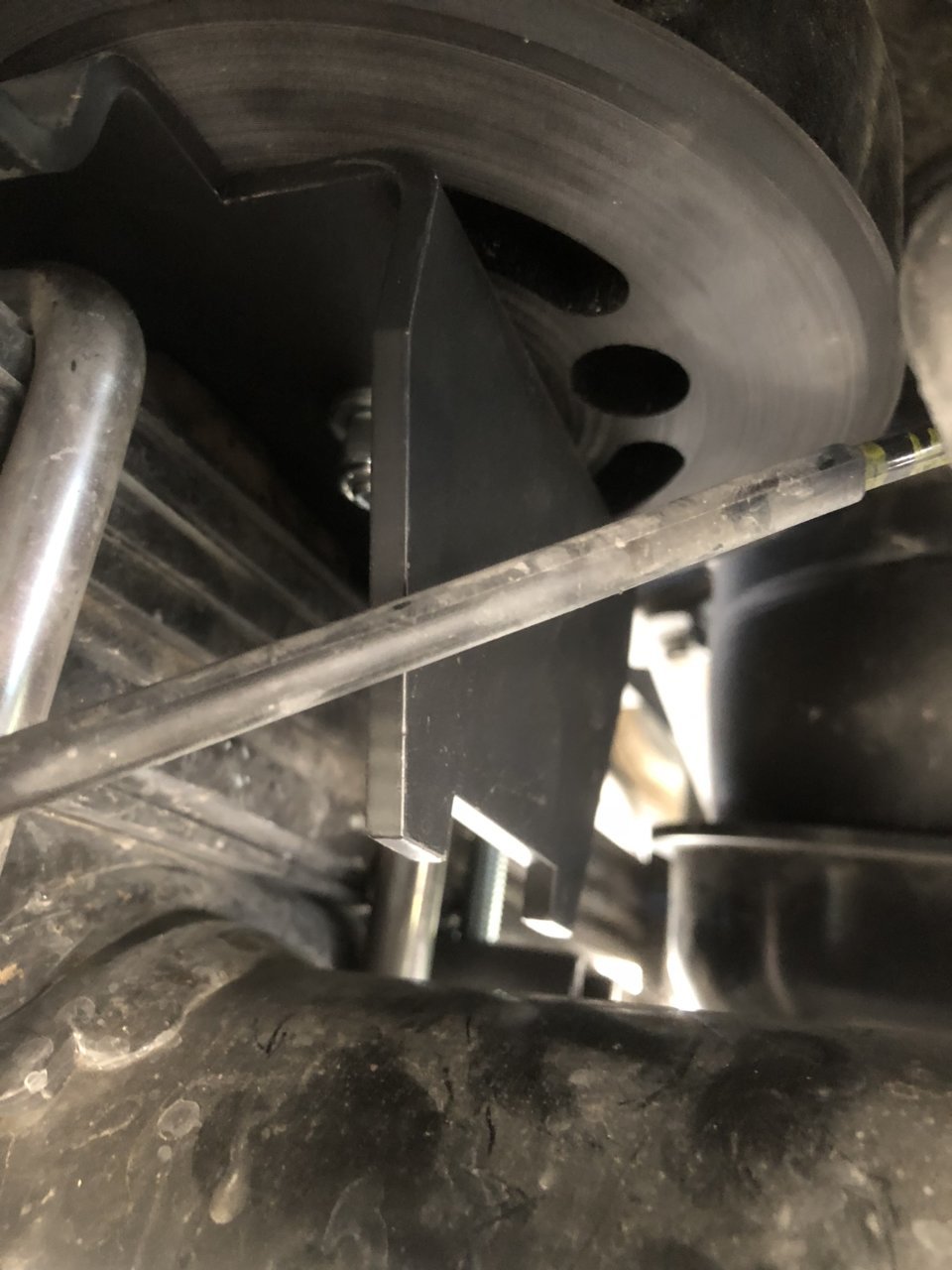

    No problem with Firestone air shocks on my 2017 OR. If you are lifted with springs, AAL or a spacer, you will have to modify the inside part of the Firestone lower mount by extending it to rest on the axle.

    Inside leg of Firestone air spring mount floats above axle if springs, AAL or spacers are used. One solution is to weld a extention piece to it. (Thats a Daystar cradle attached, but the mount is the original Firestone Ride Rite mount, and the OEM springs have 1 Dakar AAL).

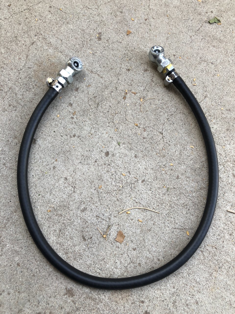

    Also, I made this to easily and quickly equalize the pressure perfectly between both sides whenever I fill or deflate them - never permanently connect your air shocks with a basic T connector thinking it will equalize pressure, because air will slosh between both sides when you go around corners and will make your rig lean a lot more to the outside of the turn = bad lean!:anonymous:
