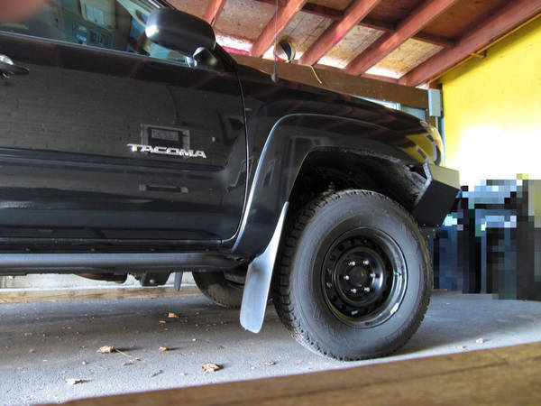

    Hey Ken, can you post some pics of the truck w/ the steelies on. I'm trying to locate 5 of them myself and love the look.

    Belly of the Beast
    4x4 TRD Off Road Full-Auto
    All-Pro Bumper, CBI Sliders, Icon Coilovers, BudBuilt Skids, aFe Intake, Icon VS Rear Shocks, Timbren Bumpstops, All-Pro UCAs, JDM Steering Wheel, ViAir Compressor, Klearz LED 3rd Brake Light, Pop-N-Lock Tailgate Handle, Husky Front Flaps
