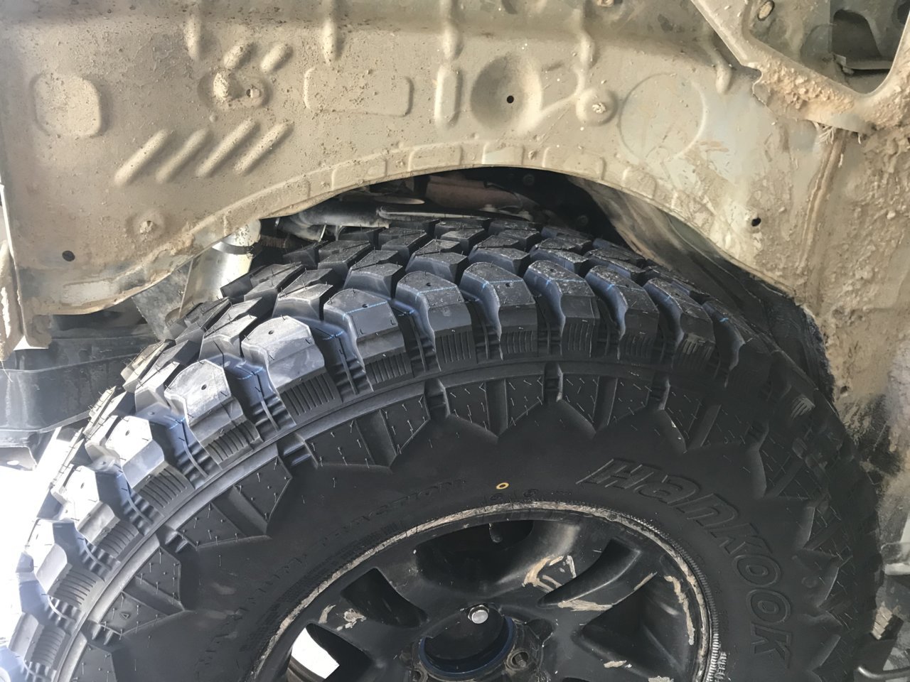

    Yep, that’s at full bump full lock. I have more to take off of the firewall but ran out of time.
    Edit: that pic may not be at full bump. But I did do that for cutting.

    Im on 7.5” wide wheels with 3.6” BS. The narrow wheel seems to lend itself to less cutting. Stock bumps. And these are 315s and measure at 34.6” diameter.

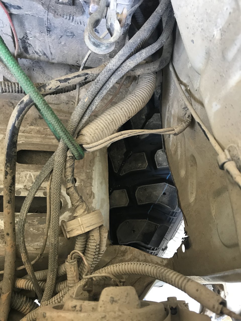

    I took the fender off on the drivers side and was able to get a good visual on uptravel now. It baffles me that you had to cut as much as you did. This pic is full bump, stock length arms and stock bumps.
    mcharfauros likes this.

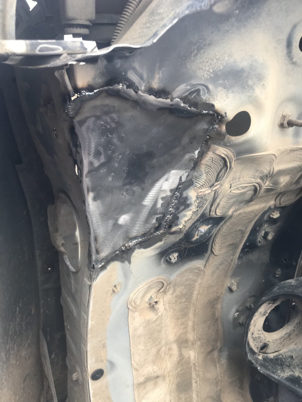

    Of course I still had to do some trimming up front.

    Something is not right. My truck would not do that. I’ll dig into it more tonight.

    No, my tire went straight into the wheel well where yours has at least of inch of space, or looks like it. I also measure my tire at 34.6” mounted and with air.

    Yeah that's odd, something is up. I had about an inch or two of space until I hit inner fender.

    Your alignment (or residual frame damage) can significantly affect where the tire rubs. Though it looks like yours is just compressing up too far. Since it looks like you have aftermarket LCAs, are you still running bumpstops?

    Figured it out. The Dirt King LCAs are NOT to be used without looking further into bump limitation.
    Installed the shock today without the spring and I'm bottoming out on the shock well before the bump makes contact with the LCA without the provided spacer. With the provided spacer the bump stop still does not contact the LCA.
