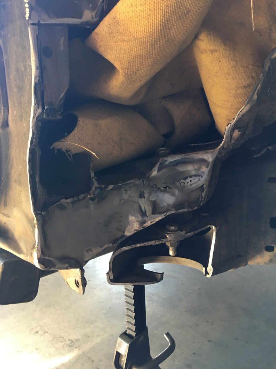

    The final amount I had to take off on the firewall.

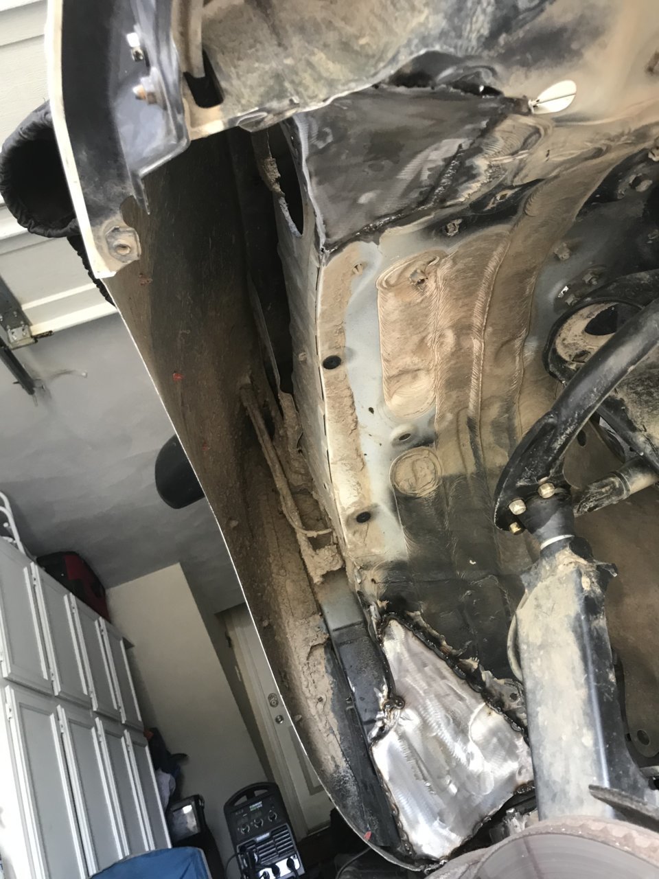

    All finished on the passenger side and was able to retain my washer fluid reservoir, barely. The bottom of it has a round rubber thing that drops into the fender but that didn’t line up, just held in by the two bolts up top.
    I highly recommend a second person. I started 5 fires in the cab and after 2 I got my wife on fire watch. There’s some sort of caulking in there from the factory that’s very flammable.

    Horrible picture, but this is where I left the truck on Saturday. Using 20 GA sheet and .025" wire with a 110 welder. Not the prettiest but not coming out too bad.
    I also got the rear wheel wells cut so the rear should be good for at least a shakedown.

    You’re a mad man with 20 gauge lol 22 was hard enough to form. Probably a little easier to weld though.

    Some people I've spoken with used 16/18 GA. When I was at the metal supply shop I looked at that range and the 20 GA remained pliable yet I wanted to go as thick as I could to make it easier to weld.
