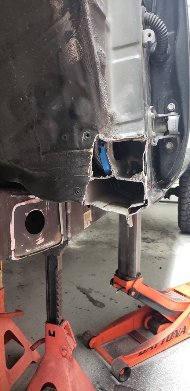

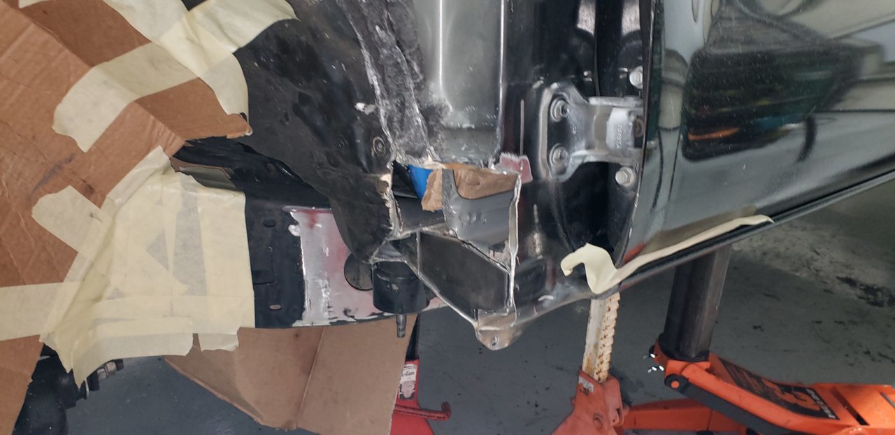

    Finally got tired of rubbing. Baby Tubbing and Cab Mount Relocate.

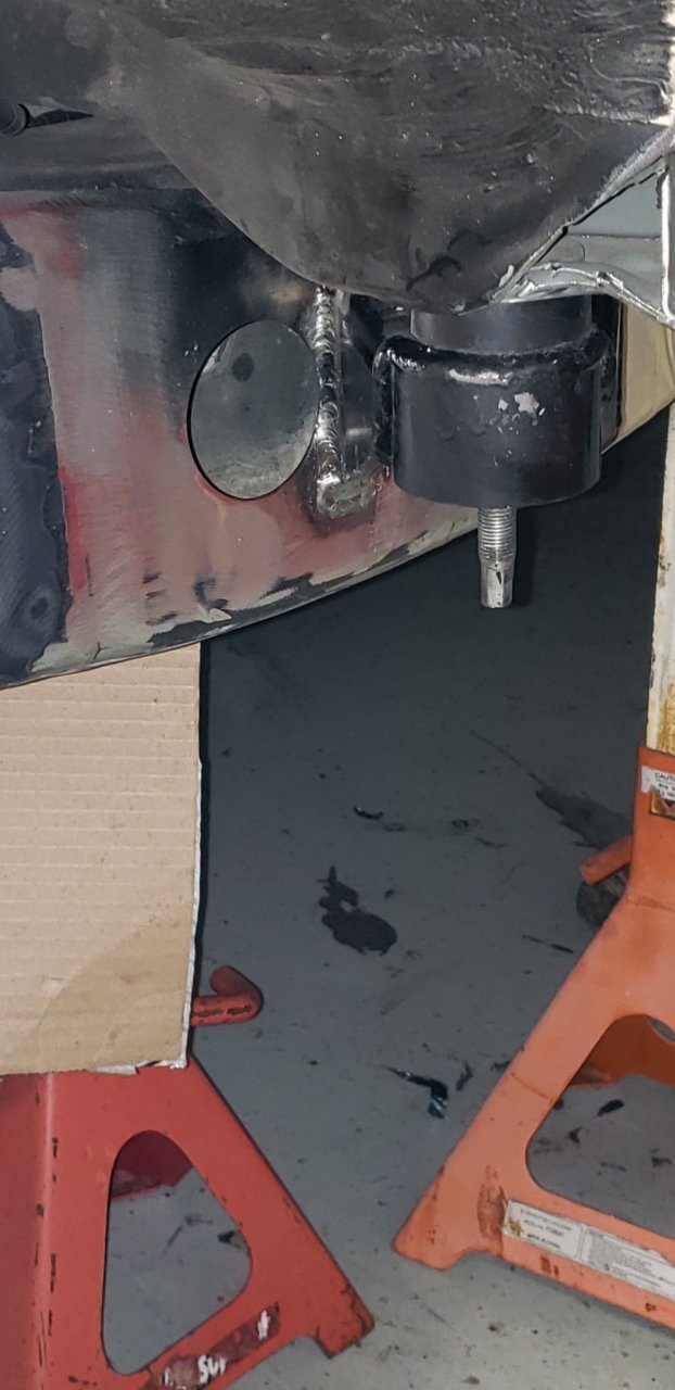

    Cab mount is relocated. Trying to decide if I'm going to weld a plate over the 2.5 inch hole. This hole is left in the frame after removing the orginal cab mount. What are most people doing? Hell maybe it's fine. I know the rear is only channel, but the front has all the weight. Guess if I'm questioning it, I should go ahead and weld some plate on there.
  10. Jan 18, 2021 at 1:03 AM
    #70
    EatSleepTacos
    Mar 24, 2015
    #151688
    59,828
    Randy
    West Valley, AZ
    2017 4Runner
    I would just leave it personally. I don’t know how much strength it would really add and it would it would introduce a lot more unnecessary heat into that area of the frame.

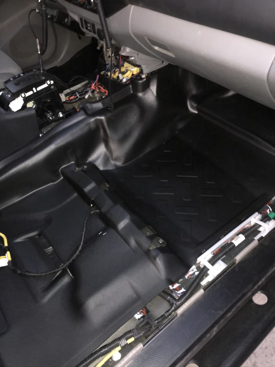

    you also have the option of the toyota all weather floor. I just pulled my carpet and swapped along with some sound deadening to keep noise down.

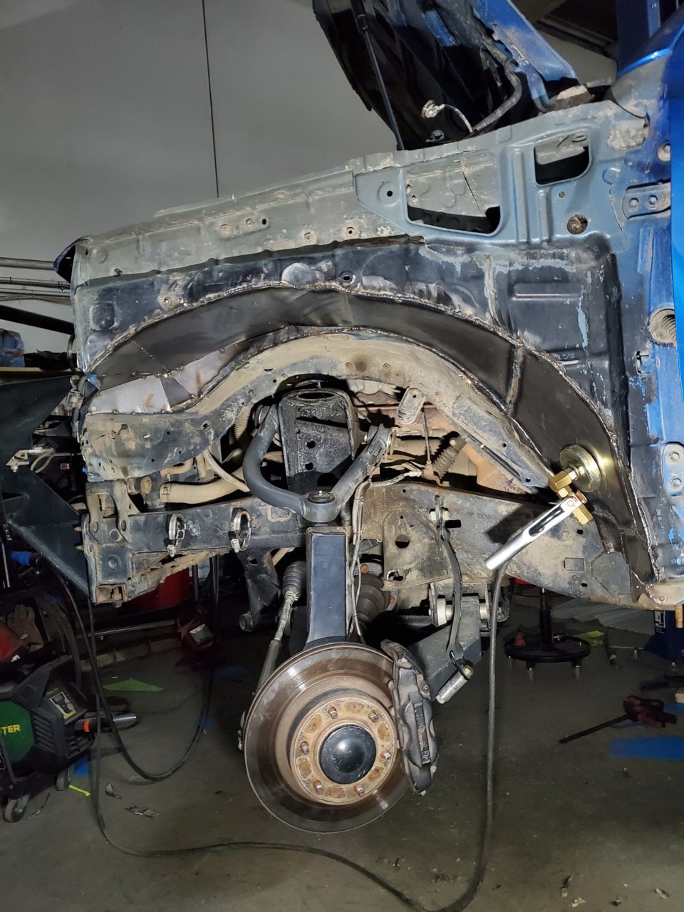

    I plated it. Frame was full of mud and junk from that hole and was rusting through. Had a hole rusted through on each side just below that circle hole that I could fit my hand through.
    I'm currently also in the process of tubbing, but quite a lot more cutting than you :anonymous:

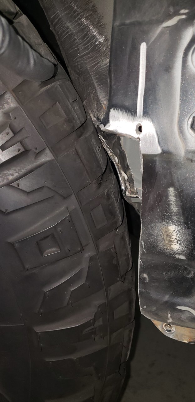

    Thanks. I am still cutting a little and hammering the rest. Going to weld some thicker plates in first, cover them with some 16 ga sheets, then 3M seam sealer to cover up my welds. I am more nervous about cutting the fenders and flares. Really want the flares secure and not just being held on with plastic clips. I may remove the clips and epoxy carriage bolts in their place. At least this would be fastened securely. Open to ideas on this. Again thanks
    For anyone interested, here are a few more pictures.

    you’re going to want to cut a bit more while you’re already doing this. The amount of body deflection will cause you to rub if you actually plan on wheeling.

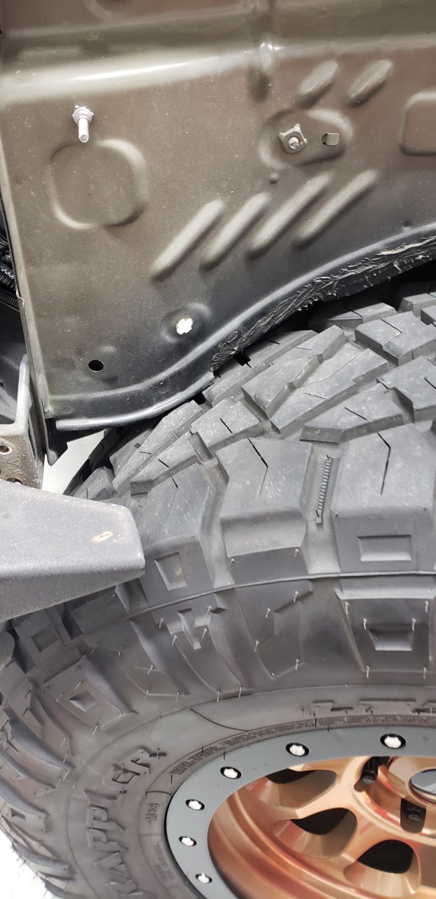

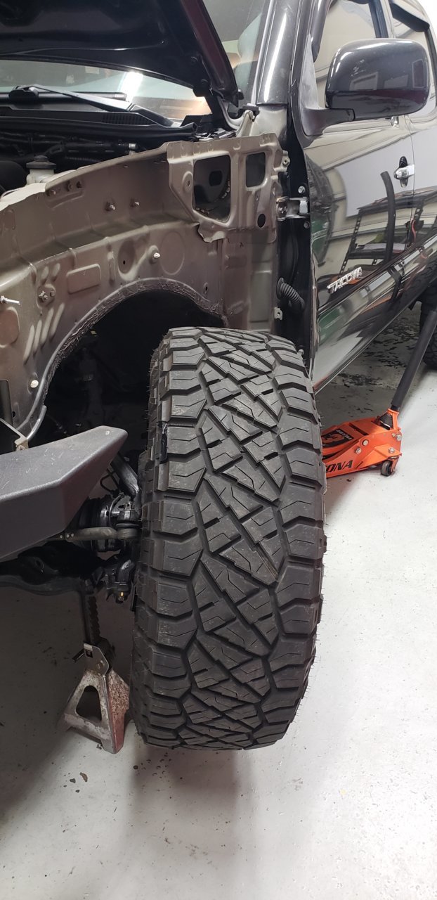

    At full bump what additional clearance did you leave? A half inch, an inch?
  17. Jan 18, 2021 at 11:03 PM
    #77
    WormSquirts
    WormSquirts Armageddon
    Dec 18, 2015
    #172583
    2,802
    Braeden
    BC

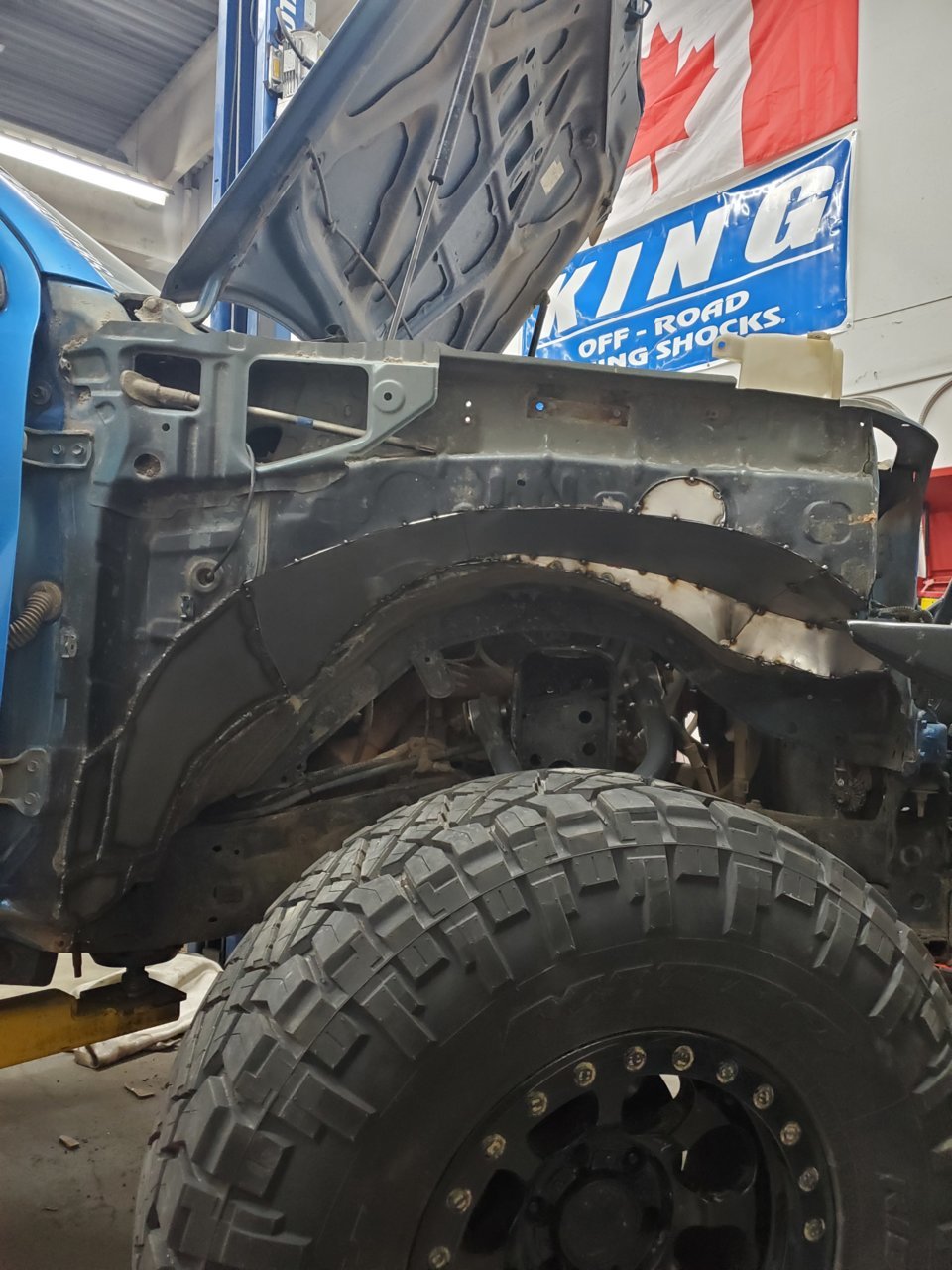

    I pulled the coilovers and bump stops out, then jacked up the tire as far as it would go until it was resting on the upper ball joint, then went about .5" further.
    dk_crew and SR-71A like this.
  18. Jan 19, 2021 at 5:38 AM
    #78
    Mech_Eng
    Mech_Eng Well-Known Member
    Nov 2, 2018
    #271418
    212
    Jason
    Birmingham, AL
    2009 TRD 4x4 DCSB
    See Build Page
    Wow. That's sweet. You rebuilt the inner fender completely. My coilover is out. I think im going to go about one inch at full bump and call it good. Are you running fiberglass fenders or did you cut the factory fenders? What gauge sheet metal did you use? That looks really good.

    the more the merrier. Shoot for an inch if you can fit it. A 1/2” at the least.

    Im just going to cut more out of my fenders. I kind of want to try rolling them, Like how the bagged out tuner car guys do it. We'll see. Glass would get smashed off so fast where I live, even though I do really want it.
    I used 16g sheet. Pretty thick, but it's working!
