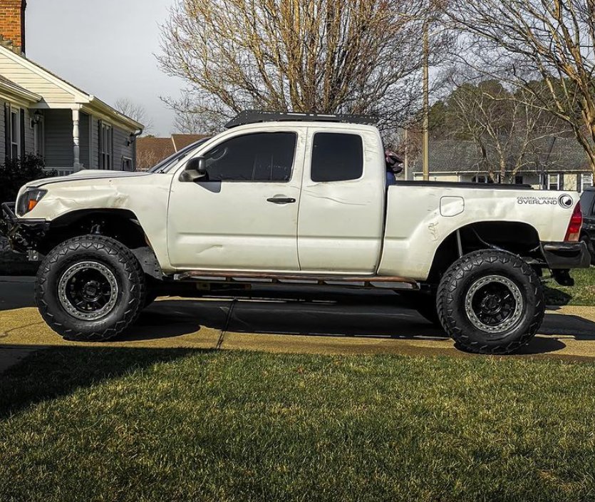

    That first pic on your build page.
    I also have the super bumps - I may need a little spacer. I would recommend moving your lower cams. I've done the garage alignment many times simply b/c the shops always push the rear cams back which causes it to rub more. And messing with them definitely takes the voodoo out of the alignment. But it takes patience and time. I'm sure I'm out of spec, but it drives fine. Seems like I rub a lot more - definitely in reverse backing out of my sloped driveway and a lot on the trails turning while crawling. I'm sure tubbing will clear it. I'm going to notch a few more home welding projects and take a crack at it soon enough.

    2017 4Runner
    Ahh gotcha. I had way too much lift in that pic which may cause some deception. Here's another dead on side pic of how it sits now. My fenders are trimmed pretty aggressively too which may play a role.
