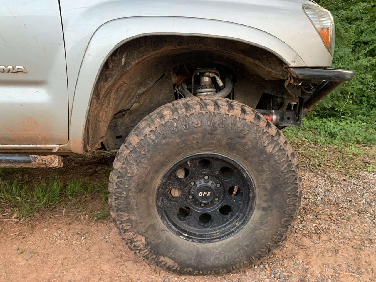

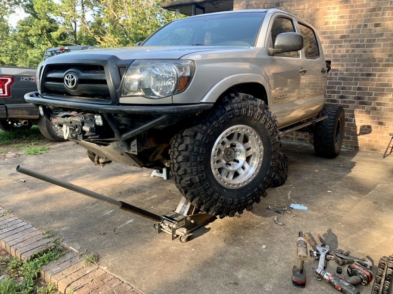

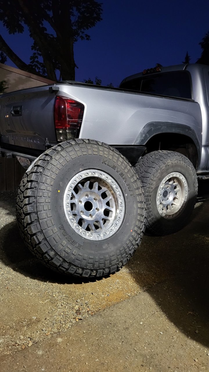

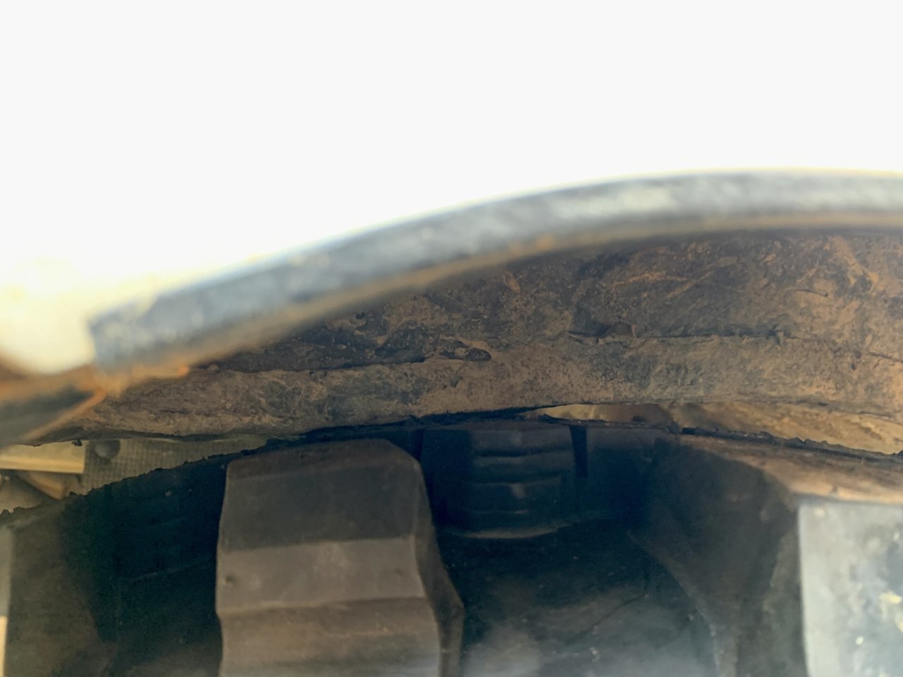

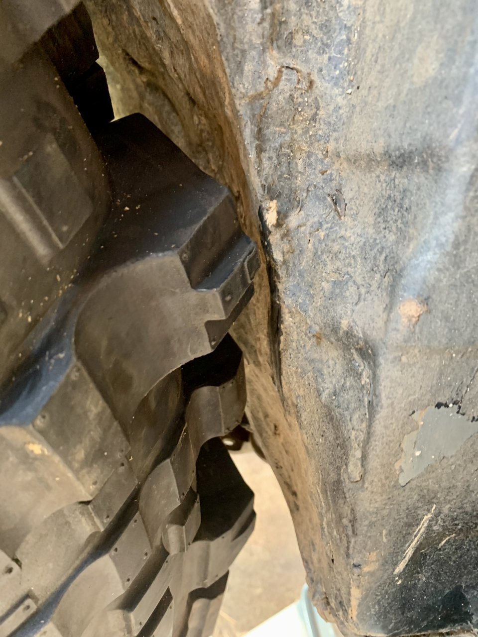

    Might as well post it here, too. Looks like I’ll clear 37s with just some more sledgehammer. So far no tubbing for any tire just sledge massages.

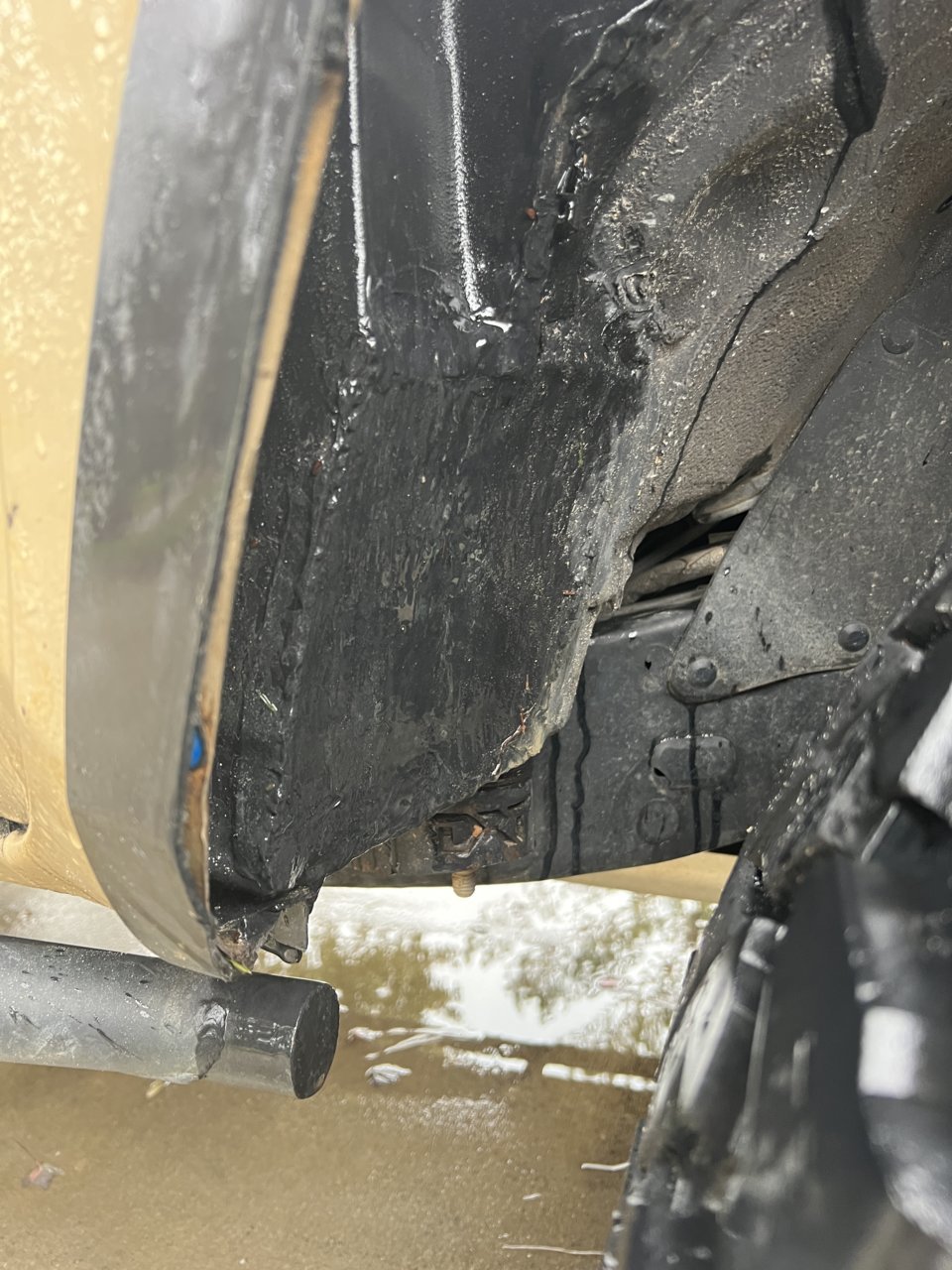

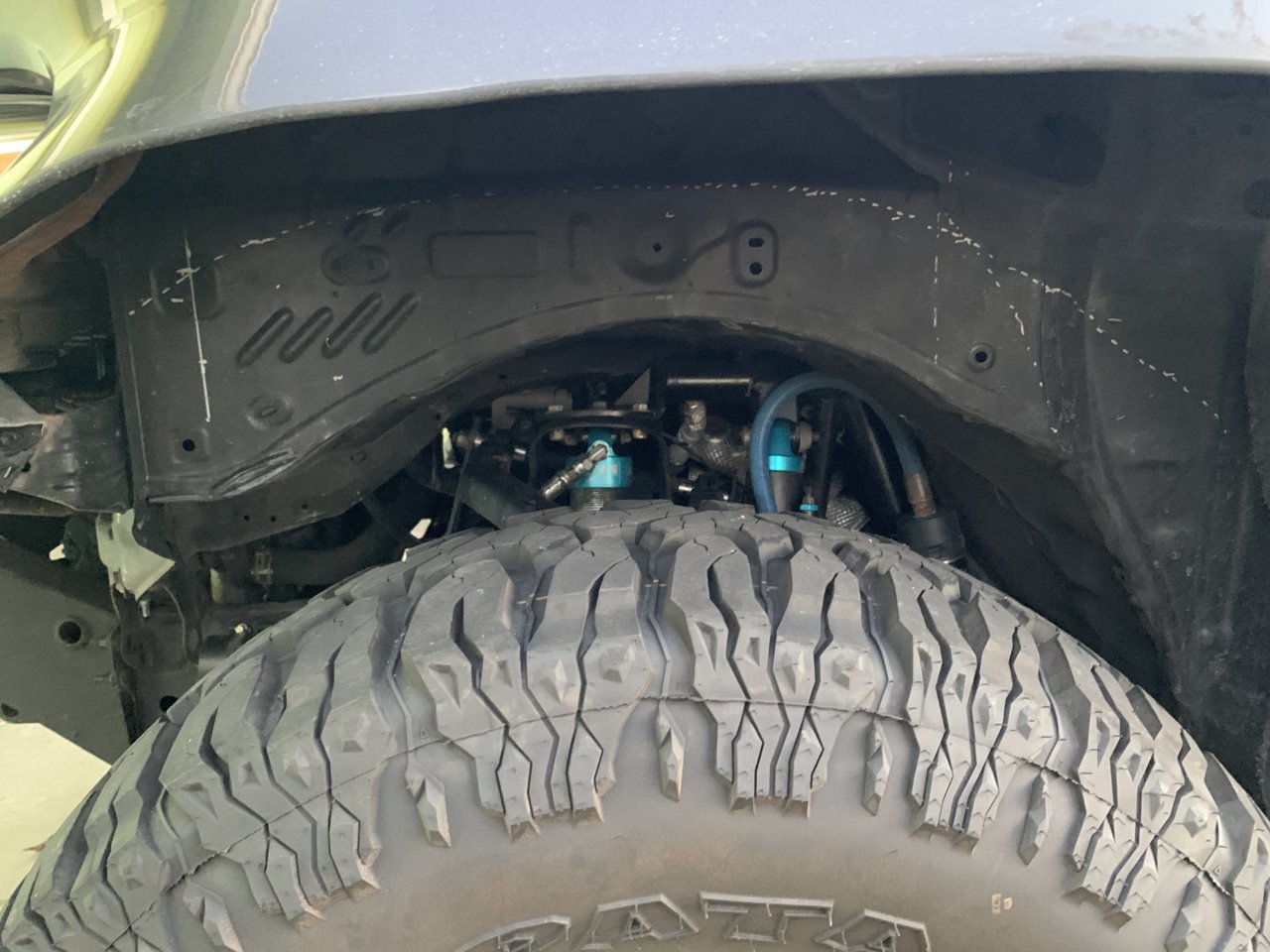

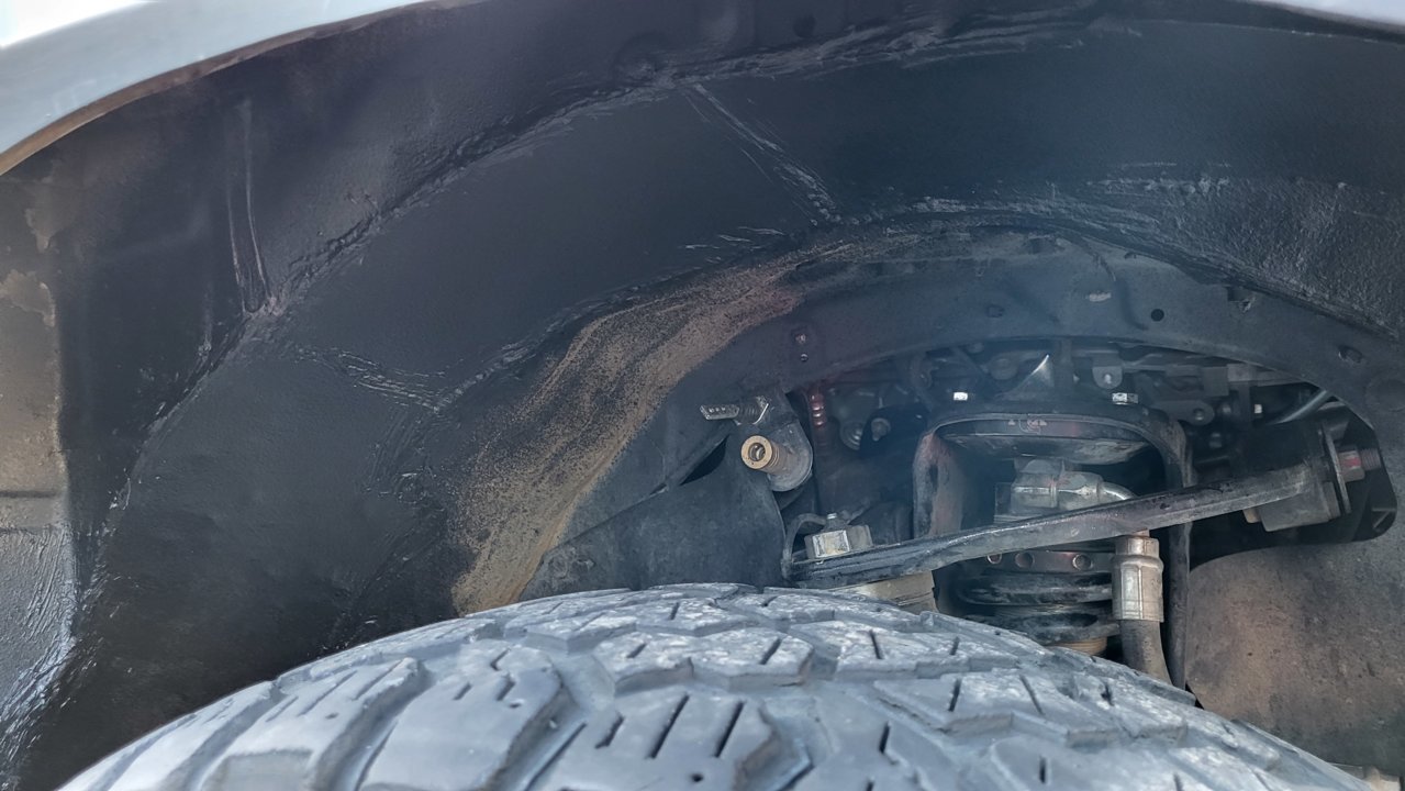

    My 37 job, no bump/shock in, stopped where my Uca hits the inner fender and trimmed a little excess from there. Stock width stuff, 17x9 -12 wheels with 1.25" spacers.
    And got 1 of my new tires last night so mounted that up. Still need to tub the drivers side inner fender, but got the drivers firewall done the other night. To truly not rub, I need to move the body mount bolt itself back, as I've already trimmed through almost half of my body mount bushing, or do LT to get the steering axis out/cut down on scrub radius.

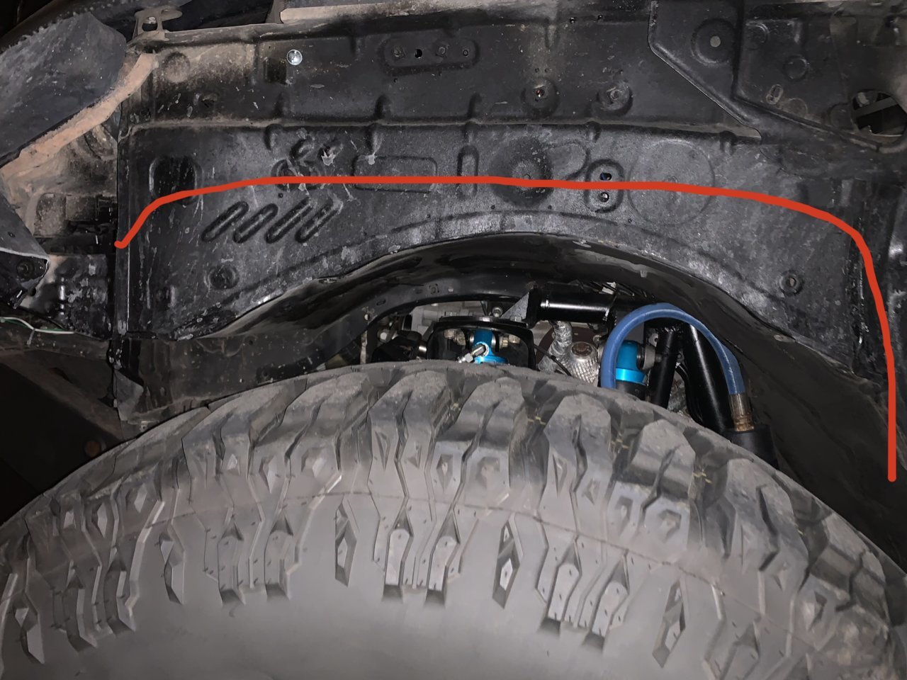

    This thread is pretty much dead, but I’m going to post my progress anyway because I think the pics help.
    Mine is a daily so I think I might do mine in two sections, two sides, so four weekends. I’m going to hit the firewall first - maybe tackle both sides in one weekend. Reason being is my tires rub on the street (only at the firewall) and I’m getting sick of three point turns everywhere. I’m going to cut that pretty much to the hinge. Plus I need to relocate my battery, washer fluid, intake etc before I tackle the wheel wells.
    For the rest I’ve marked it before but I’m going to cut way more to make it future proof. Also I’m limiting the up travel since my uppers currently hit the wheel well as well.
    I’m thinking of cutting something like this. Hack straight across, weld in some square tubing, tabs for various things, then some rubber sheet to seal it up. That might be easier as well. Plus I’ll have all the room in the world that way.
    That might not work after looking at pic again because there are a few things mounted way in the very inside like the power steering. Anyway, firewall first, then clean up engine bay, cut maximum. :cool:

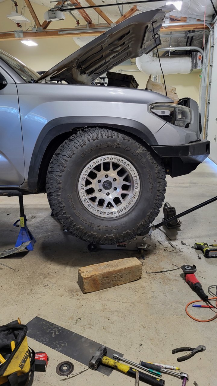

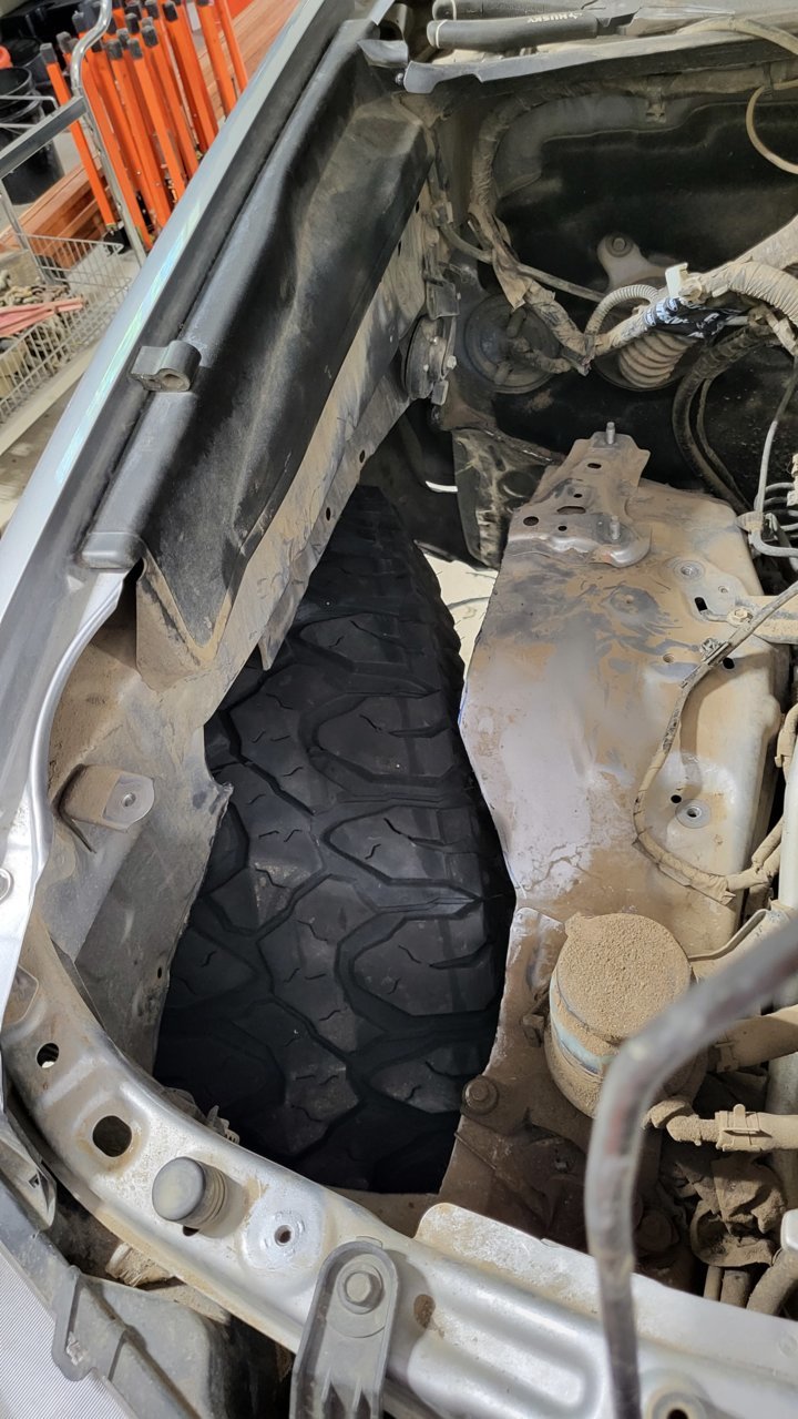

    I run 35s on mid travel -25 wheel and a 1.25 spacer as my rears were rubbing the shock body flexed. My lower firewall is about 5 inches back and 7-8 inches up, maybe 6 inches over. Everything else has been massaged with an 8 pound sledge up and back. Kinda wish I had a lefty in the family I could trust swinging an 8lbs sledge for the driver side. I have a very slight rub on the front at full bump on the upper front inner fenders. Very slight. I run Summu Springs in the front with a DK spacer and a mix of thicker rubber and large washers to get the bumps just right.
    Please correct me if I'm wrong. Under the limitations of IFS in our vehicles, you will get to a point where there will be no more benefit from upward wheel travel in the front. So full bump in the front could be adjusted for minor inner fender work as opposed to redoing the inner fender. Which is a little less intimidating for newer wheelers. Don't get me wrong, full stuffage looks amazing and you guys in the thread have done some real nice work. I see it as more necessary with a straight axle in order to maximize bump and drop.
    I'm interested in getting your thoughts on the matter. As I'm setting up for the JD Fab lower pivots and running larger tires.
    Pics, cause we all love pics.
