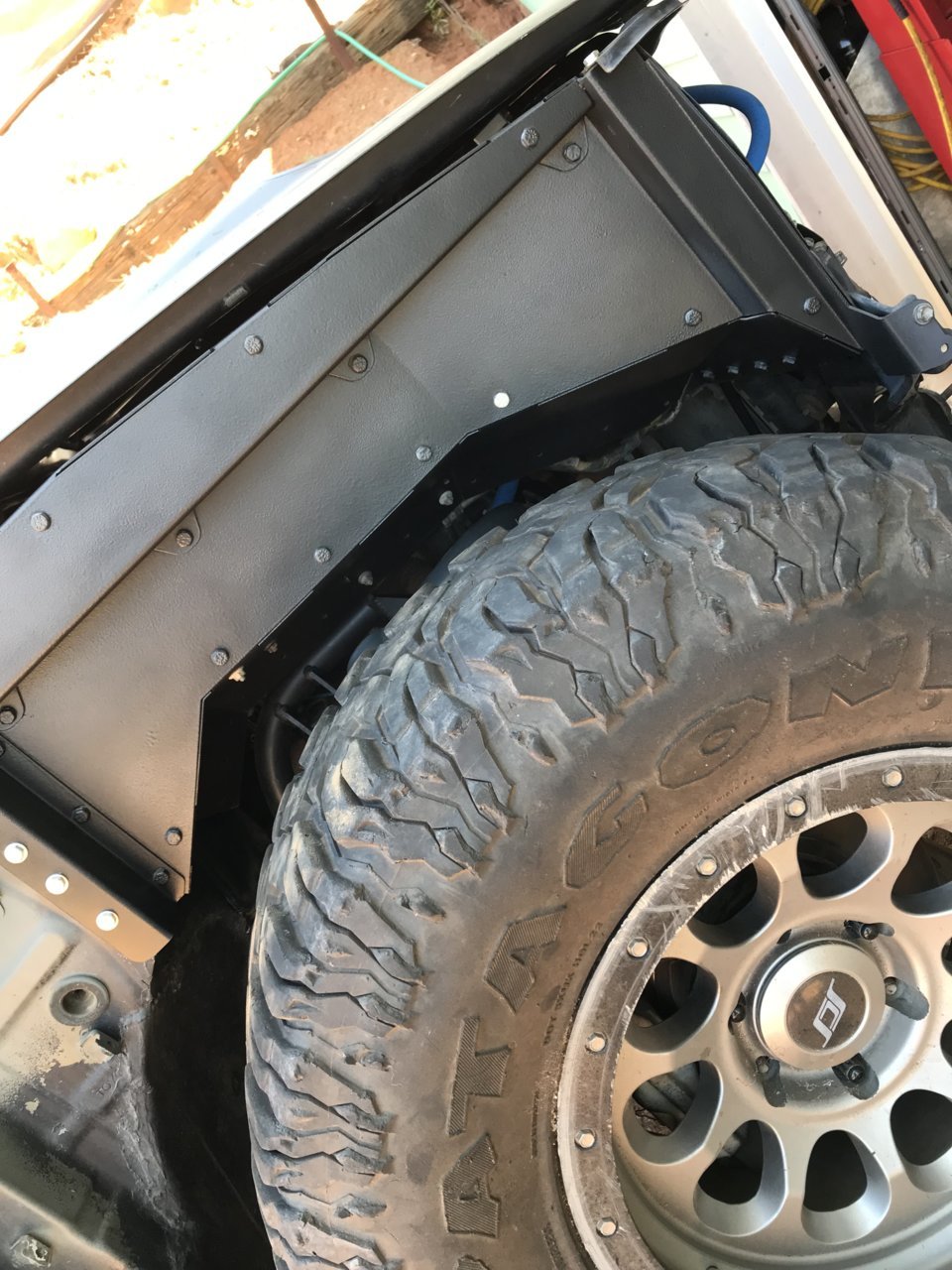

    Technically not tubbing but I got wheel well part done today. Turned out pretty good. Only thing left is mounting the air box and ps reservoir for tomorrow. Then it’s firewall time. :sawzall:

  9. Feb 3, 2023 at 6:39 PM
    #149
    erok81
    erok81 Well-Known Member
    Aug 15, 2016
    #194699
    5,708
    Imposter
    Nope. I built them out square tubing and aluminum plate. I think these have a little more clearance than JDs but not as much coverage into the engine bay.
  10. Feb 3, 2023 at 6:44 PM
    #150
    SoonToBeOn39s
    SoonToBeOn39s Well-Known Member
    Mar 20, 2022
    #393038
    1,792
    I finally got bigger tires 2020 Long Travel Tacoma 1997 MAGNUM
    Nice! Looks super good.

  12. Feb 3, 2023 at 6:58 PM
    #152
    erok81
    Aug 15, 2016
    #194699
    5,708
    Imposter
    Thanks! Other than the exterior bolts anything bolted to the inside is hidden via nutserts so it’s a little cleaner.
    SoonToBeOn39s[QUOTED] likes this.

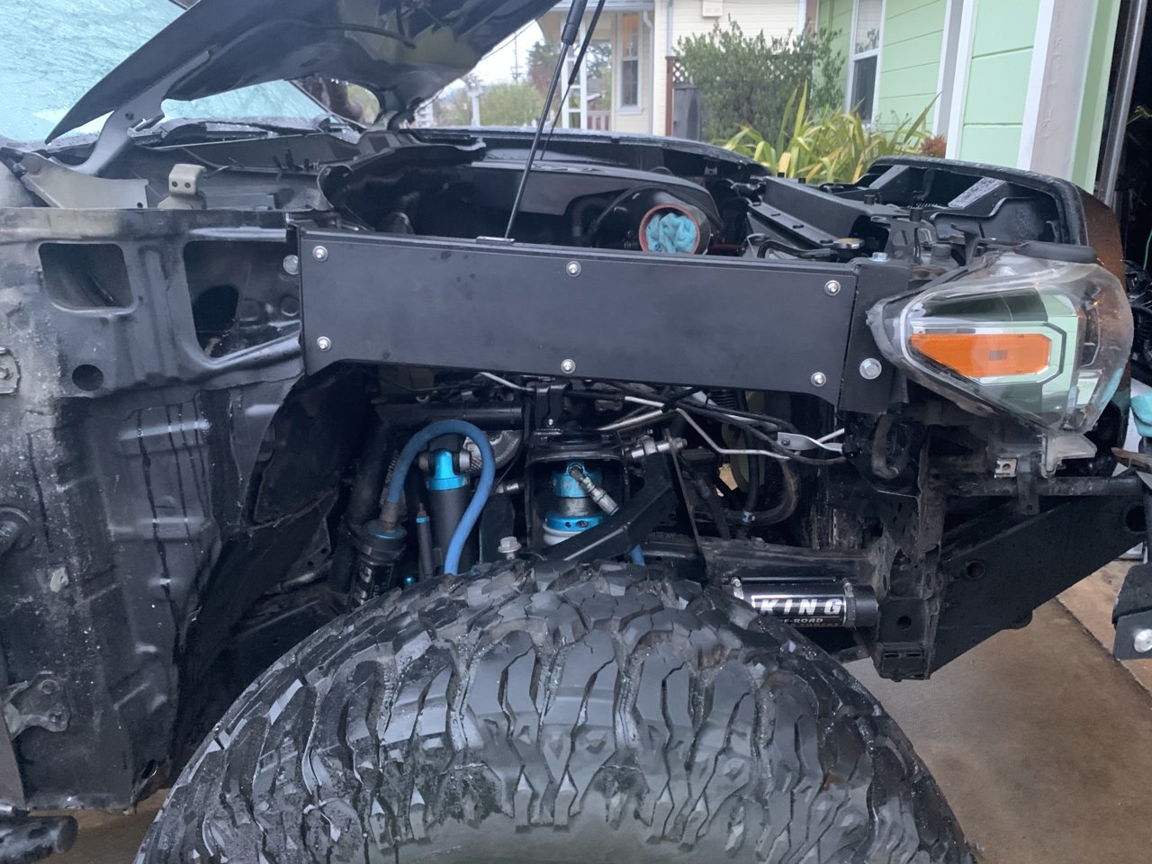

  14. Feb 3, 2023 at 7:29 PM
    #154
    desertjunkie760
    desertjunkie760 [OP] @DesertJunkie760 (IG)
    Apr 11, 2016
    #183963
    9,142
    Shane
    2011 MGM DCSB TRD Sport 4x4
    Check My Sig.
    Depends on how comfortable you are with cutting up your truck and some fab work. They are 315/70/17. Supposed to be a 35" but probably measure 34.5" once mounted.
    A pic of clearance at full bump & lock to keep it relevant to the thread.
  15. Feb 3, 2023 at 8:43 PM
    #155
    SoonToBeOn39s
    Mar 20, 2022
    #393038
    1,792
    Sure added some clearance. Any welding? I recall that on their website it's bolt on but would assume it requires some extra work.
  16. Feb 3, 2023 at 10:26 PM
    #156
    desertjunkie760
    Apr 11, 2016
    #183963
    9,142
    Shane
    Check My Sig.
    Especially considering I would stuff my tire into the wheel well before. Yes, there is some welding required. Not a ton but it’s needed.

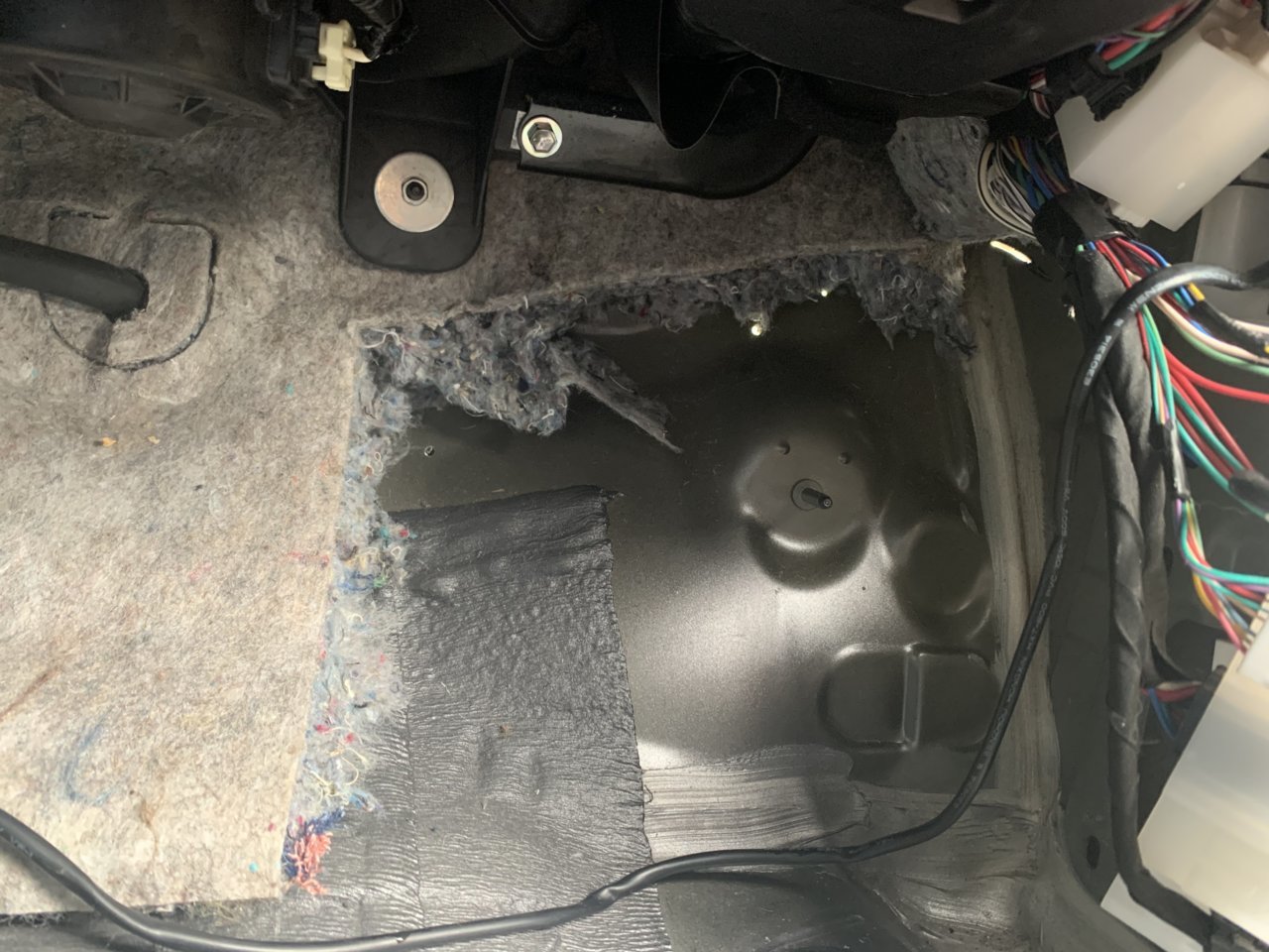

    Holy hell. What did you guys do with this insulation? It’s almost impossible to cut. Definitely impossible to tear. It goes way up into the dash too. So I’d have to remove the entire dash to get rid of it.

  18. Feb 4, 2023 at 3:08 PM
    #158
    Windigo
    Windigo Well-Known Member
    Dec 21, 2019
    #313884
    4,099
    Farook
    Toronto Ontario Canada
    '14 Acess Cab
    that looks to be enough but yea nice razor blade dose the job
  19. Feb 4, 2023 at 3:09 PM
    #159
    desertjunkie760
    Apr 11, 2016
    #183963
    9,142
    Shane
    Check My Sig.
    i just folded it up and out of the way until I was done. Flopped it back down into place after to cover the work

  20. Feb 4, 2023 at 3:29 PM
    #160
    erok81
    Aug 15, 2016
    #194699
    5,708
    Imposter
    That cut I did was like 20 passes with a super sharp Gerber knife. Still had to tear it. Of course my cut is right at the spot I need to cut metal. Which the frayed part is even more flammable.:bananadead:
