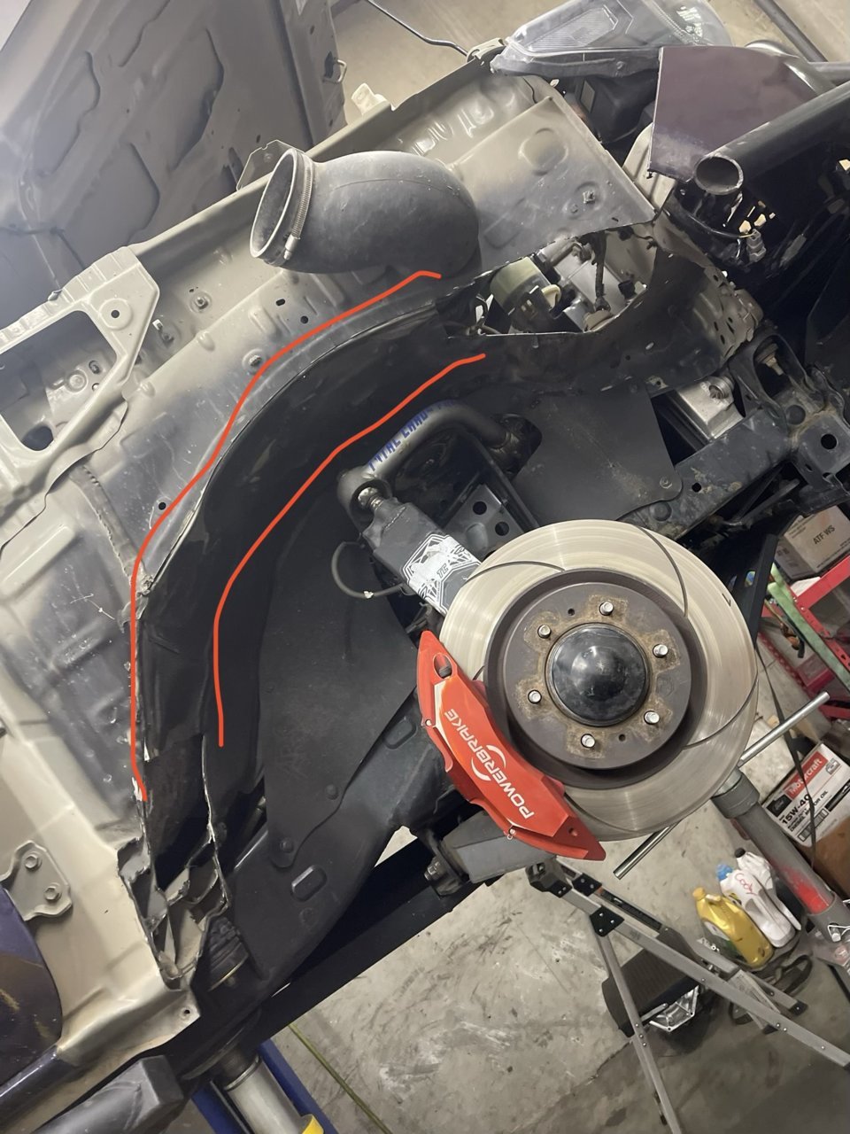

    Well this is the first project I’ve ever had second thoughts part way through it. :rofl:
    That bottom section is a huge pain in the ass to get off. Also only managed to nick one ground wire.
    Here’s what I had to cut off for my 38’s. I have to knock that corner off and a little section at the bottom then it’s welding time. Which I am super nervous about because I can’t get that insulation out of the way.

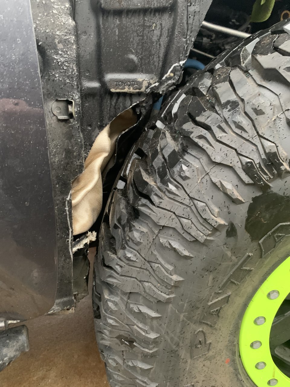

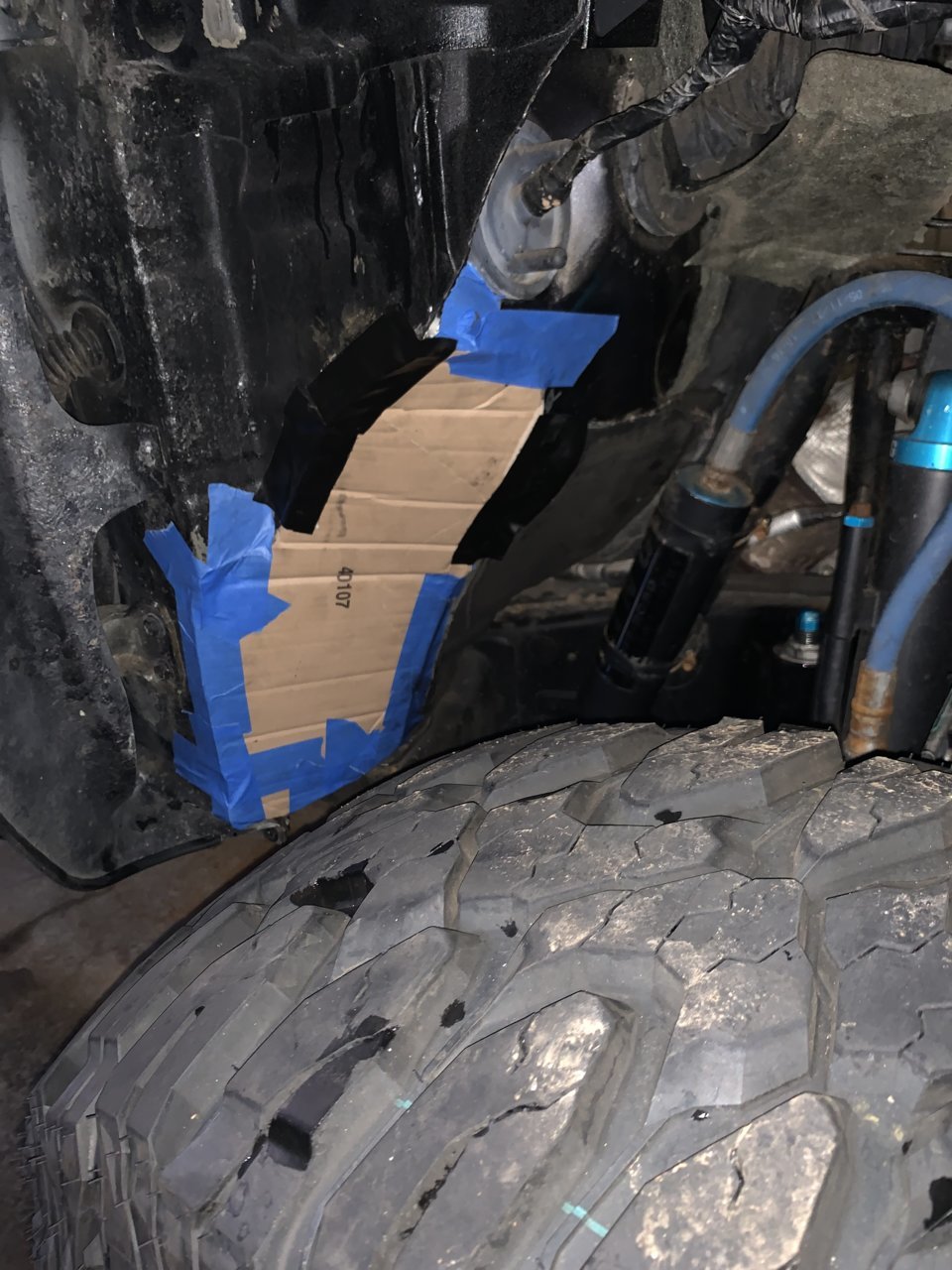

    Pro tip. Make sure you are done setting up your suspension before cutting. I cut the hole and then realized I have more uptravel with the wheel gone. Probably added 1-2” of extra uptravel and had to cut more when I cycled it afterwards.
    Also tubbing + daily sucks. Used my template for cutting the steel. Hope this holds for the commute next week. Added some more flex tape inside and out. :rofl:

    why did you have more up travel with the wheel on? What else were you hitting?

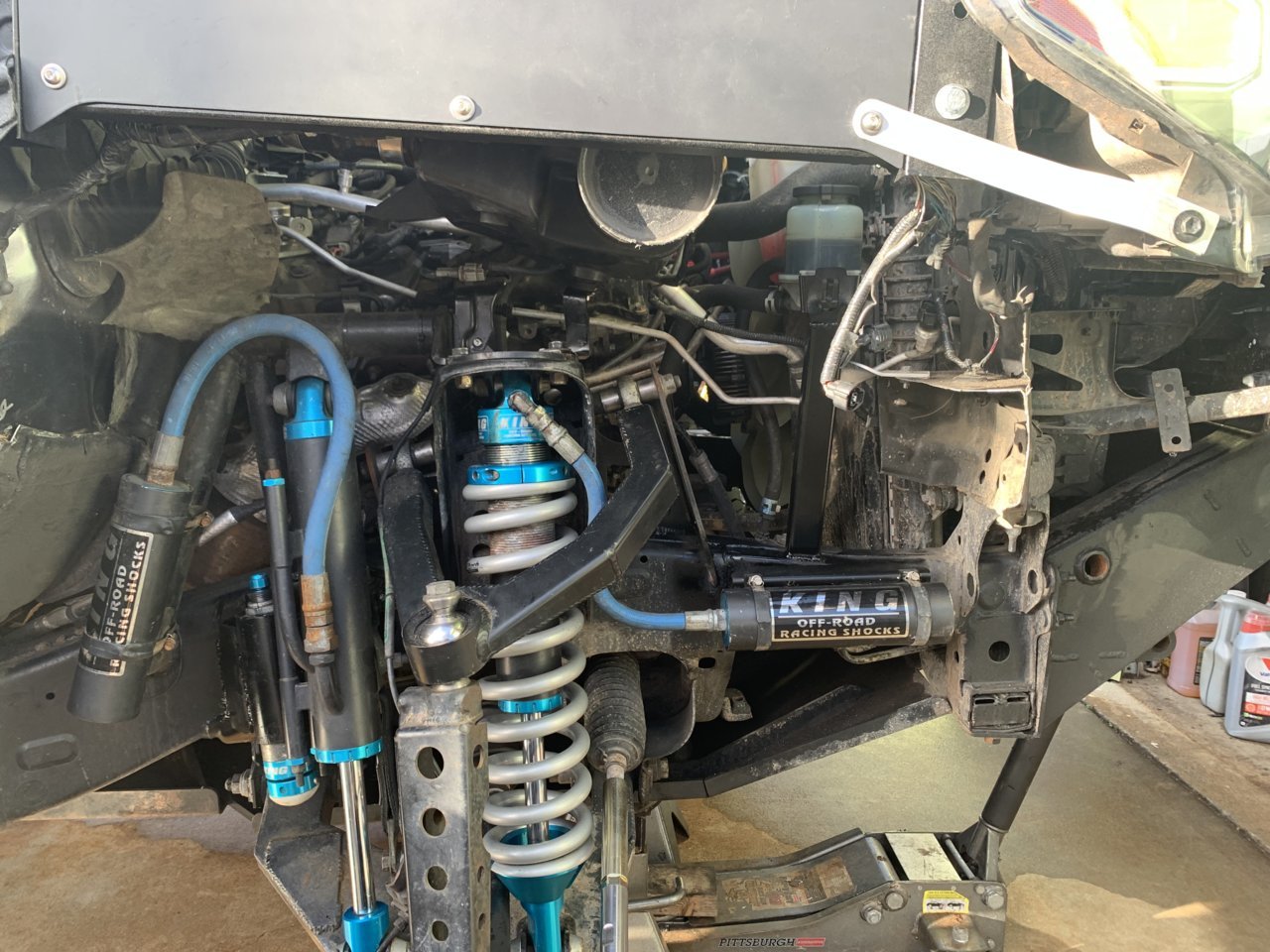

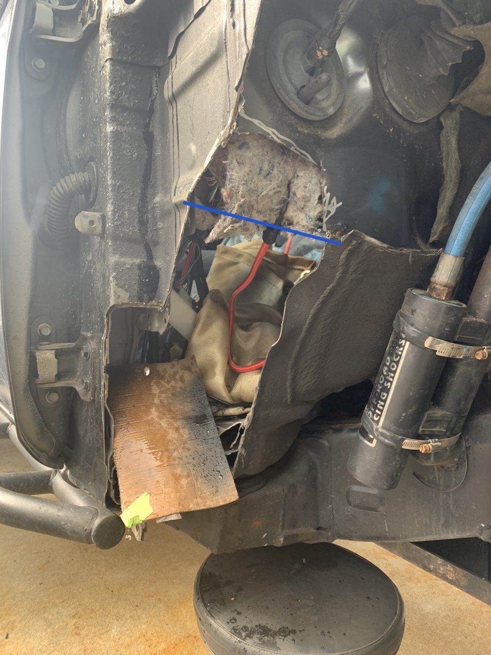

    So round one I removed the coilover and bottomed out my bypass and the bump (bypass bottoms before the coilover does). Marked everything and cut. Perfect.
    Then I realized previously I had everything set up to bump right before the upper arm hit the wheel well. Now that I don’t have that interference I had more uptravel. Moved the bump up about half an inch. Based on the extra I had to cut I probably got somewhere between 1-2” more. At this point I was sick of doing it and didn’t measure the full travel for the exact increase.
    It fully cleared the first cut but that extra uptravel I gained made me have to cut more. Here’s the final cut (blue line is round about the first cut). Maybe I didn’t have to cut as much because I have a 3.5 kit and 1” whee spacers? Not sure but this fully clears my 38x13.50’s.

    ^^ that's a lot more than I cut... Wow..

    Probably not the best for weather protection but I’m so glad I decided to just chop off that entire middle section. So much less sheetmetal work. All I had to do was make an air box mount and a PS mount. Pretty easy.
    You can see here along with what I left of the core support. Some u channel stuff for the ps mount and the airbox I used rubber mounts and mounted to the coilover tower and the wheel well thing. I’ll keep an eye on it for movement and maybe either fully mount from one or the other.
    I think for the washer reservoir I am just going to build a smaller one from 3-4” ABS pipe.

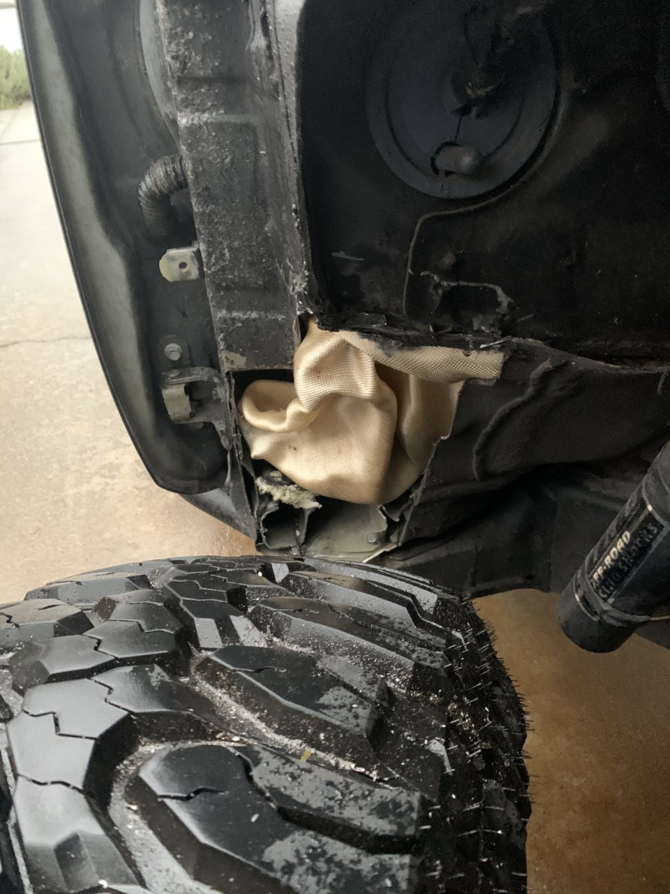

    For cutting through that bottom piece with the different layers. What did you guys do to make it through that section?
    The way I did it wasn’t even close to the most effective. I ended up cutting layers, drilling spot welds, and a bunch of hammering/rocking back and forth until I broke it off. I ended up with this mess and was worried I was going to to have to start cutting through the folded pieces.
