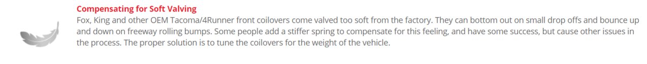

    Preload has no impact on ride quality at all as mentioned in the article.

    I previously had 14"x700 lb coils when my front end was heavier (135 lb bumper + 80 lb winch w/ steel line + 65 lb IFS) and that was still too much. It rode ok, but was a bit harsh (not firm) and the coilovers were constantly topping out over bumps from being over sprung.
    There are a lot of factors that go into achieving the ride someone wants which is why I always recommend talking to someone like Accutune if they're particular and want something specific.
    edit: Since you have the adjusters, it sounds like you could have your coilovers set up/tuned so it's the firmness you want for your daily weight with the adjusters wide open, then when you load up, just make them firmer. Then you get the best of both worlds and are taking advantage of the adjusters potential.

    I would highly suggest not adjusting the nitrogen pressure in the shock to help with ride quality issues. If you want to change ride quality on a coilover, start with spring rate then go to valving.
