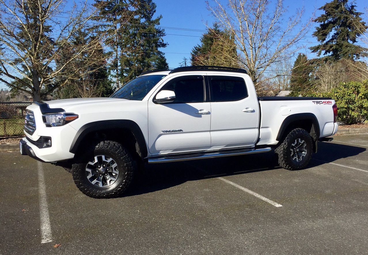

    Here's my experience...I have a 2017 TRD-OR long bed that I bought new. One year after I bought it, I changed my stock tires over to the slightly larger sized, Toyo Open Country MT's (265/75/16's) because I do some off-roading on some rugged forest service roads to get to my fishing holes, and I love the aggressive looks it gives my truck...its also my daily driver too. I did not lift or level my truck either and I had zero issues with the larger sized Toyo's. The following year AFTER installing the Toyo's, I upgraded my stock suspension by going with the Icon Stage-3 complete suspension system which did level my Tacoma and also added about 2 inches of lift overall. I do not think you will have any issues at all.

    Those pictures are making me want to sell my open country ATs and get MTs. Very nice looking set up!

    This looks really good! I just bought a 2019 off road tacoma and I am loving it.
