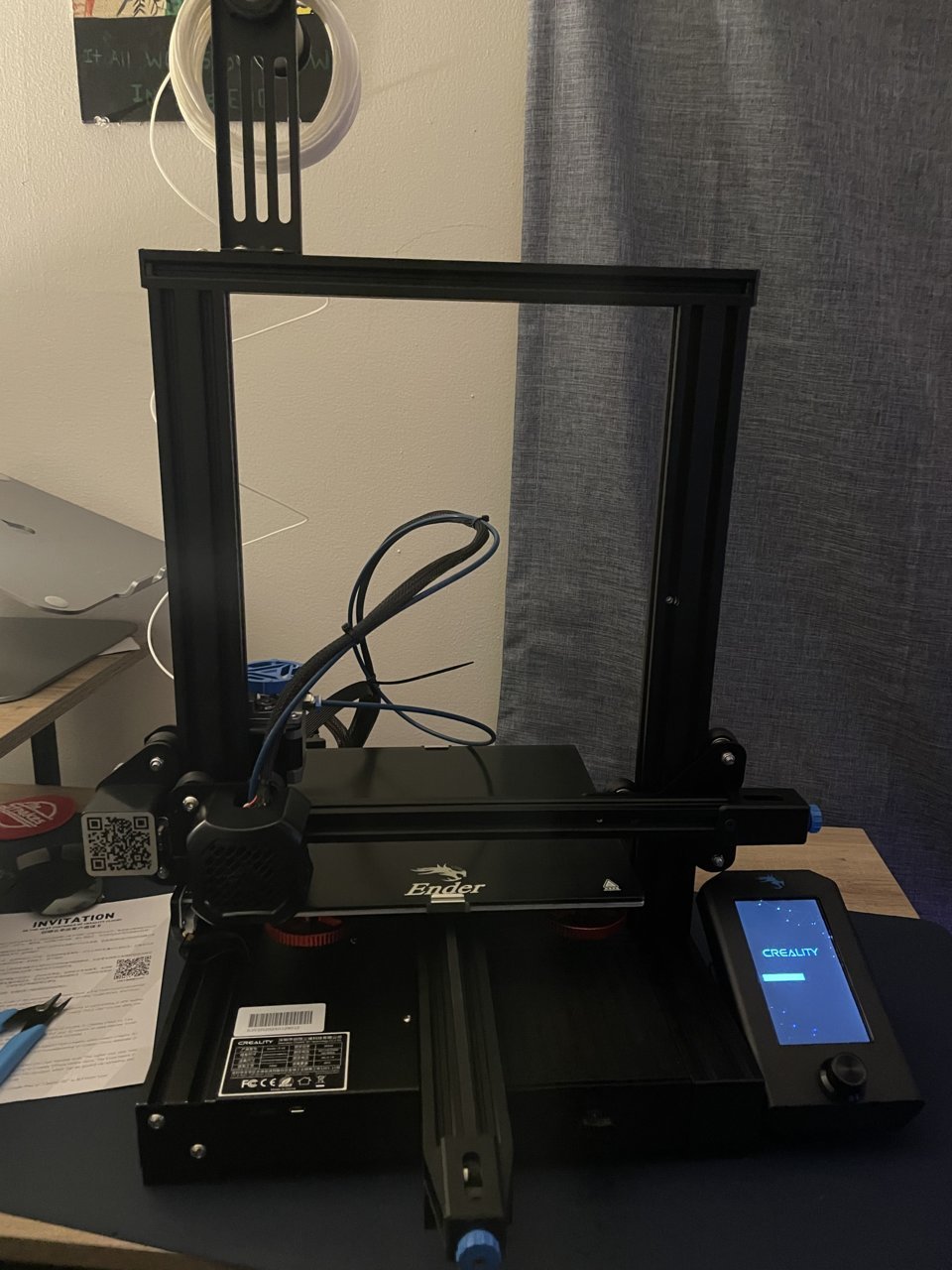

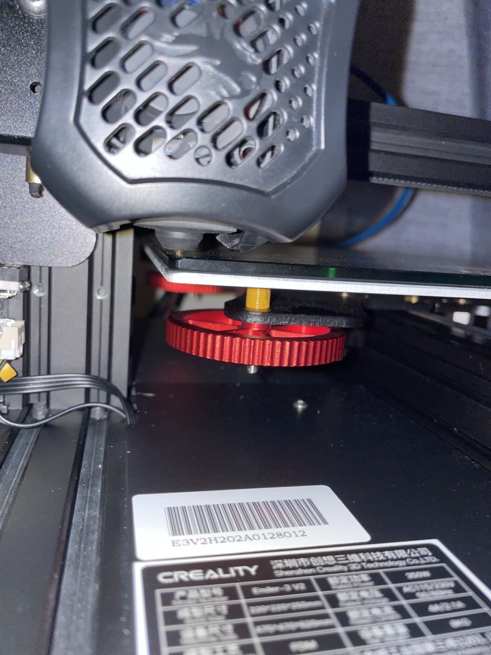

    Built my Ender 3 V2 and when I auto home it pushes my glass bed down. The extruder is always touching the bed and the bed levels are as tight as can be (pushing them away from the extruder) so it can’t go any further. I’m sure I messed something up here.

    Assuming the V2 is the same and that I remember correctly when I put mine together, the Z switch is adjustable up and down on the vertical rail, isn't it?

    Yes it is adjustable when I put it up and then auto level it goes back to touching the bed. Is that just normal? and I am supposed to adjust the vertical part before every print.

    No, your limit switch is too far down. First loosen the springs until each one just has a little pressure. Then manually move the nosel touches the bed with a sheet of paper between it. Then move your Z axis switch until it clicks or the switch makes contact.
    Next auto home and move to each corner of the bed. The paper should have some resistance between the nosel and the bed. Not too tight or too loose. Adjust each corner until there is a slight drag.

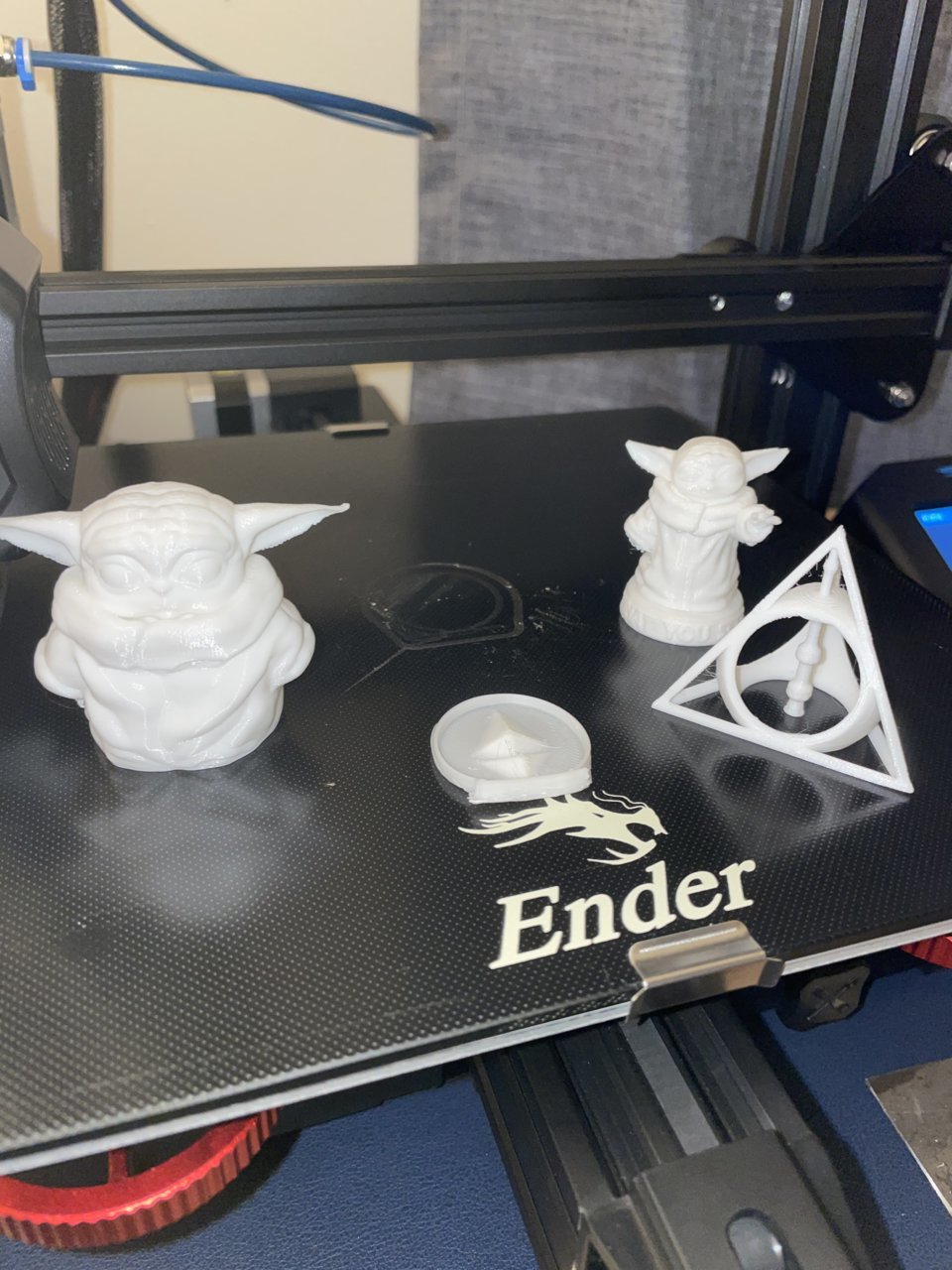

    The ETH was my first print you can probably tell by the quality haha. The others came after some tweaking. Loving the art of 3D printing thanks everyone for the suggestion and even help troubleshooting. After adjusting my limit switch as you said it fixed that issue and I was able to level my bed properly.
