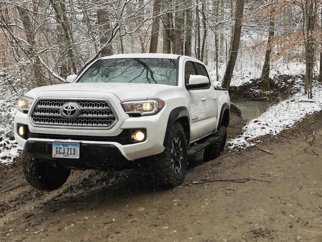

    I’ve been thinking about it a lot. I don’t think I’ll ever have a need for any high speed off roading like you’d have in the dunes or anything, and if I’m going to spend the money to lift it I might as well get the most bang for my buck and this definitely seems to be it. It’s been awhile since I read through the entire thread so forgive me if this is listed, but you ordered the leafs in a lift spring didn’t you? As in, like a 3” lifted Chevy leaf pack? Thanks for the write up btw. Seems pretty straight forward!

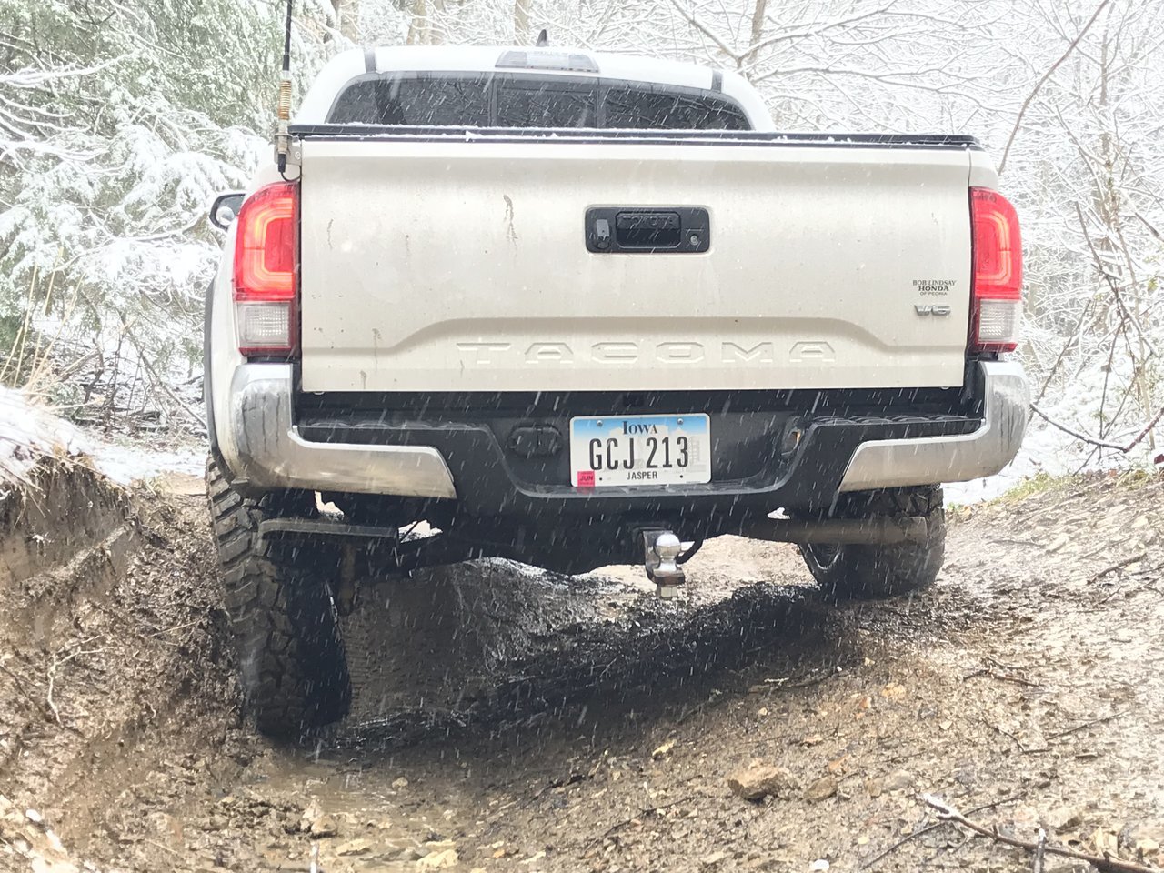

    Good to know. I’m definitely going to go this route. I had my truck on some real trails last week and the picture doesn’t show it well but the rear is in the air here so I could definitely use it. This was the 4th line I attempted to see if I could make it up without use of the locker and I definitely couldn’t lol 22750BEC-3FEF-48A7-B3F4-8F2B6D25B22B.jpg8277D8B5-851D-4993-BD70-249F483A45CB.jpg

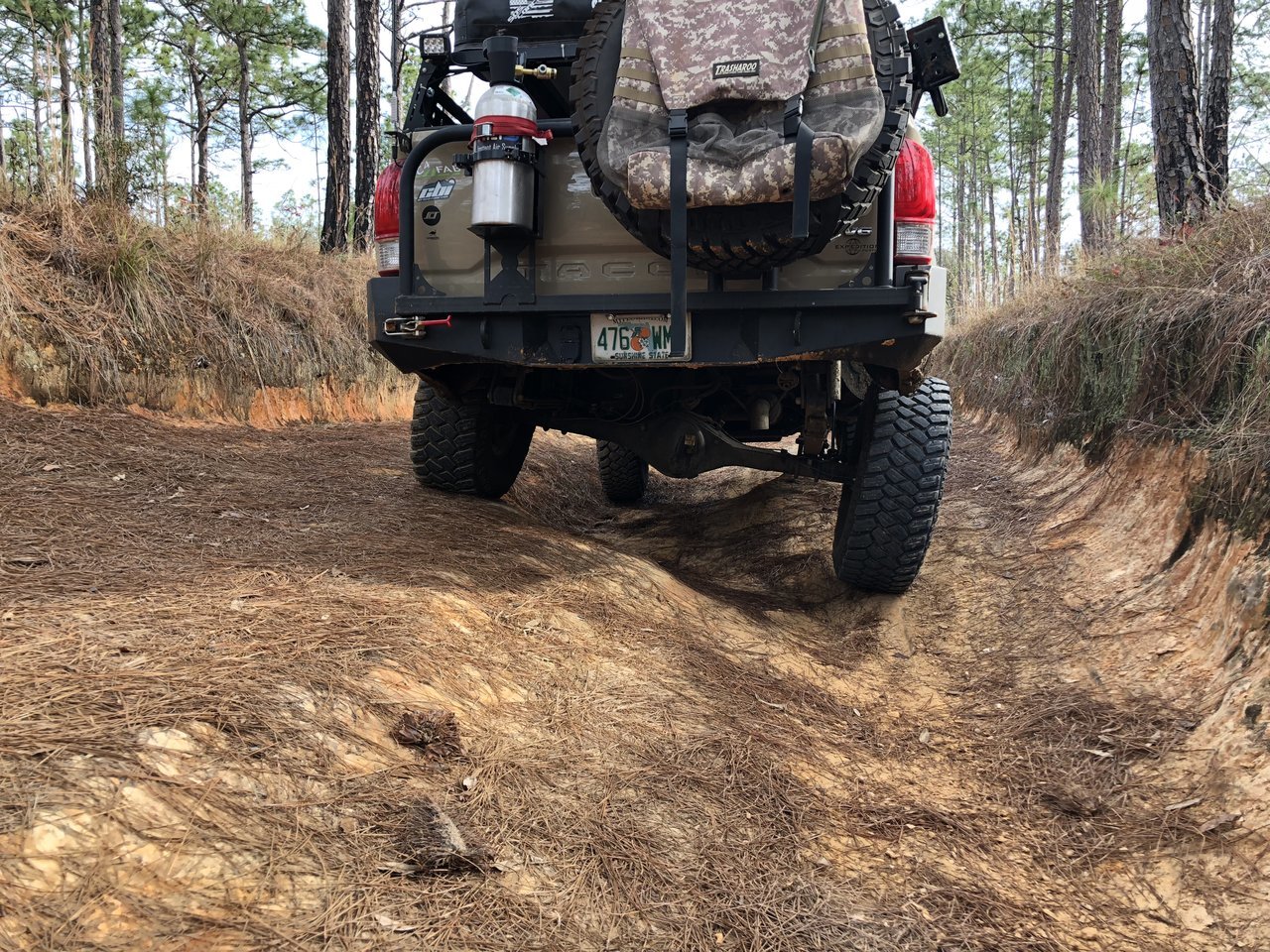

    You definitely keep the rear on the ground with 63’s and shock relocation.CE20DC11-3111-41F9-8EE2-A03812B9AE37.jpg

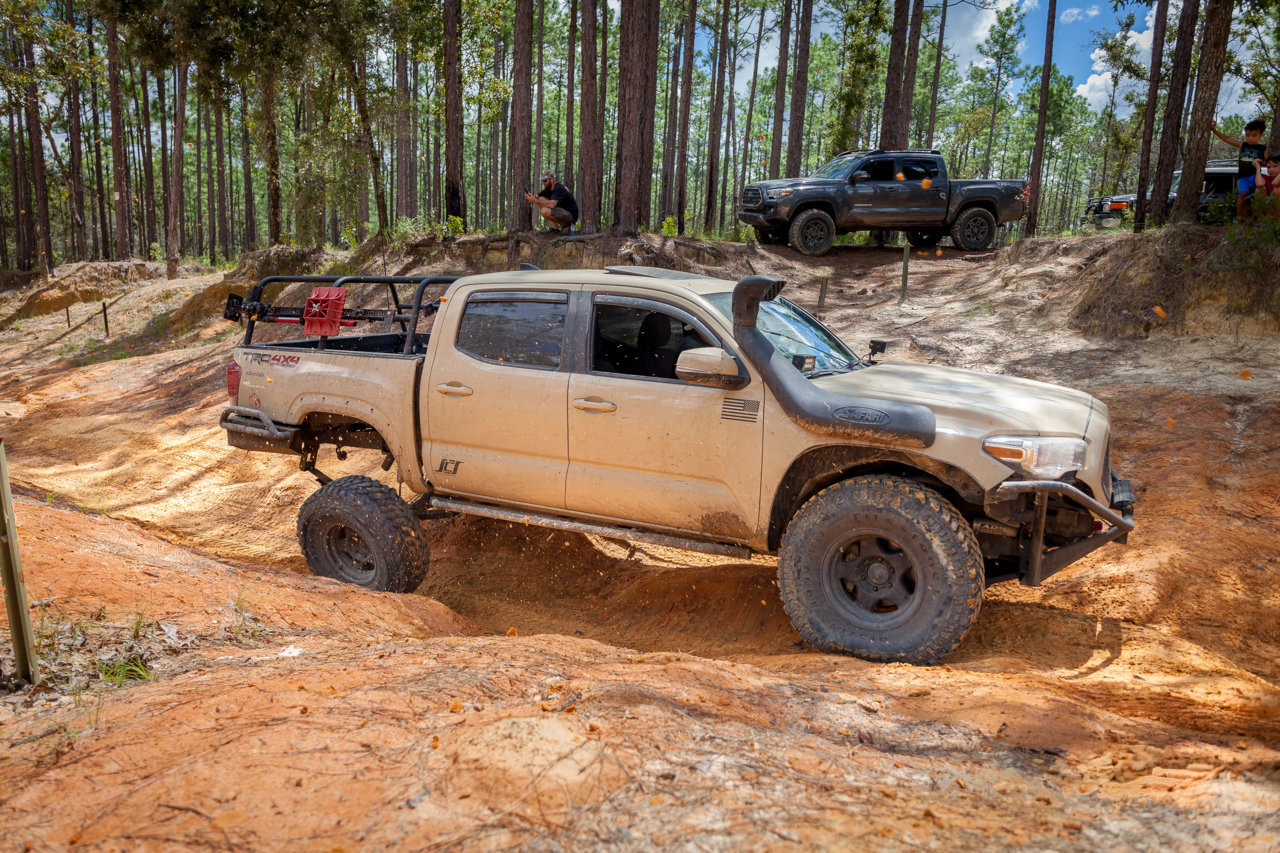

    Crummy Pics, but Dakars and 35's for comparison.

    Here’s 63’s and 35’s.
