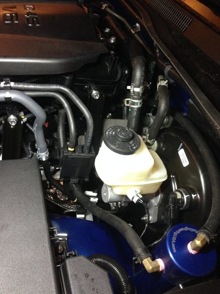

    You actually could probably get away with fooling the computer if you plugged the vacuum on the other side. Cars in the 1950's-1960's did this, it was called a road draft tube.
    When its unplugged the vapours coming out would have to be routed under your car and then you would never have to undercoat your car.
    I posted a bunch of pics, its really not that hard, you just have to make a bracket to offset the oil separator as the factory threaded holes are over the fuse box. Thats why I made the plate, to move it down. This oil separator was on my 2012 Camaro 6.2L V8, then went to the FJ cruiser, and now the tacoma, The Brand is elite engineering. Its made very well. Its the Camaro one and I just fabricated the brakes to make it fit. I'll post some pics of where the lines actually connect to the engine.

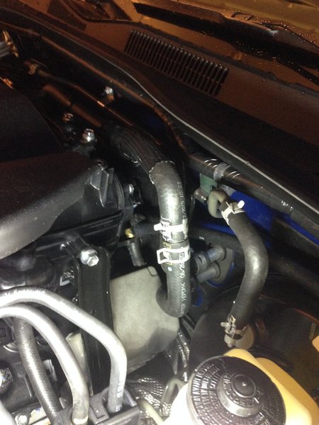

    The first picture shows both lines, one go to the intake manifold, you can see it in the first picture (I gotta learn how to write and draw on pictures). On the second picture you can see the line goes to the valve cover. Basically you take off the rubber line that goes from valve cover to intake and route the oil separator in between. This separator catches a lot so its a good one. I think most that have baffles and some mesh are pretty good. This one is billet machined and the bottom just unscrews (its sealed with a rubber o-ring)
