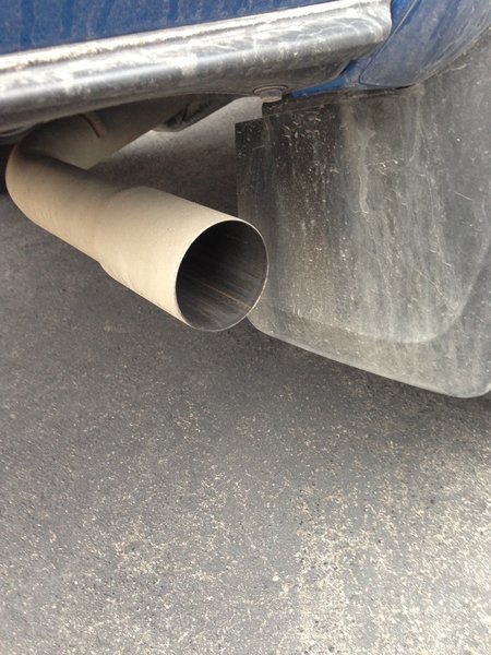

    Wondering if someone can take a pic of their muffler pipe. This is mine at 3000kms. I want to see how much the oil separator is working

    5,652
    2016 Offroad AC
    Mine is black inside at 1900 miles.

    2016Taco
    2016Taco [OP] Well-Known Member
    Apr 26, 2015
    #153963
    374
    Greater Toronto Area
    2016 Blazing Blue TRD Sport Upgrade DCLB 4X4
    So this one is working pretty efficiently.

    1st I have heard of oil separators in the valve covers, its a good idea if it works. Motorcycles use them. I know I have to empty my catch can quite regularly so its catching stuff. Best part is it catches the humidity on quick drives before the engine warms up.
    I guess the thing to look at is how clean your tail pipe is. If your tailpipe is black, you can be assured its quite worse in your engine. My tailpipe at 3000kms is still silver when looking inside. People can debate if you really need it, but for about 100 bucks I'm happy to have one. Its a cheap mod.

    #172494
    11,979
    It's an exhaust pipe, I don't expect it to be clean. It also depends on the operating temp of the cat, short drives will make black exhaust due to unburnt fuel skipping past the cat.
    I understand why some people will want it, I just want to make sure people are informed and don't think its necessary to buy a catch can. It's no different than a seat cover, lift or a winch, it makes the owner happy. :cheers:

    5,652
    2016 Offroad AC
    Tail pipe isn't that much of a smoking gun, so to speak
    I run a catch can on my g8, and all 4 tips get black quite quickly. But I don't run cats, and WOT AFR is around 12.3-12.6. A lot of the soot depends on driving style. In the case of my Tacoma, the cats don't get warm enough on my short 1.5 mile trips to work
