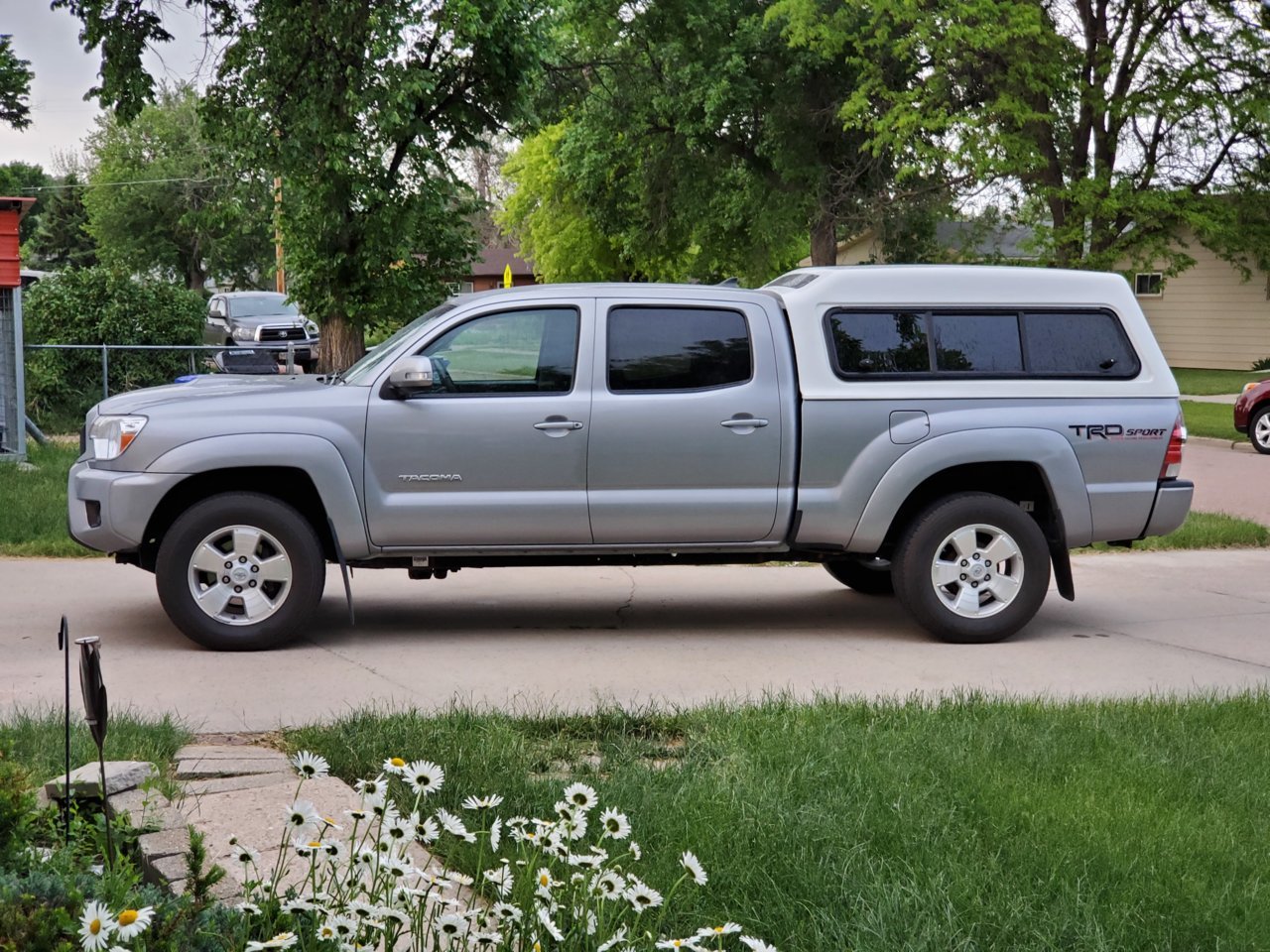

    Hey all, new Tacoma owner and first time poster. I bought a 2015 Long bed TRD Sport Tacoma a couple weeks back. The first thing I did was add a high rise ARE topper since I want to build a tool storage bed/sleeping area but there are other things Im sure I should do to. What are your first mechanical checks and changes you would recommend a new Taco owner? I plan to use the truck for everyday use but also hunting, fishing, camping, general all around fun. I attached a quick pic of the new rig too for anyone that cares. Thanks again for any and all suggestions!

    No suggestions but I like your mismatched topper
