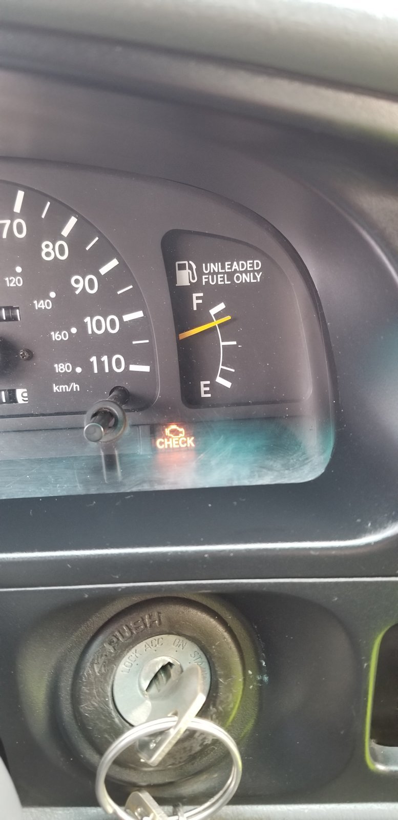

    Hello everyone,
    I bought my base model tacoma back in Dec of 1995, and after almost 28 years and nearly 350 k miles i got my first check engine light..

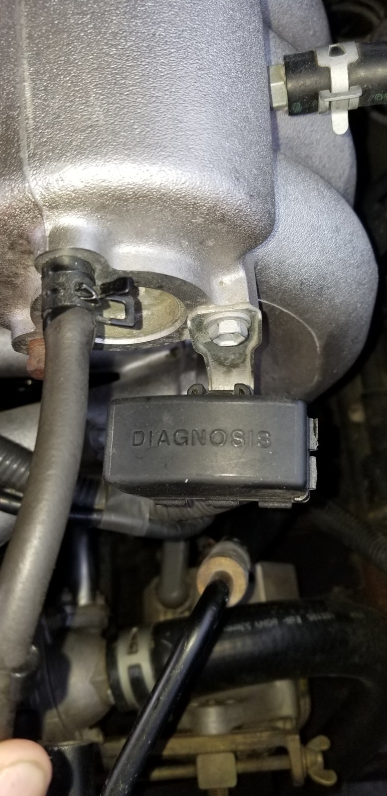

    My tacoma does not have a Obd2 plug, i thought i had an obd1, but i was told thats not it...see pic

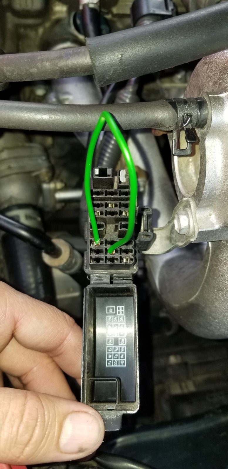

    I saw a YouTube video where you could use a wire to jump two points and get a code ..(check engine light would flash a number of times giving you the code #) see pic also
    But i dont get it to flash....it just stays solid..see pic also...
    How do i read the check engine light code without having to take it to a mechanic??
    2wd
    2.4
    Extra cab

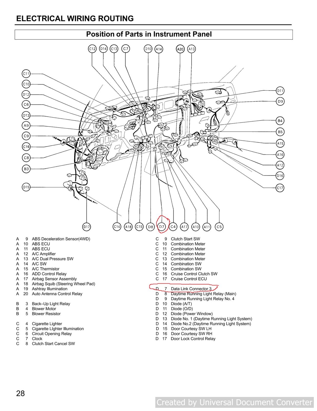

    A 95 Tacoma is OBD II compliant, the OBD II Connector (Labeled Data Link Connector 3) is up near the accelerator pedal.
    b_r_o and rocknbil like this.

    The diagnostic connector out in the engine bay is old-school classic toyota engineering stuff. All those pins are commonly used circuits in the EFI system. With a DMM or scope you can tap ignition power from the key, pcm power circuits, check the primary side of the coil, look at O2 sensors, all kinds of stuff..

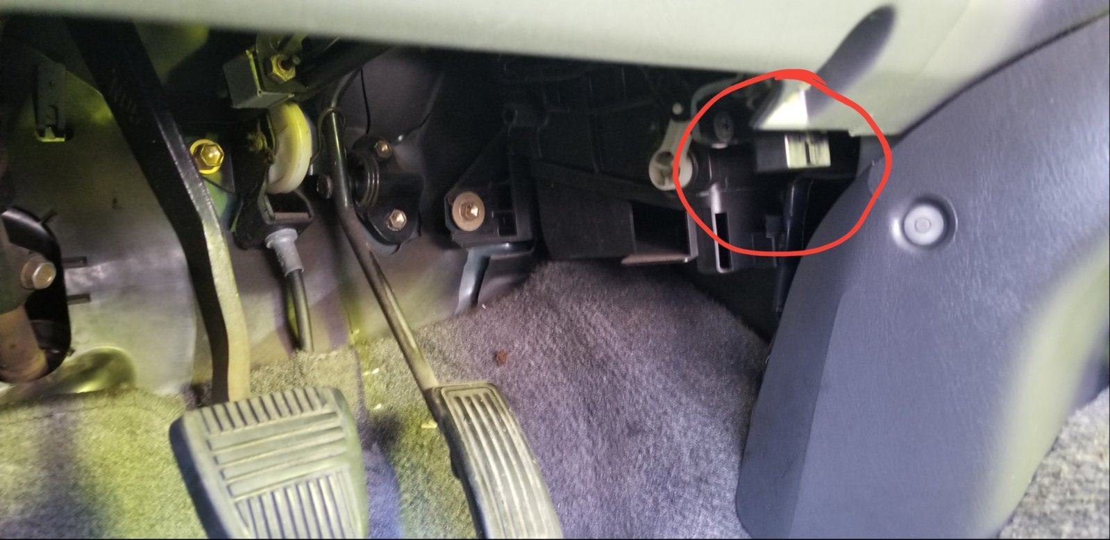

    Omg...it was there all along!!
    Under , near the accelerator pedal like you guys pointed out.
    See pic...
    I used my scanner and comes up with a P0420...which has to do with the catalytic or oxygen sensor.( acording to a quick Google search)
    Will start by replacing the oxygen sensor...
    Will post the results... soon.
    Thanks for all your inputs.

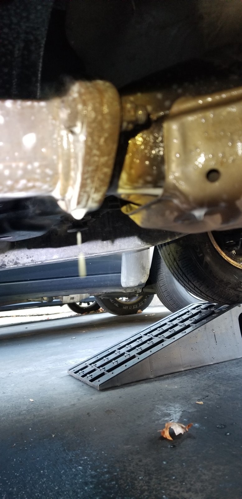

    Do a test for an exhaust leak prior to replacing any oxygen sensor. It seems like exhaust leaks are a common cause of the 420 code with these trucks. It was with mine.

    How do i perform an exhaust leak??

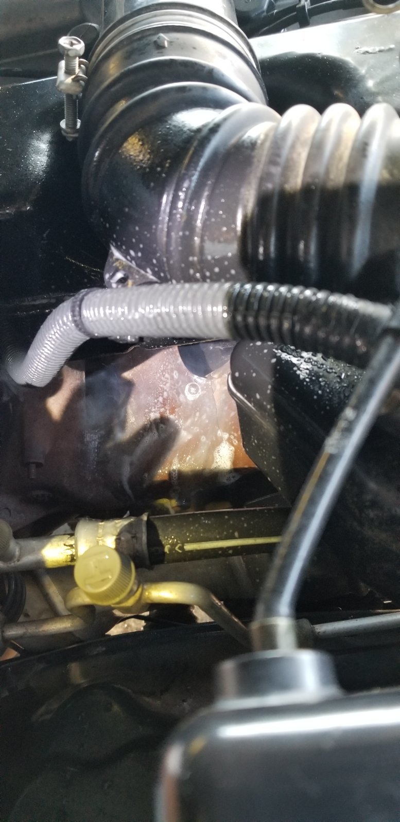

    Hi everyone,
    Tanks for all your input. So as you guys suggested i checked for an exhaust leak using the soapy water, but no bubbles. ! I did all the connections points from top to bottom. so i decided to go head and replace both the upstream and downstream oxygen sensor. Got it from O'Reilly for about $160.
    Easy installation no problems. Went to work, ran errands and so far after 160 mil. After replacing and clearing the code, everything looking good. No more check engine light.
    Thank you once again.

    Didn’t see it mentioned but have you checked the exhaust manifold? Those cast manifolds like to crack. Had my own P0420 chase and that was the culprit. Would reset and it would come back till I replaced the manifold. Good luck with it.
  16. Nov 27, 2023 at 4:19 PM
    #16
    Taco1stgen
    Taco1stgen [OP] Member
    Nov 8, 2023
    #437103
    7
    Yes, i agree.
    Mine has a nimor crack but when i sprayed soapy water...no bubbles anywhere...i repeated the process just to be sure...and so far so good.
