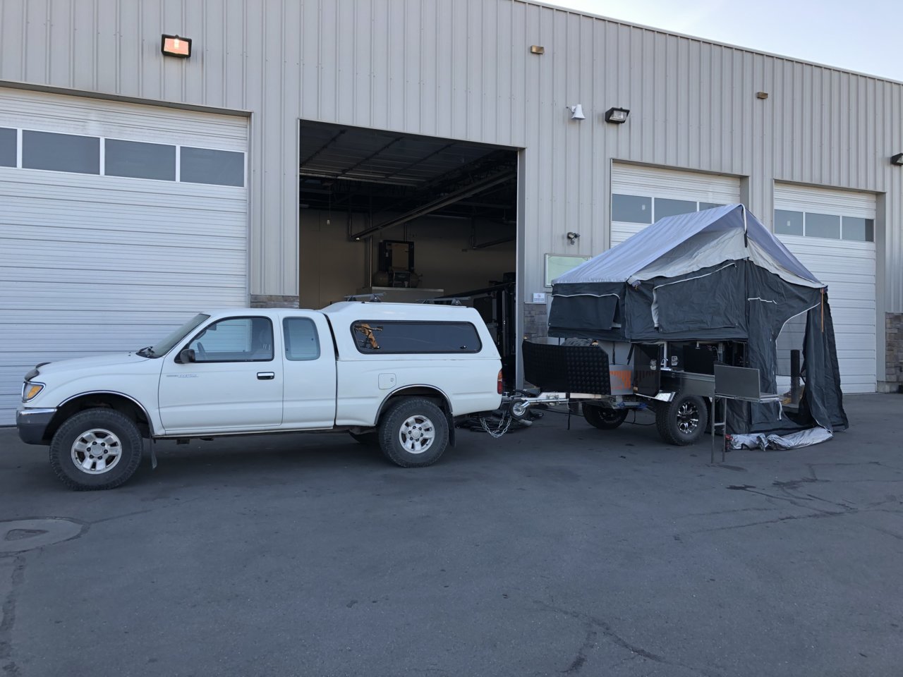

    Hello all, I am new to this forum! As I had finally talked my dad into selling me his first gen that kinda just sat and was driven maybe once a week! Only 174k miles and thing is a beast! I just replaced the rear bumper and hardwired a 7-way and installed a tow receiver because I just bought an off-road trailer. Next thing I want to do is put new shocks/ suspension on. My rear struts are shot... Any recommendations? I might just buy some rough country rear struts for the time being because they aren’t too pricey. Thoughts?

    I didn't know that about rim size 15" good catch! I see pic he has trailer don't know if it has brakes
