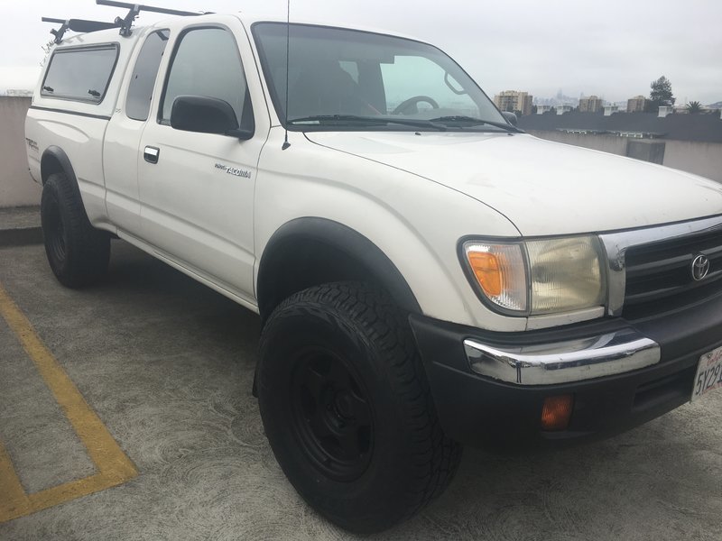

    not the best pic but 3"~ lift 31x10.50x15 KM2

    How do you like the setup? How much did it affect ur handling and power?

    I also stepped down from 33s so the 31s were a big improvement in power. I have a v6 but I think the 31s are just about perfect with the factory gears that I have because I have no problems cruising at 75-90 on the highway but mountain passes are a bit of a struggle. Overall I like how the truck handles. I have a stiffer suspension setup with poly bushings everywhere (including the steering rack) and it is incredibly responsive for a truck.

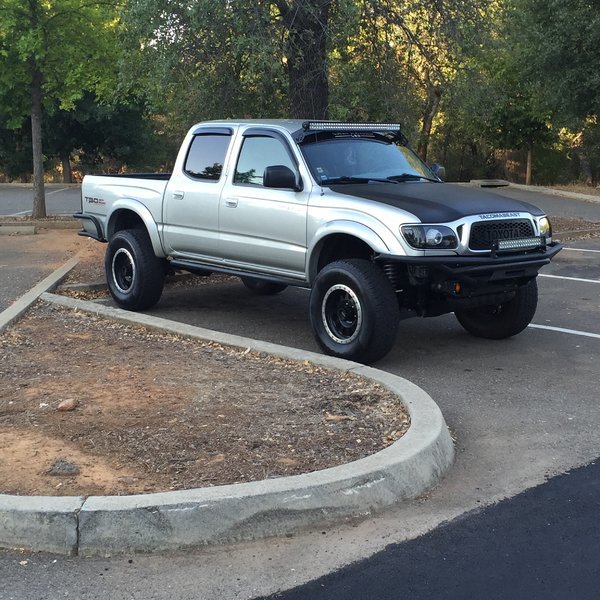

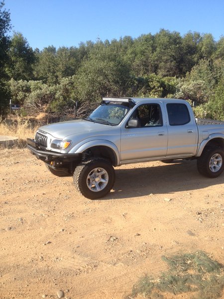

    Here was my Truck with 3" Eibach coils & adjustable 5100's and regular 5100's w/ a ToyTec 1.5" AAL. First picture is w/265/70/16's and the 2nd picture is w/ 265/75/16's. I have an Icon set up front & rear now. But for the price, you can't beat the Bilstein combo. I forgot to mention I've had Camburg UCA's throughout the Bilstein lift & my new Icon lift.

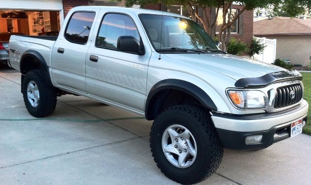

    Here's my old flame with an OME 2.5" lift. Top is 265/70, bottom is just a little bigger with 265/75s

    That looks nice. Im guessing theres no rubbing cause mine rubs a bit even with the pinch weld mod

    I did at the time. The Eibach coils were a little stiff of a ride though! My new Icon set up is a night & day difference. I have Icon 2.5 ext trvl coil overs in the front and Icon 2.0 smooth body rear shocks. Same AAL in the rear though.

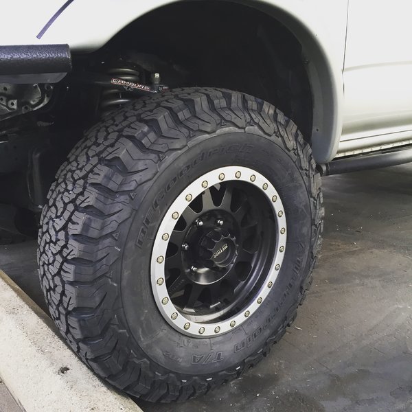

    What about the tires?

    Yeah I'm fine with the tires. These are the ones I have now. 265/75/16 BFG KO2's.

    No issues at all, it was a great setup with the 265/75s.

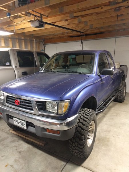

    265/75/16 cooper at/3s
    SCS F5s
    No lift at the moment - slight rubbing on the mud flaps, will be removing them)

    How much is the lift and do u have a side shot? But that looks good
