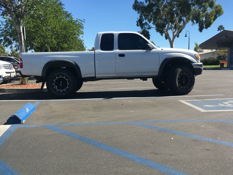

    So I'm running a 2.5 inch lift on 266/75R16 got the 4banger Just like you and I think it looks perfect the tires arnt so big that it makes the truck look small and the 32's still lift the truck an extra inch so all together I gained a 4inch lift
    Hard to get a nice picture

    That looks pretty nice how is the power and handling?

    I'm not sure how to explain how I feel about it...
    Power isn't bad, I mean I feel like I have a turbo some times ... Lol cause my truck won't move when going up a hill till it down shifts to 3500 Rpms and I'm goin from 55-70 up a hill real fast so I guess the power is fine but there's just no pull at all at a red light I have to hit it hard somtimes but all and all I've realized that I'm still getting good mpg and the power loss to me I suppose isn't enough for me to break down and buy a 3.4L just yet but I can for sure tell the truck needs a little more on the bottom end just to help it out

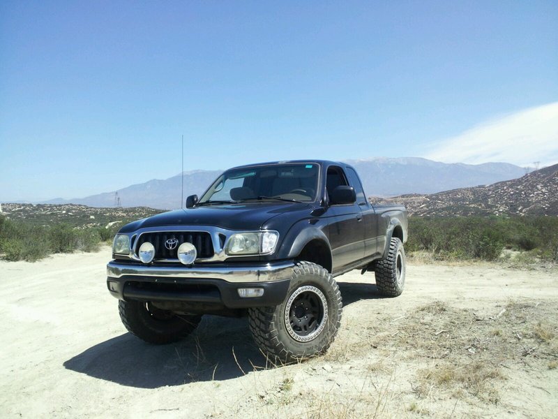

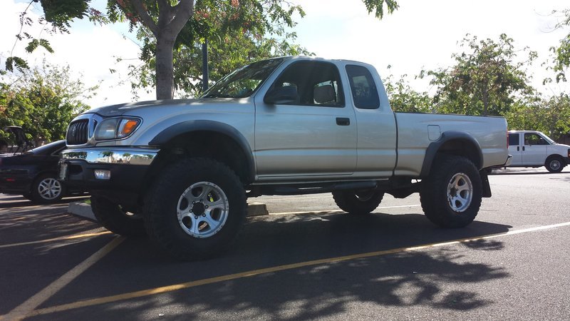

    My old 01 4cyl 4x4 had 285/75/16s with a 3in spacer in the front and a 2in block in the rear and it was kinda slow to get going around town but it was good on soft sand. Handling wise it felt the same as having 265s.

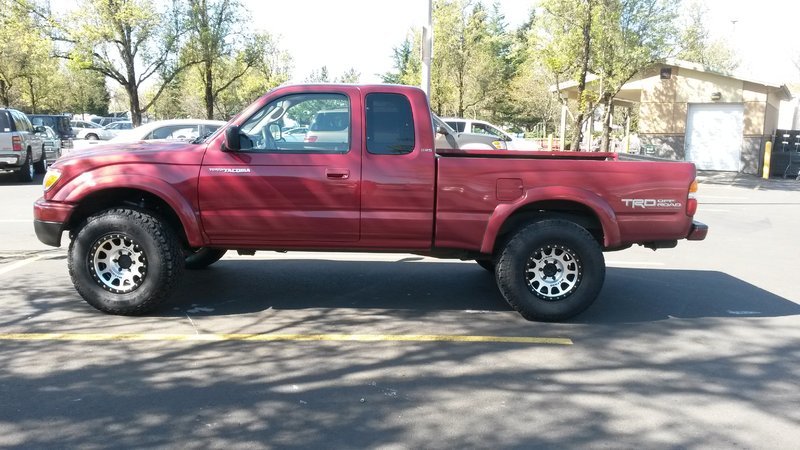

    Thanks! Here's a decent profile picture of it:
    and another stance shot:

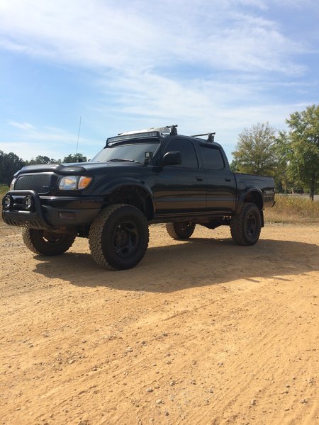

    Here's mine with 5100's all around with stock coils and leafs (cuz I'm poor!). I'm roll'n 265/75/16 Grabbers + Method NV 16x8 wheels. Slight decrease in initial exceleration and MPG's because the tires are super heavy, handles well on the road though with plenty if zip. Mild pinch weld mod and Camburg UCA. I'm very happy with this set-up as I don't wheel too often and the truck is deceptively tall (perfect IMO). Need to eventually replace my leafs and will be looking to up-grade the shocks at that time; either Fox or Kings. I do not plan on going up in tire/wheel size when I do. Hope this helps!

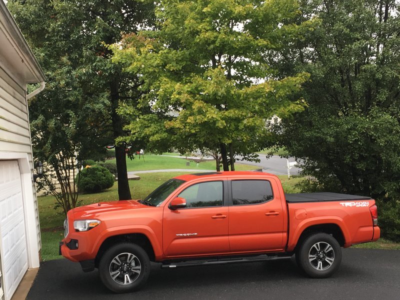

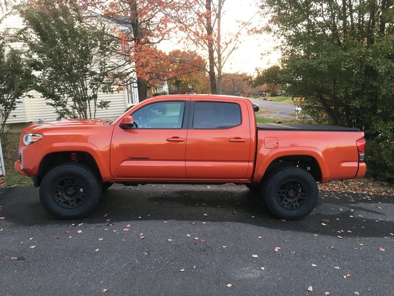

    Before
    And after
    I don't really notice a power difference. This thing is a dog unless I use the ETC button. I'm having trans fluid checked tomorrow. What I did notice is losing a little over 2 miles per gallon. I don't if some us because the speedometer is off.
