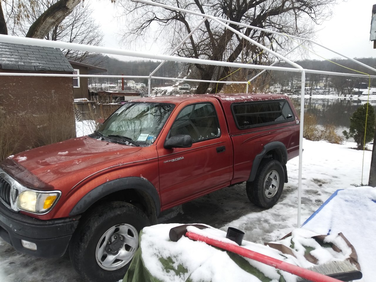

    1st Gen by far
    342,000 miles and counting on mine (3RZ)
    Original drivetrain
    Frame replaced at the dealership during recall
    1 clutch replacement during frame replacement
    Trans shifts like butter no pop outside grinds
    No burning oil, just a lower oil pan seep dont have to add between changes
    Its incredible I would choose to drive this truck over so many.
    Sitting on Falkwn wildpeak AT3s
    I do not mind the 2nd gens, the 2TR-FE is basically a 3rz with a different cylinder head so I'd prefer that over the 4.0 which in the early years had some head gasket problems .
    I recently drove a 2019 TRD Sport tacoma 6 speed unfortanetly to me it drove like a lifted camry, to refined for my liking. I prefer the driving feel of the 1st gen any day.
    Yeah doesn't look the best but 342000 miles says alot. Oh and even the A.C works

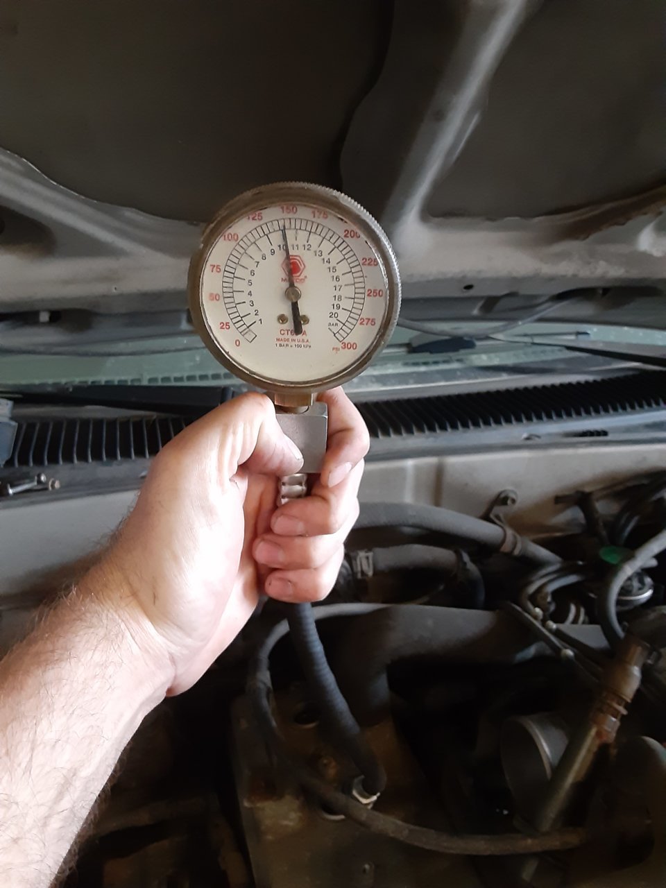

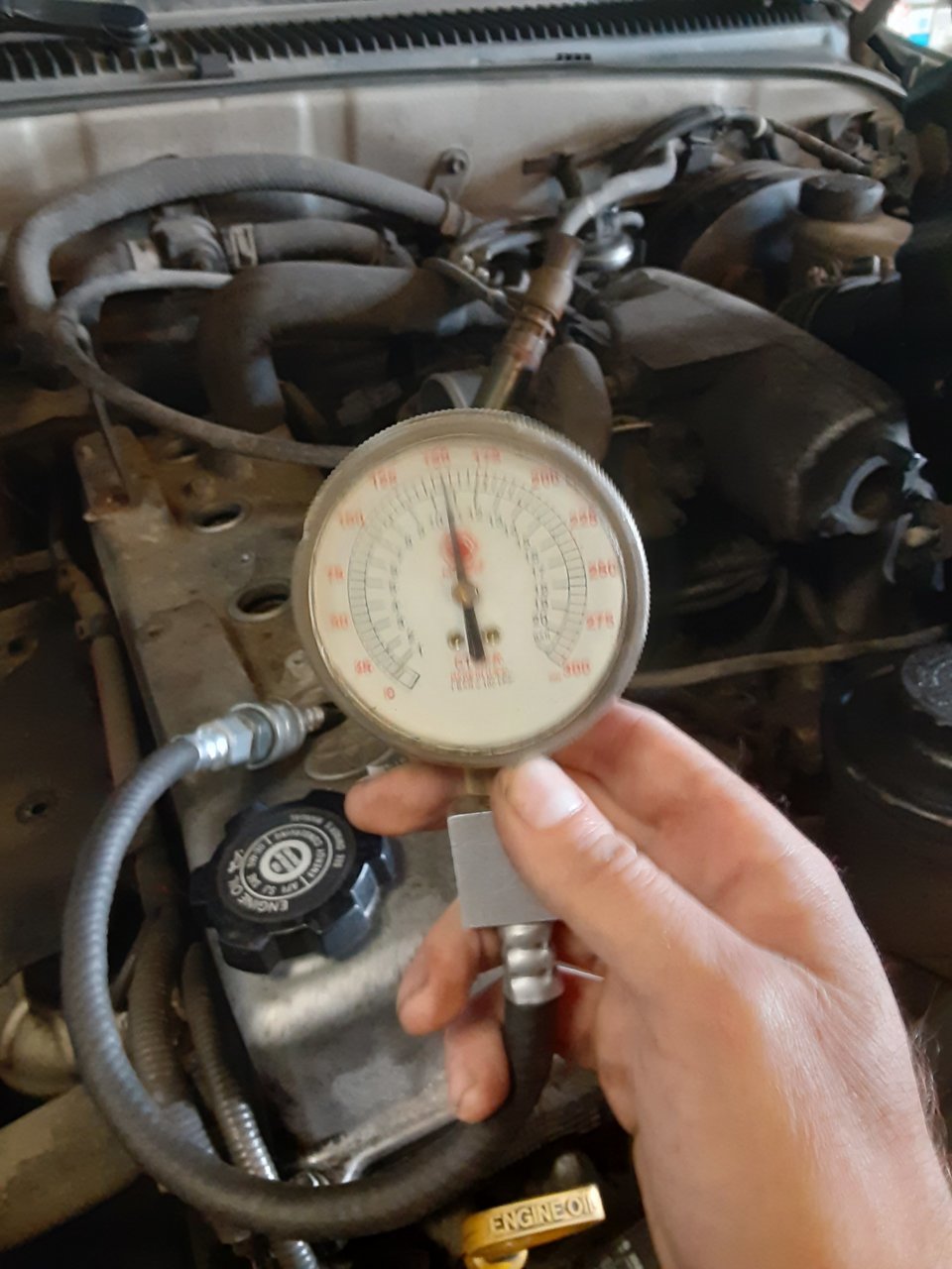

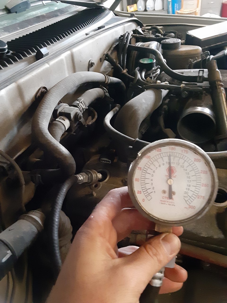

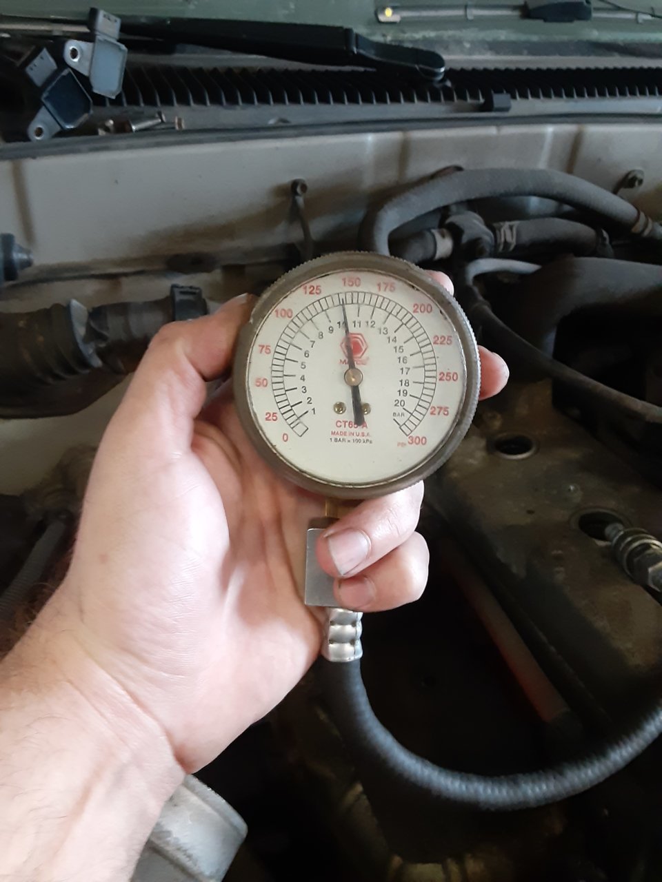

    Rained alot here and we had some big puddles on the road that I drove through next morning I was misfiring found cylinder 2 misfire n EGR flow codes. Clean the EGR(plastic one with vaccum lines) it had water in it, replaced a coil and spark plugs while I had the coil and plugs out I did a compression test.
    Here are the results at 342,800 miles
    1997TacomaSR5 and GQ7227 like this.
