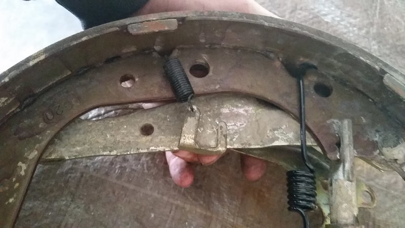

    5. Now you should be looking at this
    1. Shoe Hold-down anchor spring
    2. Anchor spring
    3. Parking brake cable
    4. Front shoe
    5. Rear shoe
    6. Return spring
    7. Adjuster
    8. E-ring
    9. C-washer
    10. Automatic adjusting lever and Adjusting lever spring
    11. Parking brake lever
    12. Parking brake bell crank
    13. Brake booster
    6. The other side is the mirror image so do one at a time so you can refer to it.

    @OP... I see that you removed the hold-down springs and washers first, then slipped the entire assembly down and twisted it out, then removed the return spring.
    Wish I'da thunka that. :(
    First I removed the hold-down springs. Then I spend another 20 minutes or so removing the return spring. What a bitch! I used all of my strength, and a few curse words, to get it off. Then the rest of the disassembly was pretty easy.
    I reinstalled the assembly in reverse order with the return spring near the end and the hold-down springs and washers last. Another 20 to 30 minutes using a variety of tools trying to get the return spring back in place while keeping all the parts in place, or nearly in place, until the contraption finally snapped together.

    Skeezix, next time use a medium/large vice grips, clamp on a straight section of the return spring & stretch the hook end of the over to its hole, much easier, takes considerable strength tho.
