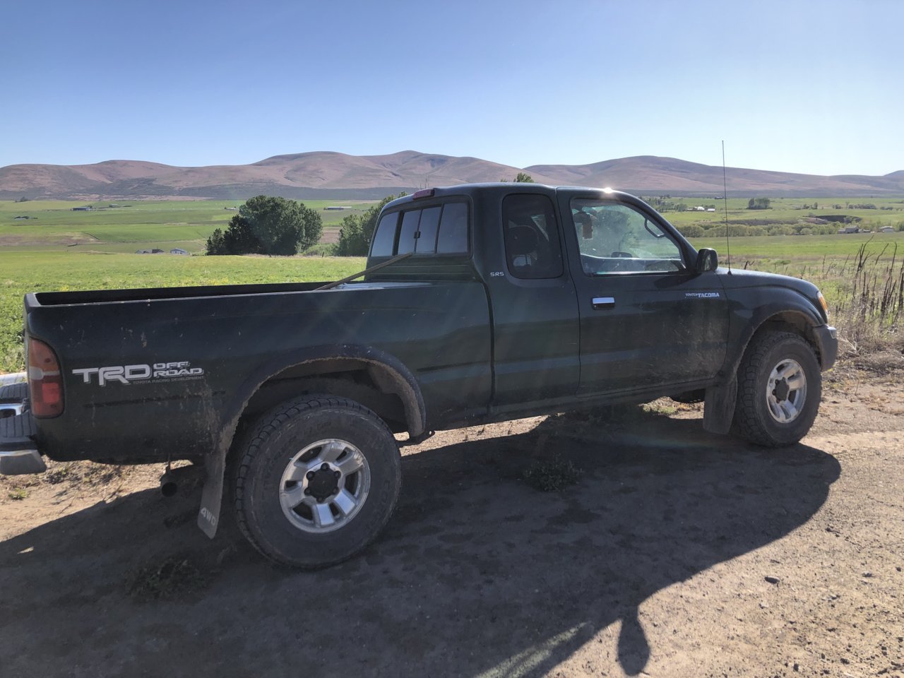

    First gen I’ve had for three years now. Ended up making it my daily driver. Completely stock, but bringing it into the garage for a few long overdue upgrades this week. This is yesterday on the farm, can’t wait to get started on some things I’ve always wanted to do to this truck. I’ve beat the hell out of it going hunting, camping, and at work. Will post more photos later this week after the work is done if anyone cares to follow.

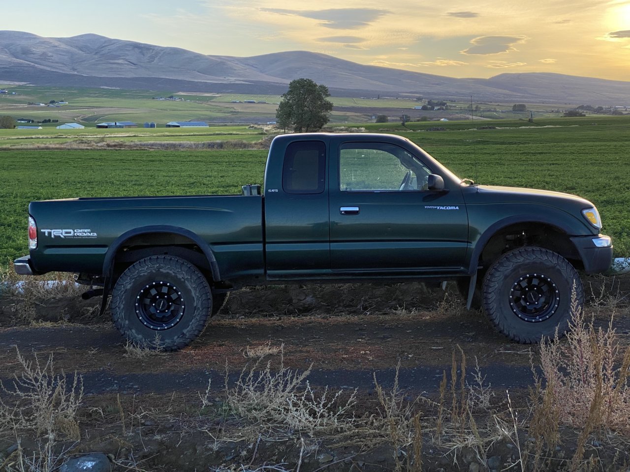

    New wheels, BFG tires, shocks and struts, and head and tail lights on. Struts were giving me a hard time. Had some wiring issues with the headlights to get the halos to work around the bulbs, they didn't want to turn on when spliced into the parking light. Ended up just leaving it with the main beams only being able to turn on for now.

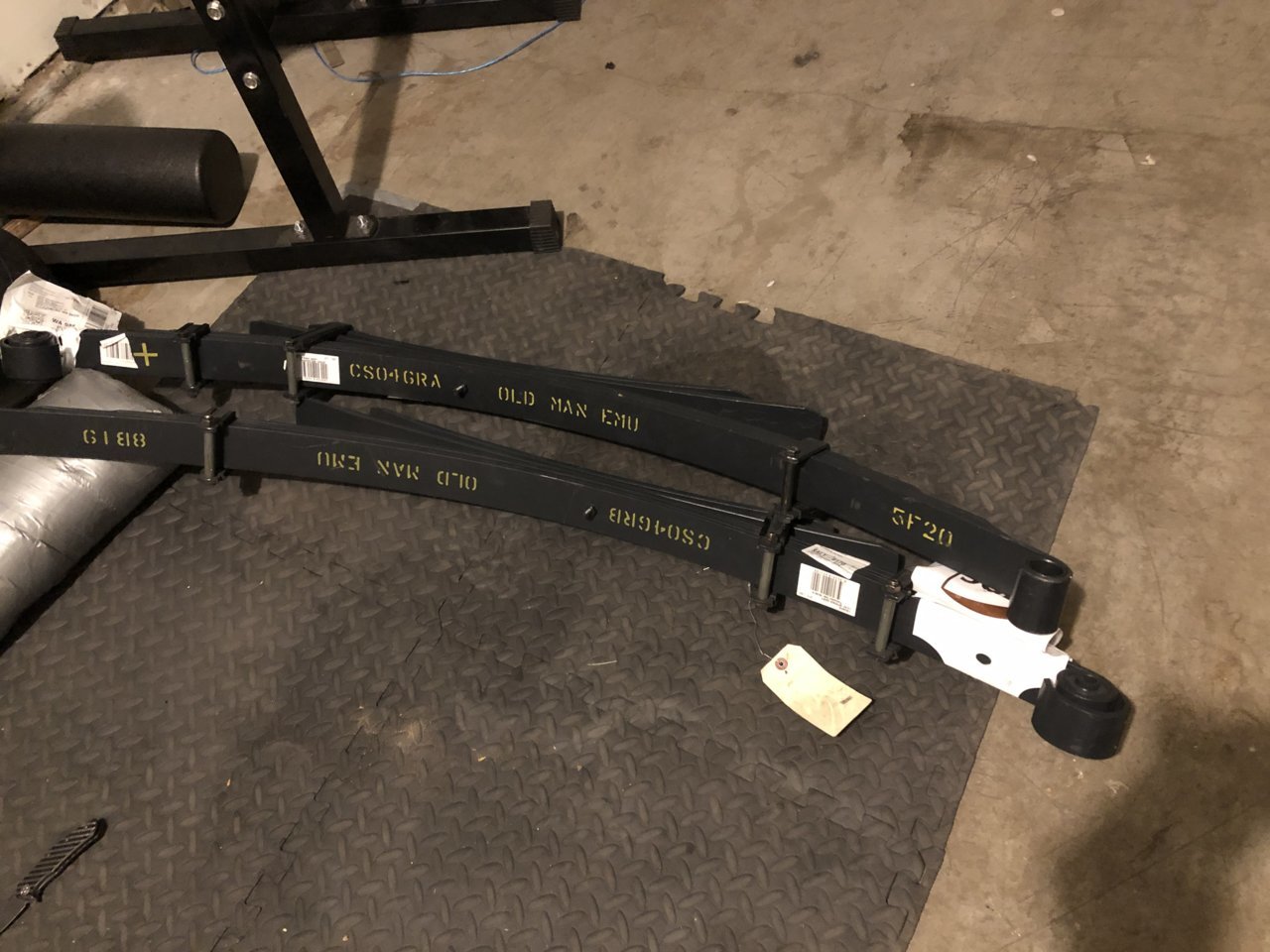

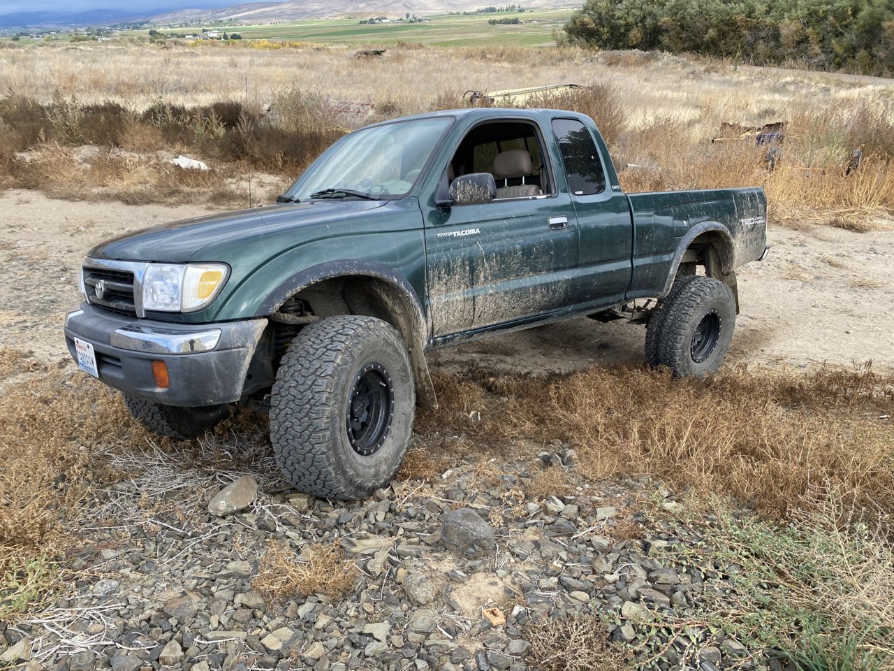

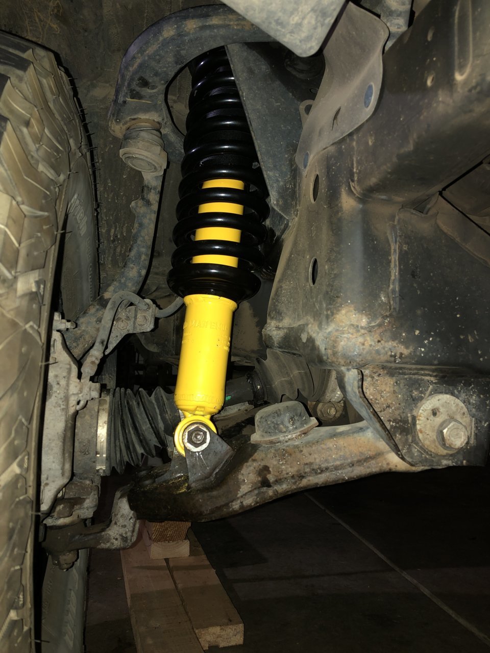

    I know it’s been a while since I showed progress on the truck but I’ve done a lot of work since last being on here. All new suspension, new CV axle adjusted my valves and made my own IFS skid plate as a little project to see how it would turn out. Photos to follow....
  19. Oct 19, 2020 at 9:22 AM
    #19
    Jack_w00
    Jack_w00 [OP] Member
    Nov 20, 2019
    #311239
    23
    1999 Toyota Tacoma 4x4 SR5
    Here is how the truck sits after a month of driving on the new kit. OME nitros, 882s, and Dakar leaf springs 67571FFB-9119-4E18-A7DA-C2F5881D6CE3.jpg 3F8A1110-2CCB-46FA-9FBB-A9F09AAB171F.jpg 43CFDFCF-FE2A-4BFF-8D20-1E84087D9C1F.jpg

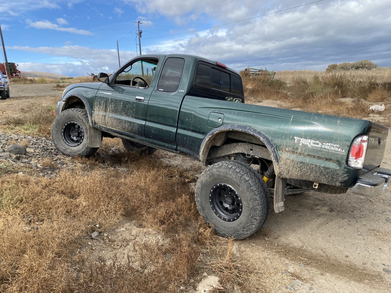

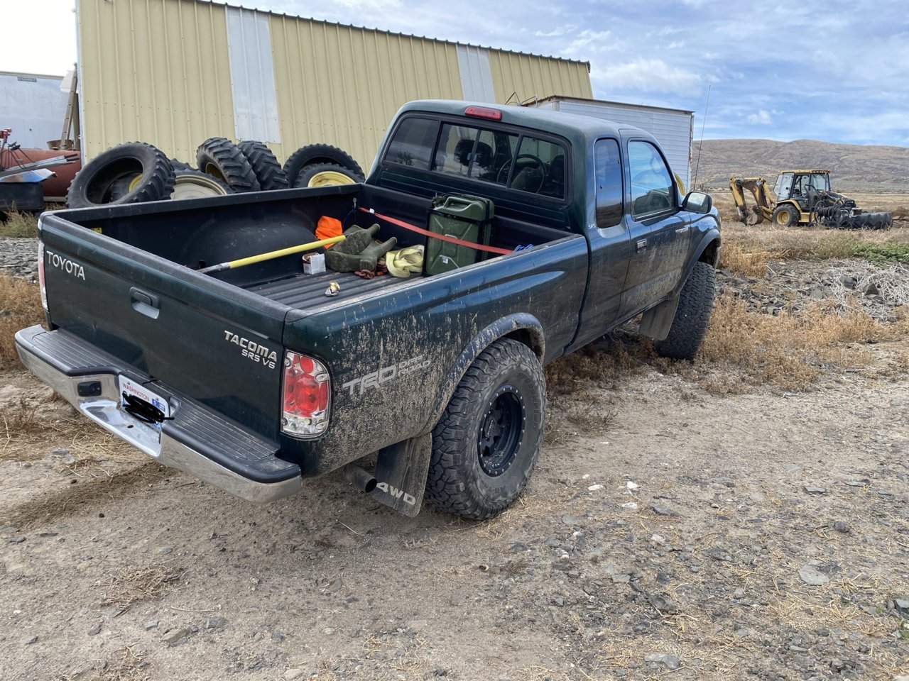

  20. Oct 19, 2020 at 9:27 AM
    #20
    Jack_w00
    Nov 20, 2019
    #311239
    23
    Just enough “flex”, right?:cool:D3AD4193-3208-45CF-A045-A37480DB33E9.jpg 408088EC-0EB8-4FD8-8184-ACD8A0CE29D5.jpg 27ABEA02-0ACF-49D7-A0DC-35B2D6455854.jpg
