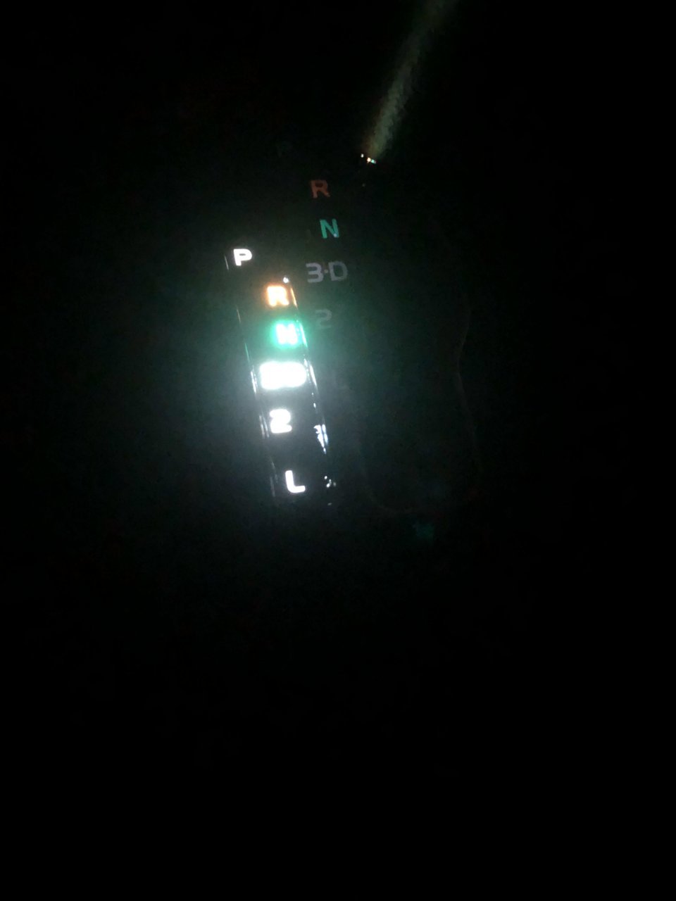

    eBay pack of 10 is like 6$. Just ordered a bag. Stupid bright. Put one in the shifter on my second gen

    Whoa. Thats friggin pretty bright!
