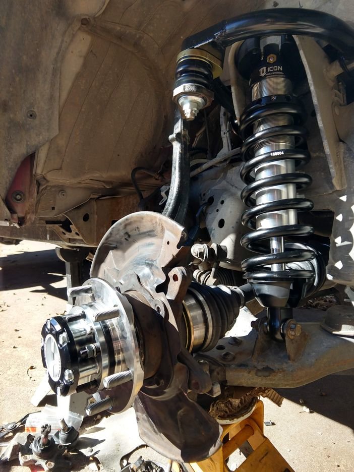

  9. Apr 8, 2021 at 4:37 PM
    Boozie2015
    Boozie2015 Well-Known Member
    Jan 3, 2015
    #145549
    89
    Vancouver WA
    03 Tacoma
