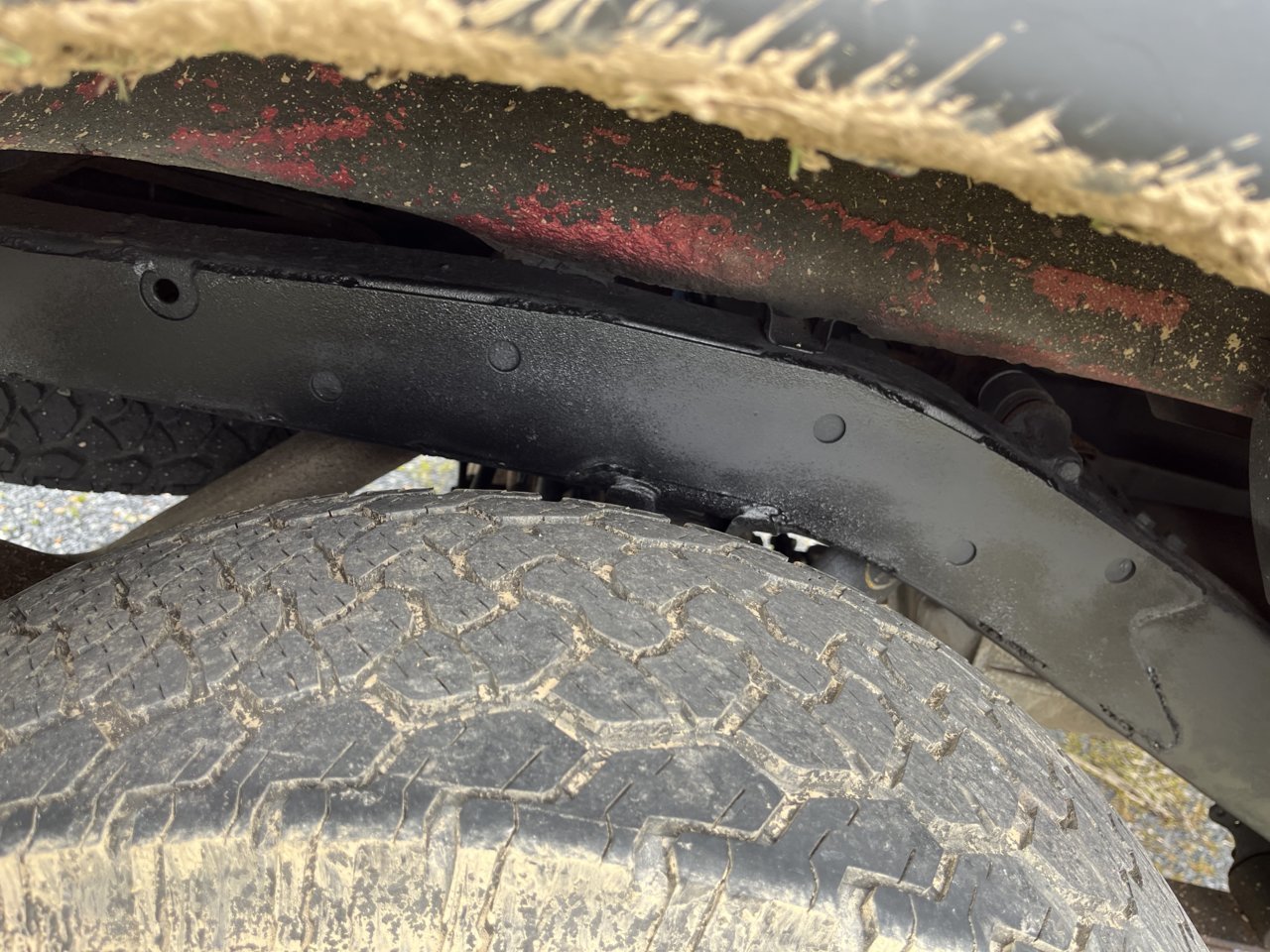

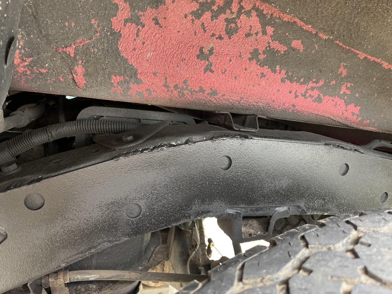

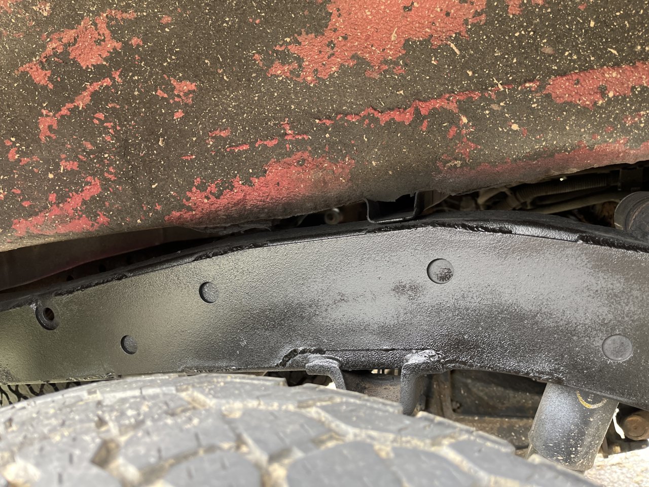

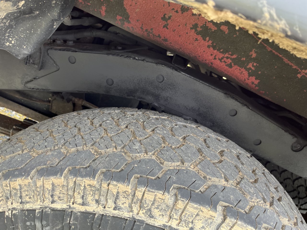

    Well final product, bed still has to come off for that crossmember however I don’t think these turned out terrible 165453B7-3111-48C4-82AF-8016EDF3BEEB.jpg12DF734A-E2DA-4E6D-96EB-7EE23557F5A1.jpgimage.jpgimage.jpg

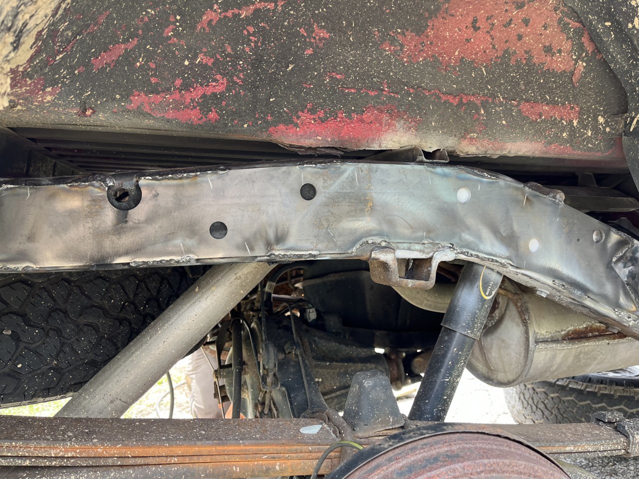

    Well final product, bed still has to come off for that crossmember however I don’t think these turned out terrible 0E625282-F79F-415A-9989-8DF2F4123D72.jpg0E625282-F79F-415A-9989-8DF2F4123D72.jpg 50DFFC44-3E8B-4BC6-B53B-3EDB5839AB91.jpg

    Plates are designed to be fully welded from end to end, including the hole cutout. It will rust faster if regular water or water from treated roadway (salted road) get in-between the frame and plates. Because the water will linger and not dry.

    The reason I “stich” welded them was because a frame is designed to have a certain amount of flex as it is and with cutting out all the other rust and welding in steel I didn’t even really need the plates when it was all said and done, also I primed in between and undercoated, I’ll be happy if I can get 3 more years out of this truck!
