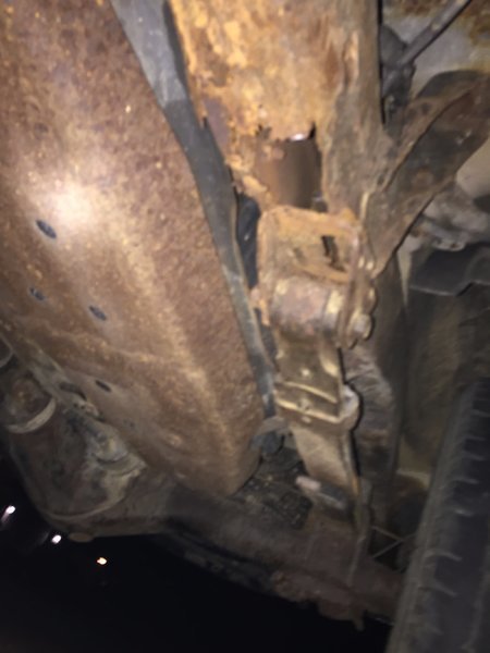

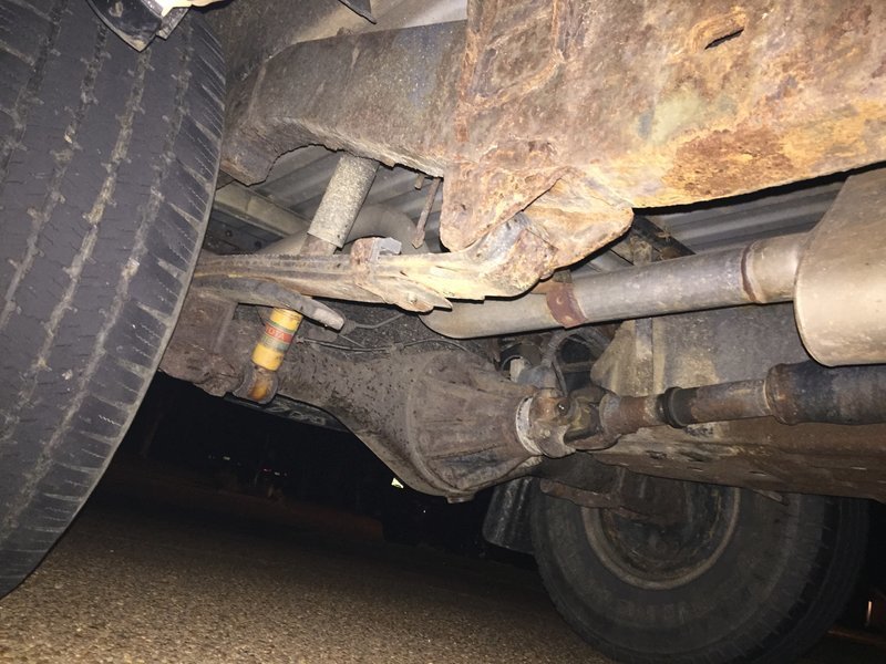

    So back in 2015 I received my 1999 from my brother as he had recently bought a 2004 double cab. I live in Memphis, Tennessee, but this truck had been in Connecticut for 16 years, but he never realized that it had so major frame problems (hell my father and I didn't notice until late last year). These are pictures of the frame rust which was worst at the leaf spring brackets.
    This was so bad that insurance stated that it was too unsafe to drive and risked collapsing. It also produced an exaggerated taco lean (ya know that thing with the coil springs but way worse). So my dad and I searched and found a company out of Rhode Island that specializes in this kind of stuff. Autorust is the company and the product is called Safe-T-Cap

    The product is basically a bottom half section of frame that can be welded to the top half of the existing frame if there is 1 inch of good metal. I know some people do this themselves, but this was a good option for me because the product was only about $150 per side and it prevented me from having to replace the entire frame which would not have been worth it. I also do not weld so I took it somewhere and had it painted/welded.

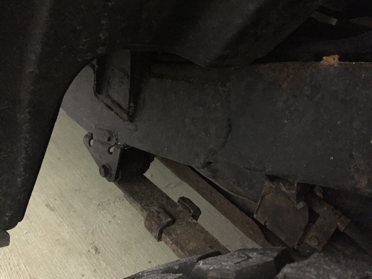

    This is after
    They make sections for other common places that rust out. This product really helped me and its been about a year now. The guy did all the labor for about $1200 which was way cheaper than the 5k it would've cost for a frame. I noticed my steering wheel wasn't turned when going straight anymore (yes the frame rust ate into the frame so bad and caused it to sag so much that it affected steering. Literally crab walking.
    So long story short, this product pretty much saved my truck and I was able so safely install a 2.5" lift I had been wanting.
