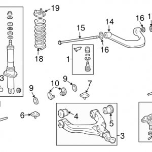

    From what I understand what I ordered from the dealer included the coil spring isolators. I will update that this week when the parts come in!

    What I believe I ordered from the dealer is #19 on the diagram. The other parts I ordered are the washers and bushings that can be seen on top of the shock, #3 on the diagram.
