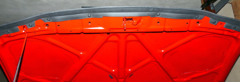

    I'm looking for long rubber piece between the hood and grill for my 03 DC. Does anyone know what the part is actually called? I keep turning up multiple part numbers in my google searches and I dont know which is the piece I'm actually looking for thanks to crappy parts diagrams.

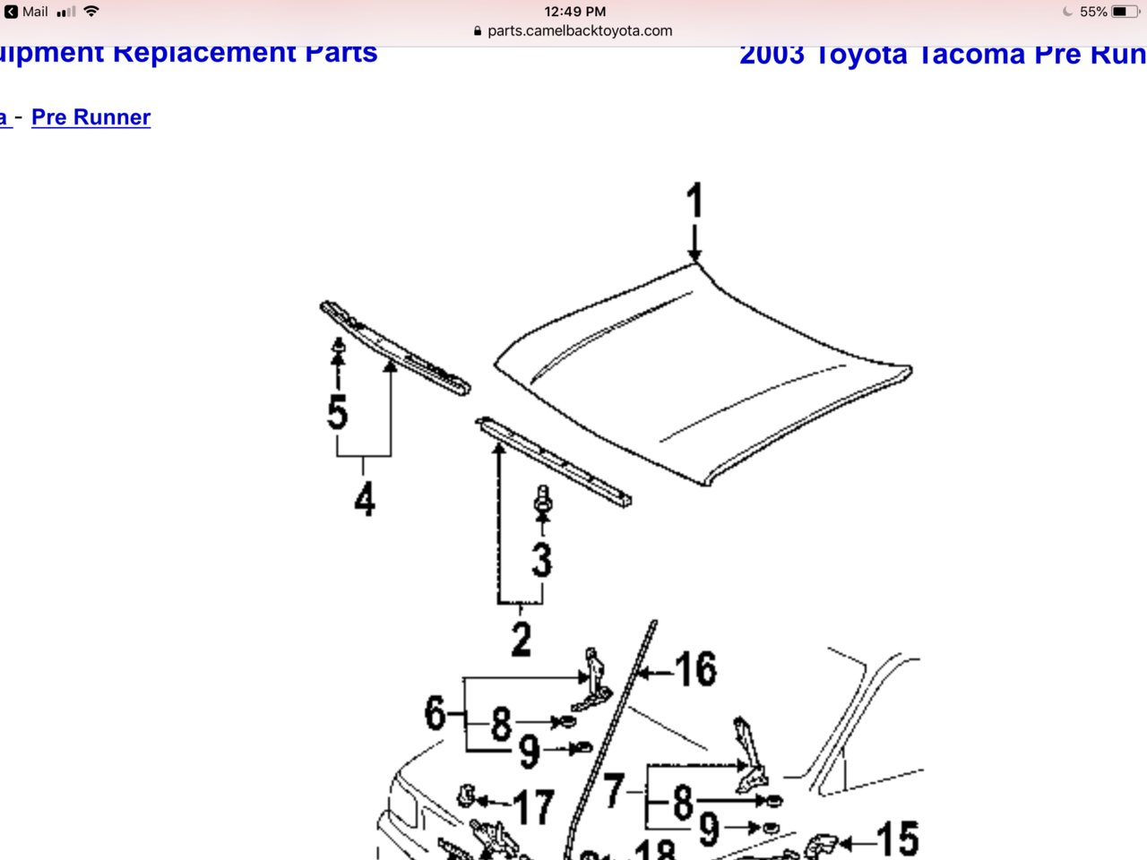

    I've see that one not sure if I need 2 or 4

    Does number 2 run the full width of the hood and fill the gap between the hood and grill when the hood is latched?

    Yes it does.

    According to that site (Camelback) it looks like the viewable rubber seal that runs the length of the hood, viewable from the outside front, is the outer seal listed as #4 or part 531830401. I called them for this info so hope they are right.

    Mine runs the full length of the hood, not two separate items for me

    If you do get this, may I make a suggestion. I sealed the entire length of it to the hood with marine glue. Eventually it will start peeling itself from the hood like the original otherwise. And dirt was getting in underneath the seal and spooging all over the underside of the hood with windage. Not anymore.

    Where are you seeing two items needed for that part? My understanding is that it goes the full width of the hood.

    the early Tacoma like mine 97 has one piece and the later Tacoma use two strips, one inner and one outer

    Gotcha. I am guessing this part is only good for 2001-2004.

    #4 or part 531830401 turned out to be the correct part for the seal that runs the length of the hood and is viewable from the front of the truck.

    Just mentioning, the oem one for 01-04 comes with clips also. I didn't know & bought all new clips when I replaced mine earlier this year. :facepalm:
