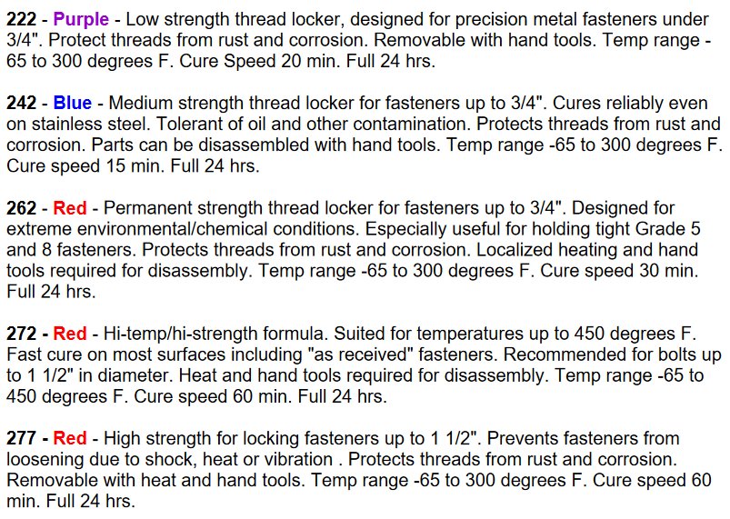

    Look at product code 277 “prevents loosening due to shock, heat, or vibration” it’s a suspension component so it experiences 2 out of 3 of those criteria

    Do not use red loctite on LBJ bolts. Use blue loctite on them

    Wait it’s a red tube...it might actually be blue threadlocker though. I’d have to check it’s been 2 years. But I don’t intend on taking those bolts out until I replace the ball joints again so if it’s red then oh well who cares. I’m not a fan of using those bolts for multiple fastening cycles since they’re what fails.

    I just looked and I have a red tube of 242 and a red bottle of 271...I think I did use the red 271 on those bolts cause I don’t intend to take them off. I also marked the heads with a paint pen so I can visually inspect them for loosening. Better safe than sorry was my logic I guess. Who knows, too many years and too many beers ago. Point is, definitely should use some kind of thread locker. The stock bolts had thread locker on them when I took them off.
