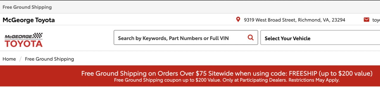

    '99 Prerunner SR5 Xtracab 4 cyl auto
    Looks like McGeorge is not a Participating Dealer. $303 shipped to Indy.

    Not sure what you mean - they give you free shipping on orders $75.00 and up, with the cap on free shipping being $200.00 saved. If the shipping is more than $200.00, you pay the difference.

    I don't know an easier way to say what I mean.

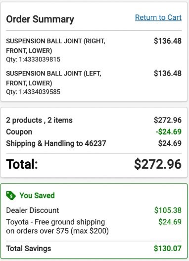

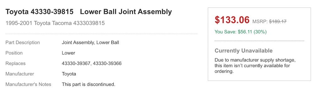

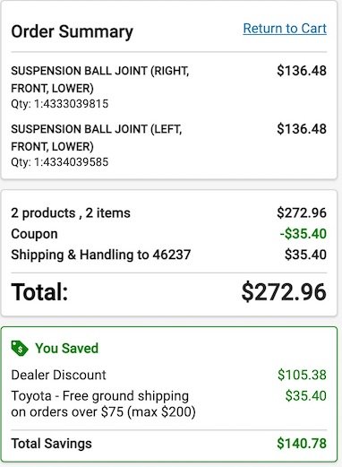

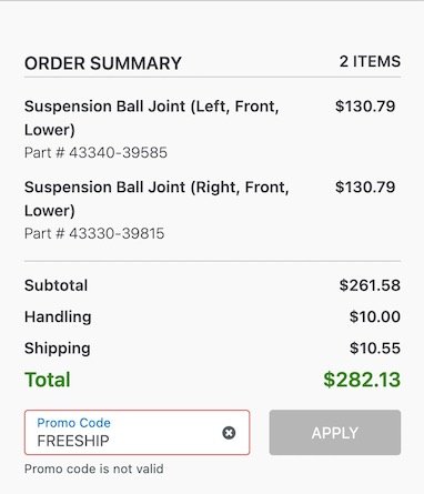

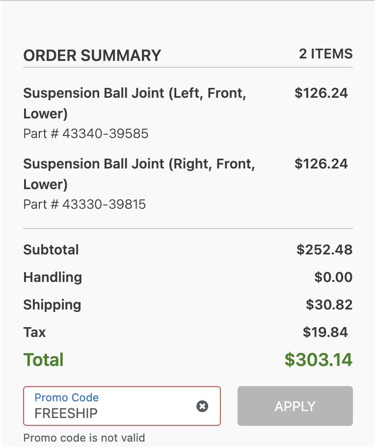

    Thanks for the leads, although with different p/n. I assume these are known "good deal" parts departments. I checked online with my closest dealer that wanted $208.09 per side. Subtotal of course is not enough info.
    I'd need more than simply the ball joints, and my truck is a '99 so - For ball joints, bolts, castle nuts, cotter pins (43330-39815, 43340-39585).
    With receipts:
    McGeorge (charges tax and shipping, but discounts "handling" :D) -
    Toyota Colorado Springs (charges shipping and handling) -
    Toyota Parts Deal (???) -
    Salinas Toyota accepts the coupon (no tax, no handling, no shipping) -
    Gettel Toyota, accepts the coupon (no tax, no handling, no shipping) -
    Considering that the last two are exactly the same price, it seems there is a standard discount price or a standard markup over cost that certain dealers use. Or it's just coincidence. I also found that not all dealers have an online portal for ordering parts yourself.
    Anyway, wasn't that a fun little journey of discovery? Hopefully my 171k mile LBJs hold out until my order arrives!
