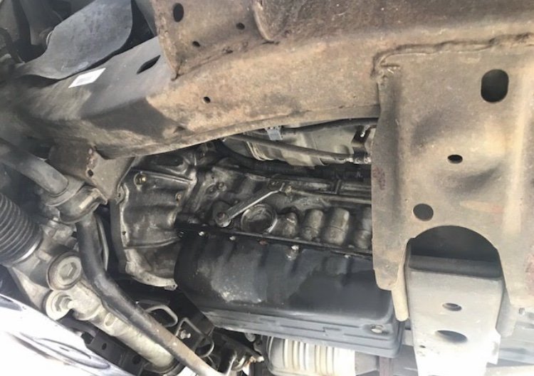

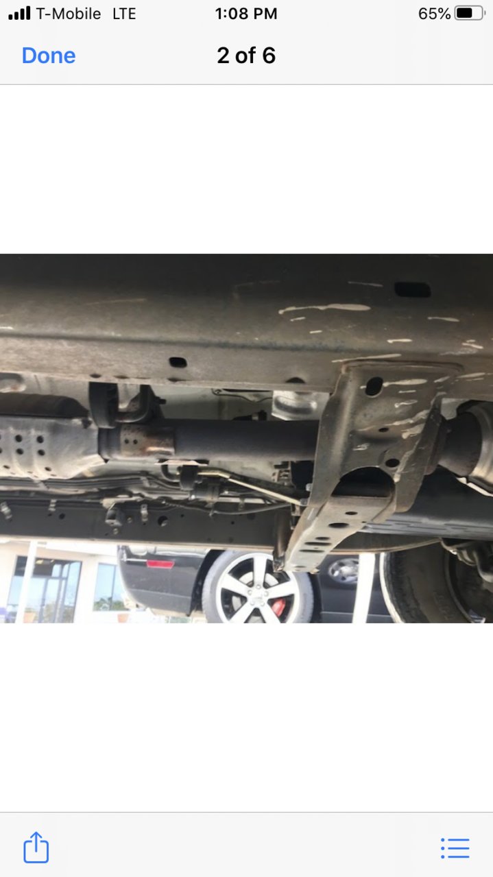

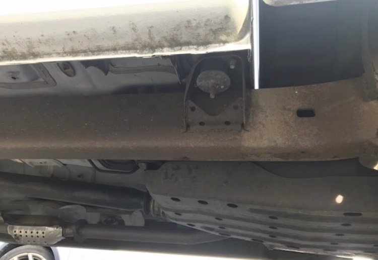

    That really just looks like surface rust. I'd ping around the frame with a hammer to be sure, but overall that looks like a good one. I'd just hit all that with a wire wheel and re-paint it.
    Being that you're in CA, you don't have to worry too much about doing the Fluid Film treatments and all that. I literally don't do anything to my frame.

    Central NC doesnt rust trucks out. That looks totally normal for around here, and Id say its fine.

    Take a close look where the rear shocks attach. My 2004 was 5 years old (in the salty northeast) and had a large hole in that area.
    The dealer wouldn't let me drive it home.
